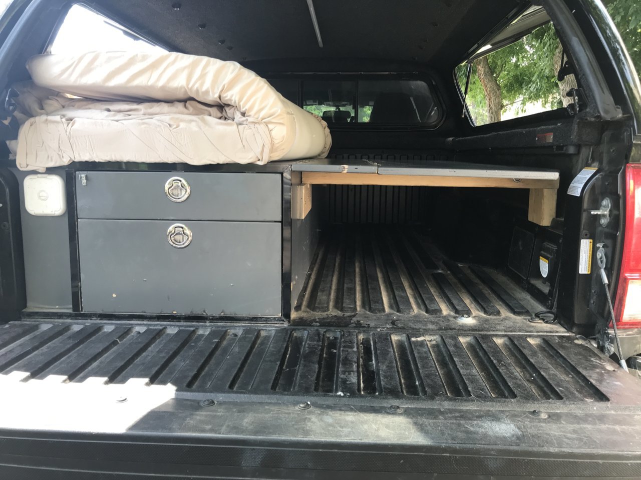

    A few people have messaged me about the drawer system I built so I figured it would be worthwhile to do a picture heavy build thread.
    My fiancé and I recently sold our Sportsmobile 4x4 Van and down sized to a Long Bed Tacoma. We ultimately wanted to take some of our favorite things about the van and put them in the back of a Tacoma.
    A lot of the inspiration for the drawer came from a company called Scout Overland Camping when I saw their telescoping drawer system for a 4runner.
    Our goals were as follows...
    • Try to only take up half the bed so we can still have some full height storage room with the topper on.
    • Ability to fold up or make bed quickly
    • Protect matress and sleeping area from all of our dirty, dusty, muddy, or snowy gear that we would be throwing in the back of the truck when leaving quickly in the morning for a ride.
    • Shower/water system to clean up after rides, hose down bikes and fill hydration packs
    • Storage for bike gear, camping gear, tools and cookware
    • Full length slides for maximum use of space
    • Stove w/ food prep area

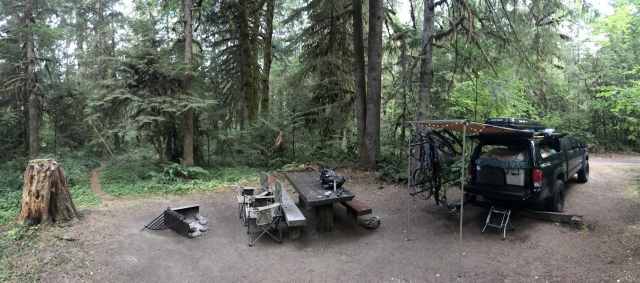

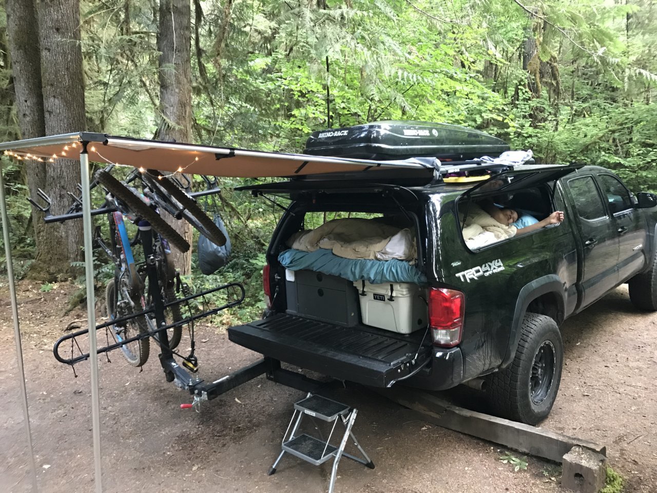

    UPDATE 8/15/18
    We've since had multiple adventures (easily over 50 nights) with this set up and a 3 week PNW Mtn Bike trip sleeping in the back and using the stove and shower almost every day. Its been solid so far.
    Changes:
    - Switched to a 3" mattress to make it easier to fold up with the bedding still made.
    - Replaced Slam Latches with metal latches after plastic ones broke.

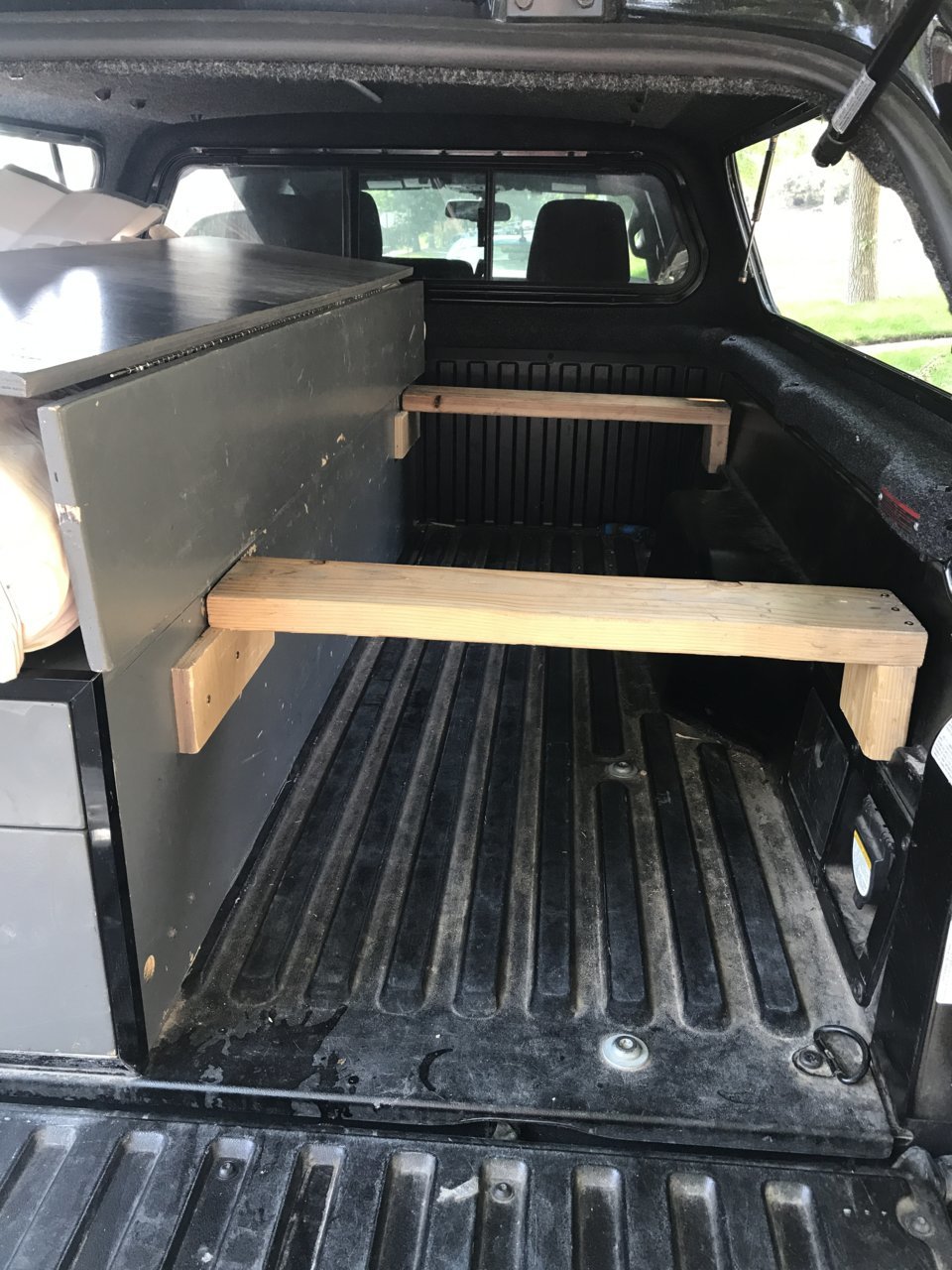

    What supports the passenger side of the platform?

    Nicely done! What bike rack ya got?

    My yeti roadie cooler and 2 buckets got me though the most recent camping trip. But I'll make the 2x6 supports this week. I'm planning to screw some 3/4" plywood onto the side of the cabinet that the 2x6 will rest on just below the platform and extend to the side of the bed where there will be a right angle that extends down to the cut outs on the bed.

    Kuat NV w/ a RakAttach swing out.

    How do you like the swing away for the Kuat? I've been debating something similar but worried about stability. Which model did you go with?
