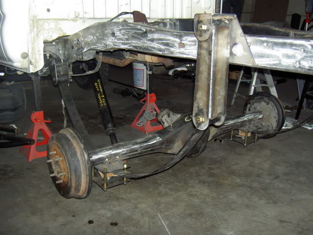

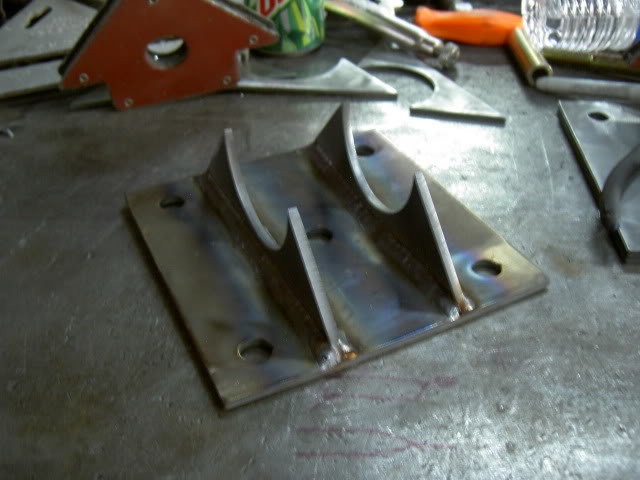

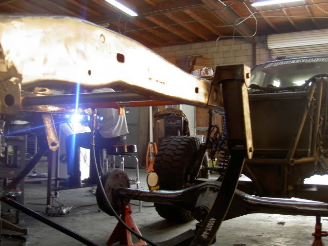

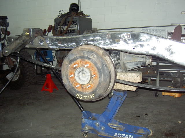

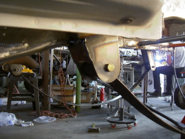

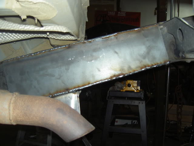

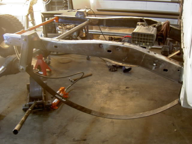

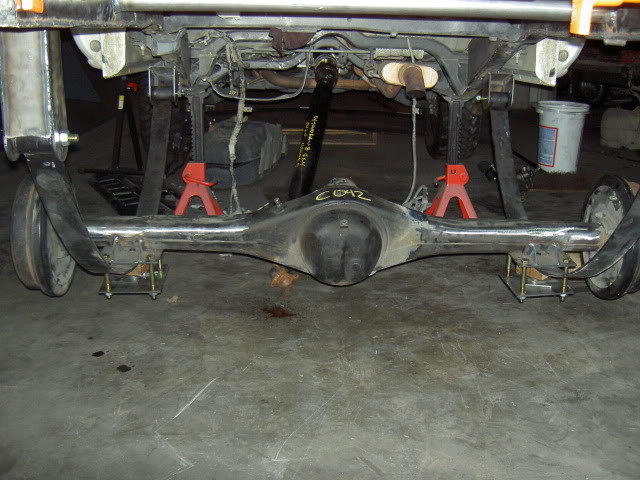

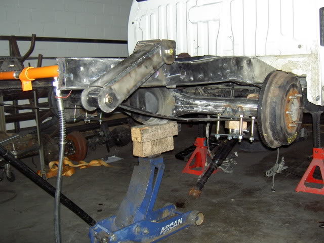

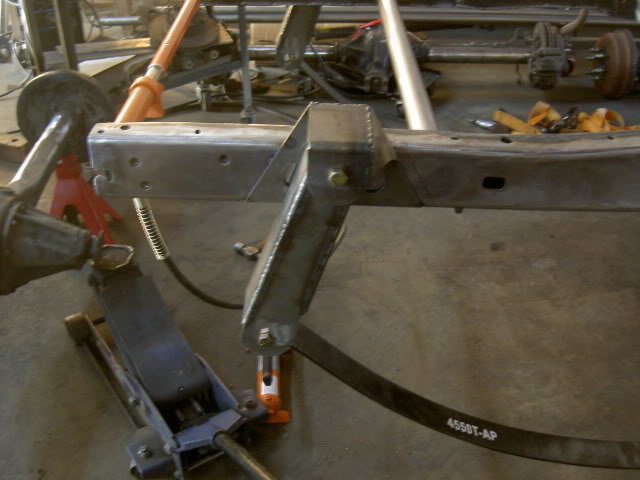

    today was successful. got the front and rear hangers tacked in, bushings and crush sleeved in the leaf pack and shackles. Mocked up the suspension and cycled it cleanly:D

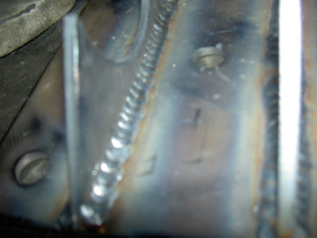

    Plated frame before and after front hanger

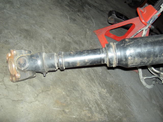

    got the drive shaft back from J.E. Reel, that fit b!tchin.

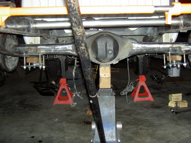

    set my pinion angle, and welded most of the u bolt eliminator kit from Engage (bye bye U bolts), enough to cycle the suspension, that was quite easy.
    Action shot:cool:
    tomorrow I work, so I will only get a couple hours to weld up the hangers, finish welding up the u bolt eliminator kit, put the leaf packs back together and maybe paint the shackles if I have time.
    bed cage should start on Monday, that should be fun/ interesting.

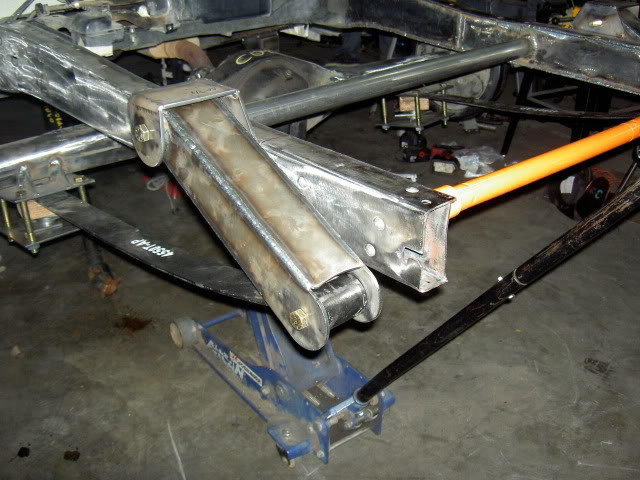

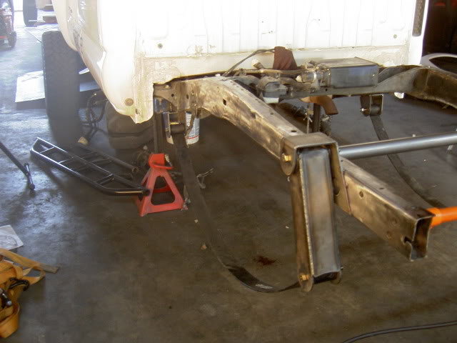

    The truck is on all 4s today. Tomorrow marks one week on the build, while going to school and work in between. The suspension portion of the build is done, just need to mount shock tabs, straps, and bump pads.
    Bed cage starts tomorrow.
    Sits level again.
