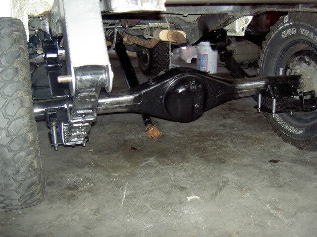

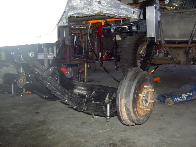

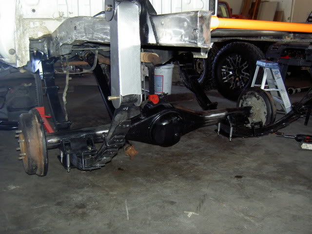

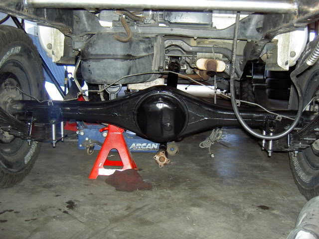

    If he is using the previous gen tundra axle, the track is 64.9", the stock tacoma rear track (for his model) is: 63.4"
    So switching to the tundra rear axle will give him a 1.5" increase in rear track.
    Im waiting for a good deal on the 07+ tundra rear axle. Those are 67.9", and when coupled with two spidertrax spacers which add a total of 3", the rear will end up being 70.9".
    The stock tacoma front end is 63" in track. Add 8" to that (or even 8.5") with the Engage front end and you'll have 71" of total front track.
    EDIT: Kit, what hubs are you using on the tundra rear? cuz, IIRC, the tundra rear is 5-lug. How are you swapping the hubs out?
    Also where did you get your rear axle and how much did you pay for it?

    Dude if you find a 07+ axle, please Dont use wheel spacers!! theres no point!
    My truck is 89" outside tire to outside tire.
    Tundra is not 5 lug, unless they changed this 07+, but i Highly doubt they would 5 lug a full size truck.
    So same 6 on 5.5 bolt pattern as my tacoma.
    Theres a place around the shop that I bought it from.
