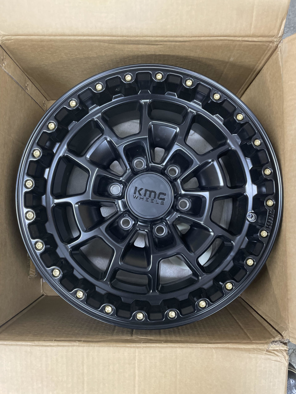

    I just purchased these wheels from tire rack. Was excited to put them on the truck, along with some 265/75/16 studded tires for the winter. However, when I took them to the shop they DID NOT FIT! I got them in the 16x8, 6x139.7, 106.1 Bore, 00 offset. I have a pretty normal 4wd 6 lug truck. Now that I scroll through this thread, I only see them on 3rd gens and I can only assume they don't fit on my gen 2. I never knew there was a difference in the hubs between the second and third gen. I confirmed several times with both tire rack and KMC and they both told me that I had the correct wheels and that they should fit the tacoma.
    I took the wheels to a second shop, since the first shop only told me they didn't fit over the hub because of the offset and basically pushed me out the door. I'm no expert, but that didn't make sense to me. If they don't fit over the hubs, that seems like a bore issue, not an offset one. 8" wide 0 offset wheels are not anything crazy for the Tacoma. The second shop was much better, still couldn't get them to fit but at least offered me a better explanation and helped me get to the bottom of the issue, instead of just writing me off as an idiot and saying I got the wrong wheels. On paper, these wheels should fit by all accounts. Turns out the center bore of the KM718 Summit and other KMC wheels is tapered (wider on the truck side, narrower on the outside . Seemingly they are a better fit for a hub that sits more flush with the lugs, not one that sticks out like mine.
    I'm disappointed that KMC and Tire Rack both list this as a fit for the Tacoma when it isn't. I really like the look of these wheels, and I'm picky so I haven't found much else out there that I like. They look pretty sweet on all your trucks! Hopefully they will replace these. Just wanted to put this out there for others considering these wheels for a 2nd Gen.

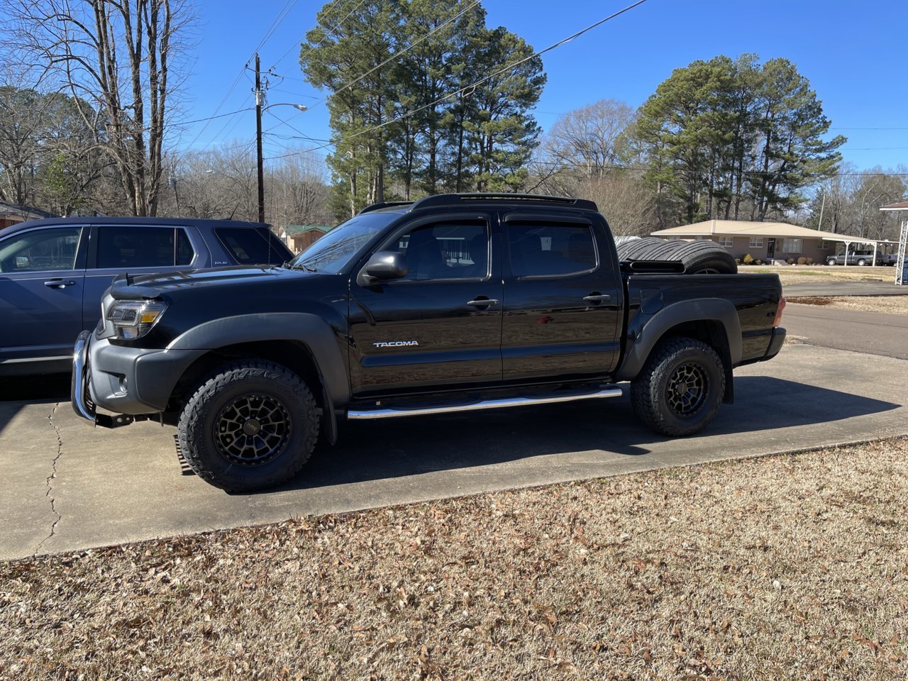

    Happy to say the rims worked just fine on my 2nd gen 2014 Tacoma. Not sure why they wouldn’t work for the other guys. And they look absolutely sick!!

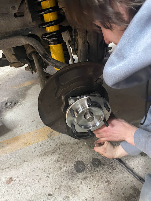

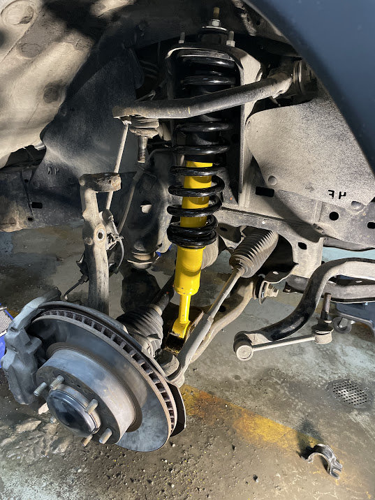

    I just had to replace my hubs, so I was able to get a photo of them. Since I just walked into the auto parts store and got tacoma hub assemblies and they were exactly the same as the old ones, I know there wasn't anything weird going on with them. Now I'm just curious why they did not fit on my truck and have fit on others.
    I don't know whether the wheel was blocked by the actual protruding part of the hub or the black cap that covers the axle bolt. Maybe the cap was what was interfering and some people have different caps?

    looks amazing. Is your truck stock height? I'm just trying to gauge how they would look on my stock height '13 with 265/70/16s
    Are yours 0 offset as well? thanks!

    Thanks! Truck is stock height and I got the 0 offset ones.
