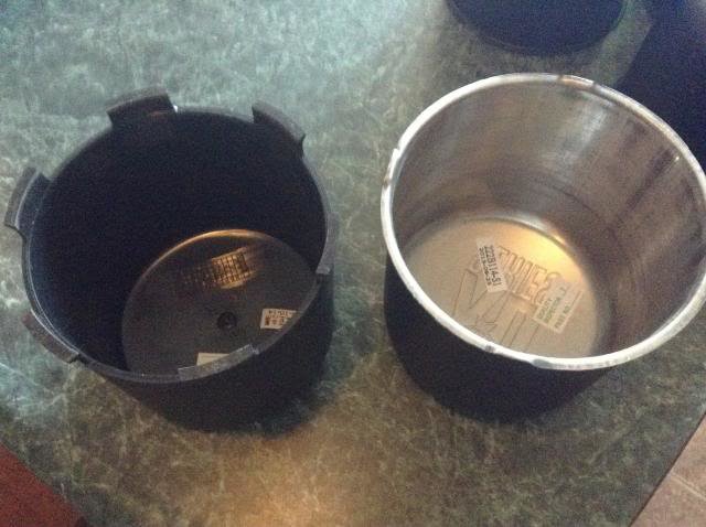

    Part # Toyota:WA222B114-S1
    Part # Chevy:WA1001357B

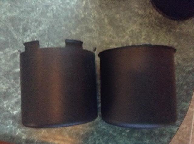

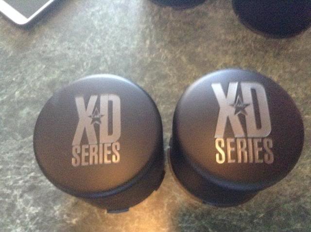

    Chevy has a smaller center bore and the caps are plastic,if you get plastic caps you've got the Chevy's, Toyota are stainless steel and painted, the parts numbers are inside the caps.
    the Toyotas are metal and fit in snug and flush with the center bore hole on the rims.
    here is the comparison pictures, the big tabbed cap is the Chevy.

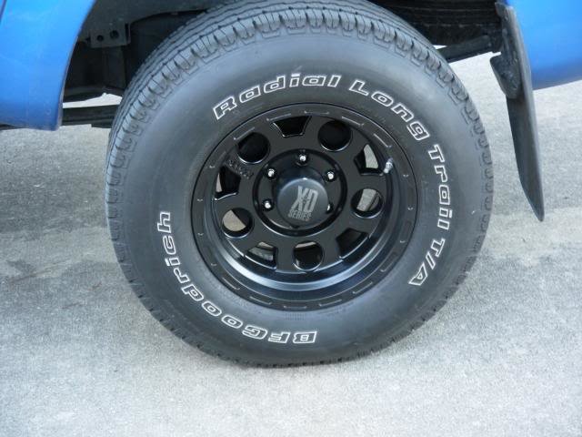

    picture installed.
