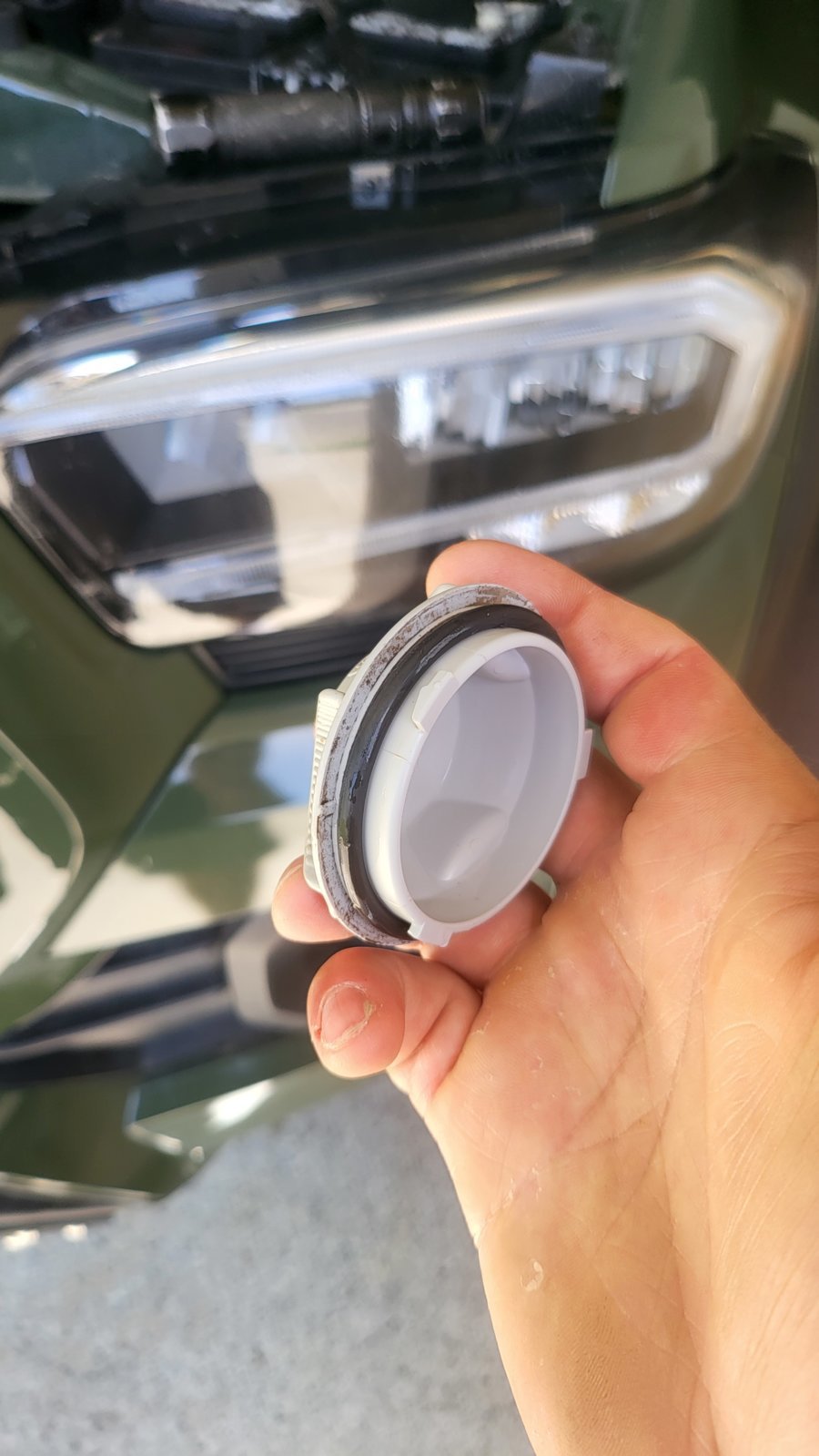

    Just curious, what is this knob underneath the headlight. I thought it was a drain or simply a cap so I can get rid of the moisture inside, but seems more like an adjuster than a cap.

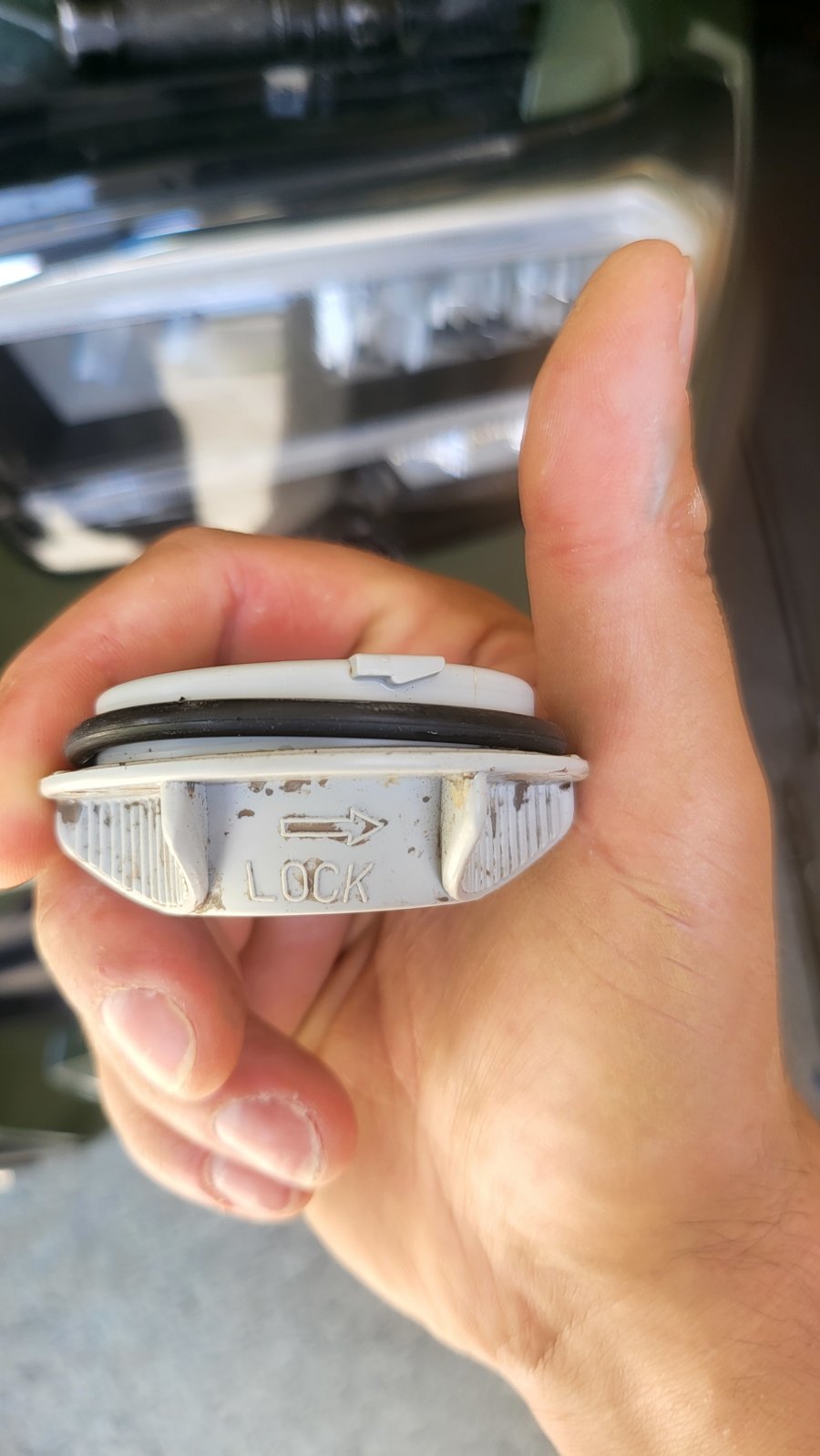

    And as soon as I created this post, i get a different grip on said uncertain cap, and it pops right off. Rubber ring keeps it nice and snug, so it wasn't screwing off as I expected it to. That said, water just dumped out as soon as I removed it, so it worked as intended. Now to figure out why water got in.

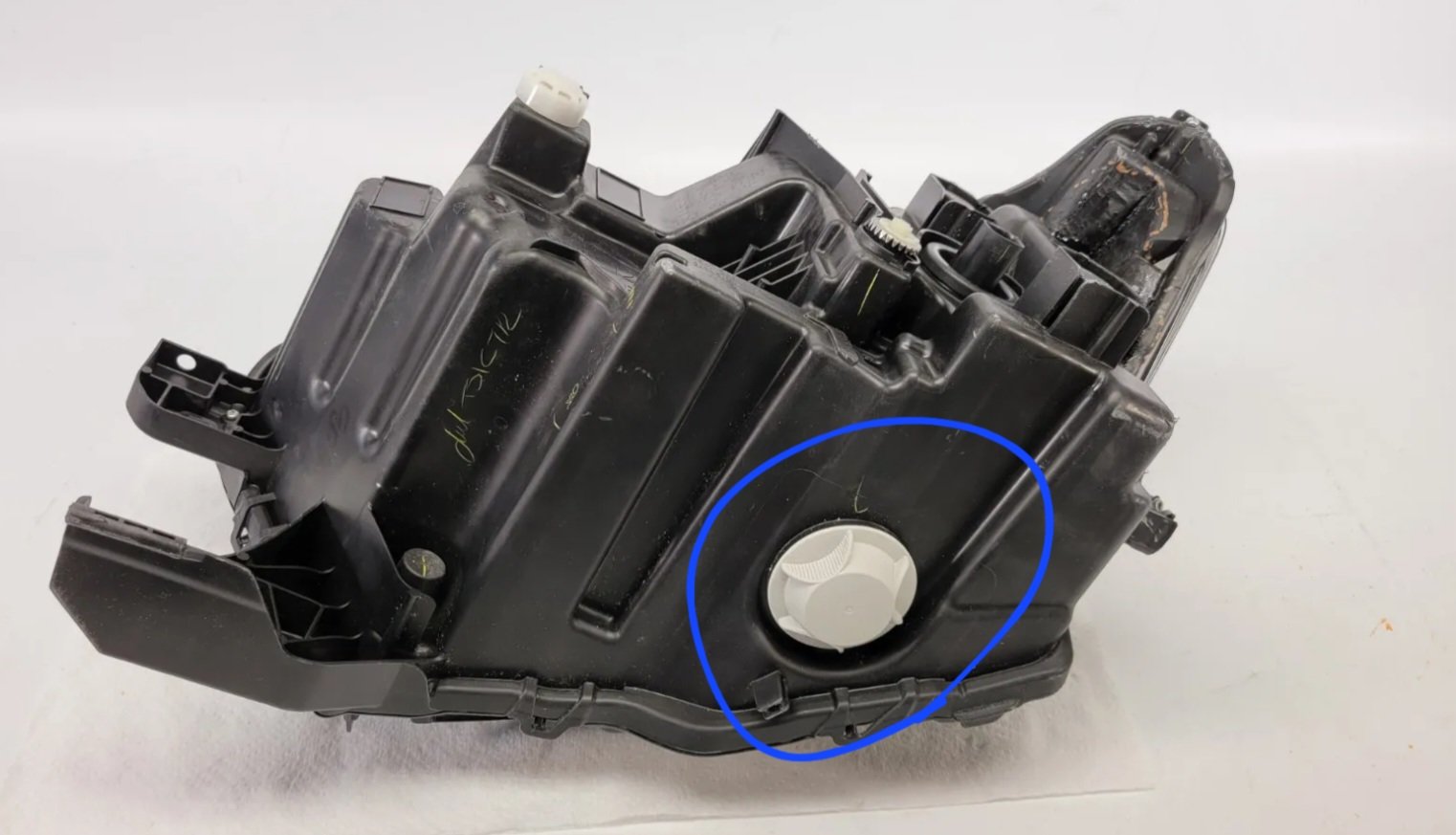

    Moisture can accumulate via ambient humidity. These lights are not air/vapor proof, hence the drain plug. Put the plug back in and carry on.
