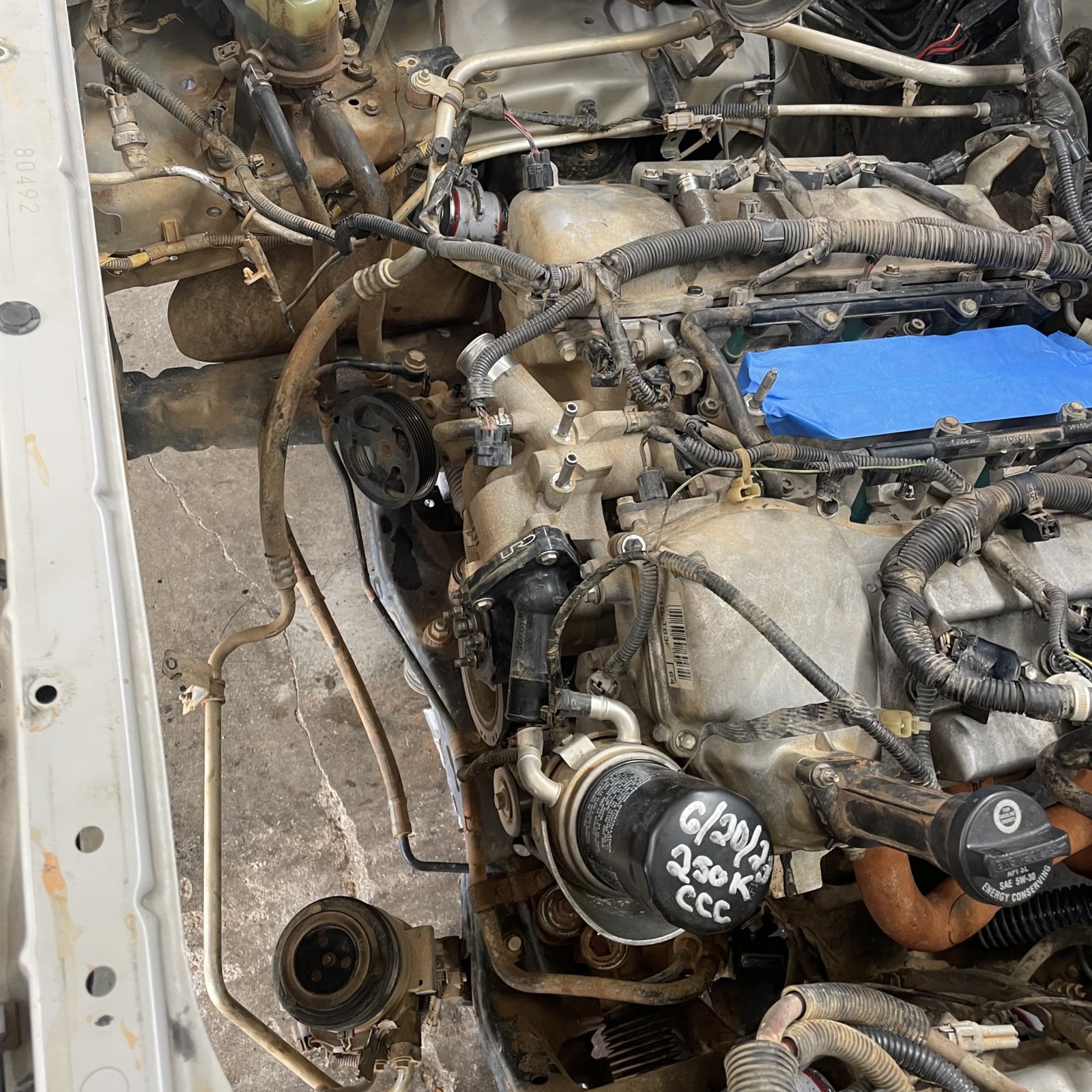

    I already replaced the head gaskets last year along with resurfacing the heads and a valve job. So hopefully that’s all in good shape still. Pic from August 2022

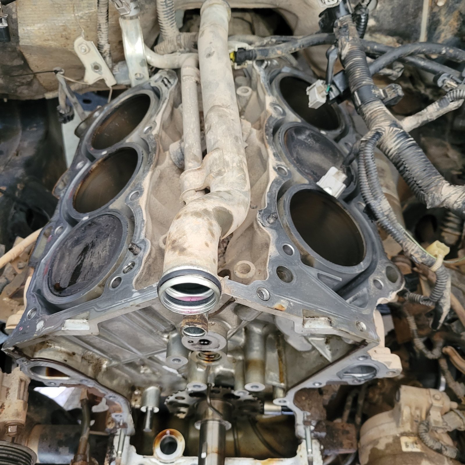

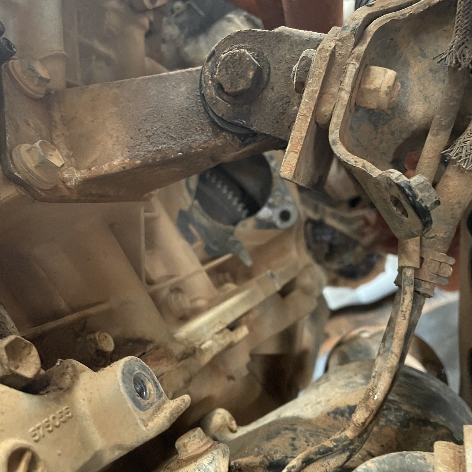

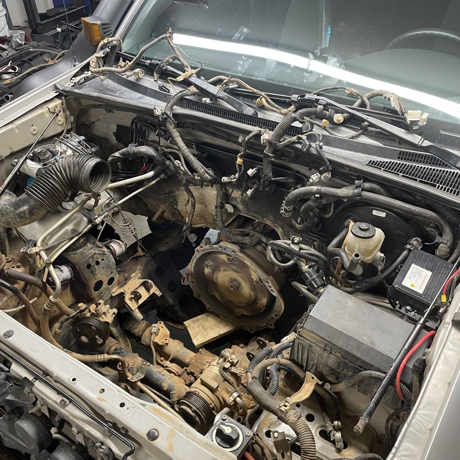

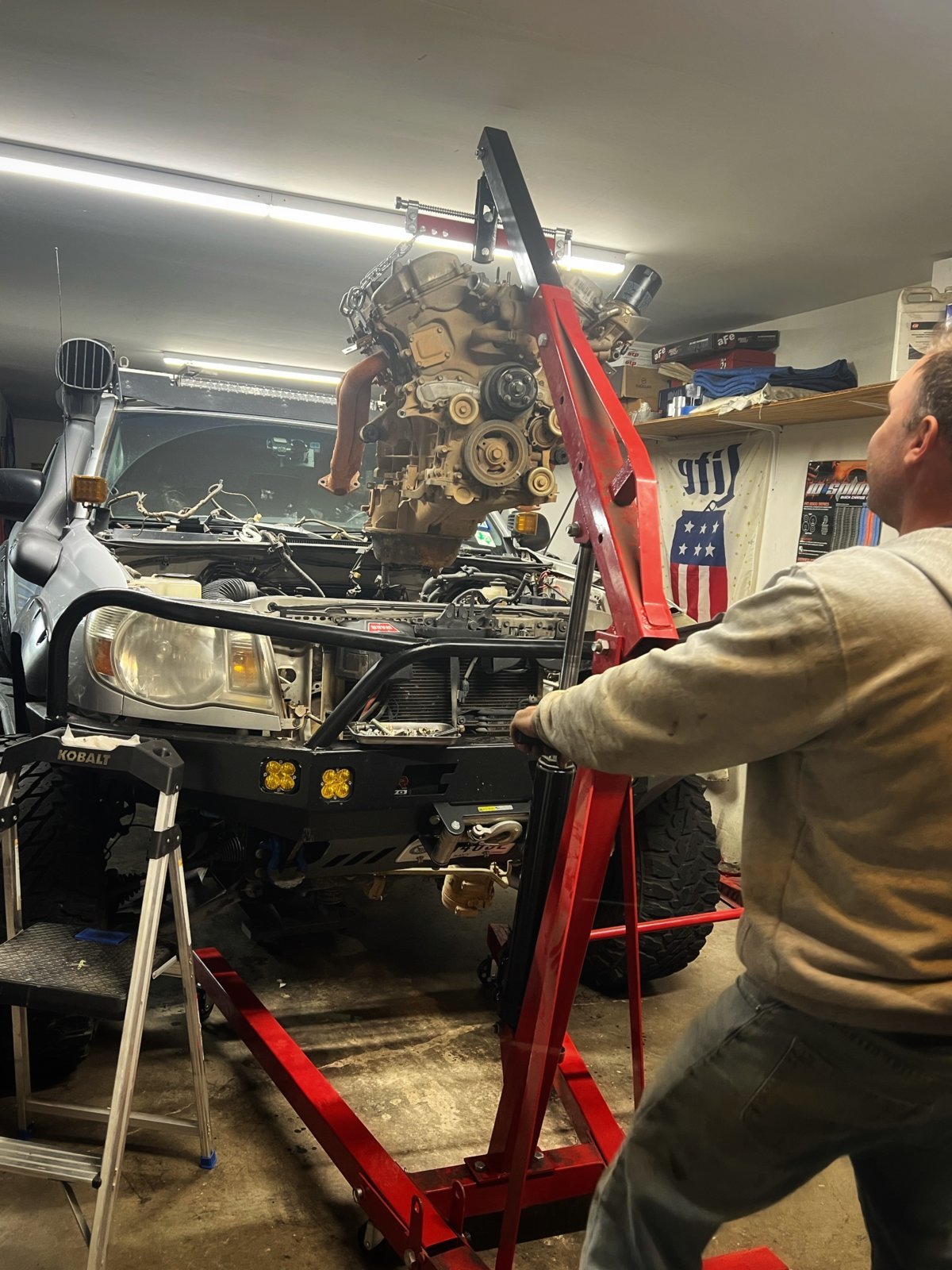

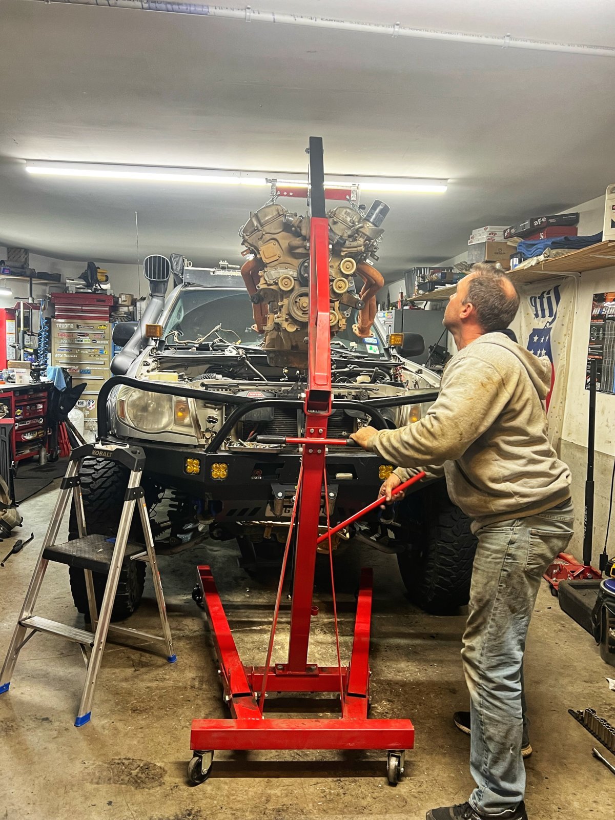

    Made some progress this weekend prepping to remove the motor. All that’s left is to disconnect the trans from the motor and drop the trans out. Then unplug the rest of the top end wiring and get it out the way. Then unbolt the motor mounts to pull the motor.

  12. Dec 4, 2023 at 9:57 AM
    Torspd
    Torspd Tor-nication
    Sep 18, 2009
    #22958
    26,311
    Tor
    The Great America!
    MMVI 4.4L 4x4 Access Cab
    Torspd Custom Turbo kit [] Borg Warner 9180EFR Turbo [] Haltech Elite 2500 [] TiAL Q BOV [] TiAL V44 Wastegate @ 15psi [] CP Pistons [] CP Carrillo Rods [] ARP Head studs [] ARP Main Studs [] ARP Header - Head Studs [] Ported Heads w/ 1mm oversized valves intake/exhaust [] Brian Crower Forged Stroker Crank [] Darton M.I.D. Sleeved Block [] Kelford Camshafts [] Torspd 160* T-stat mod [] APR Large Fuel Rail [] Walbro 460 LPH E85 Fuel Pump [] FueLab FPR [] APR T56 Conversion Kit [] KP RACING Built T56 [] McLeod Racing Custom Twin Disk Clutch [] One Piece Aluminum Driveshaft [] MGW Shifter [] Custom lowering kit [] Ohlins Front Coilovers [] QA1rear shocks [] Custom Ron Davis Radiator [] Dual SPAL Electric Fans []
    A start is a start.
    Strictlytoyz likes this.

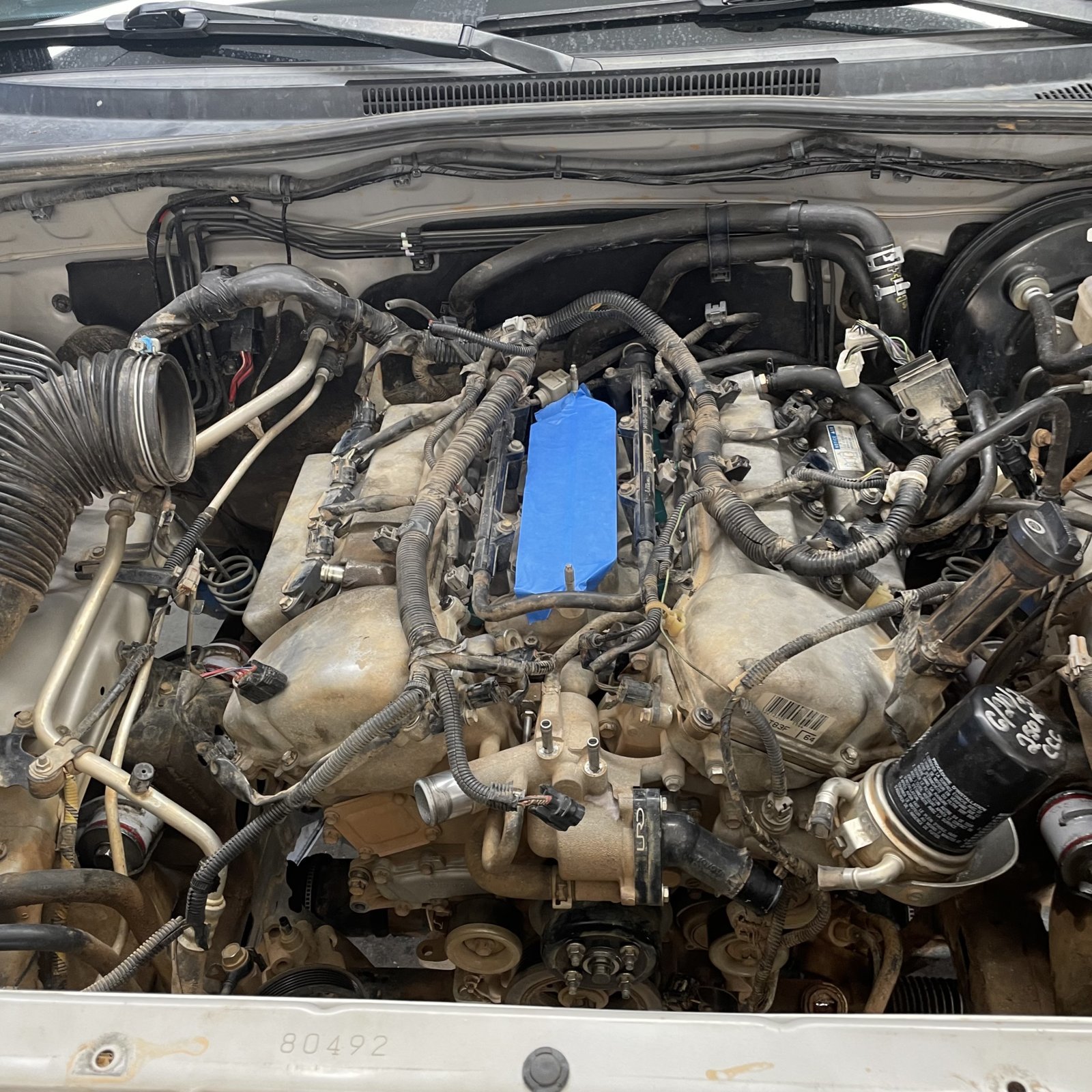

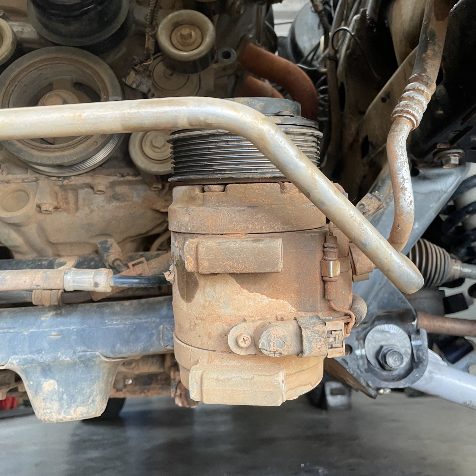

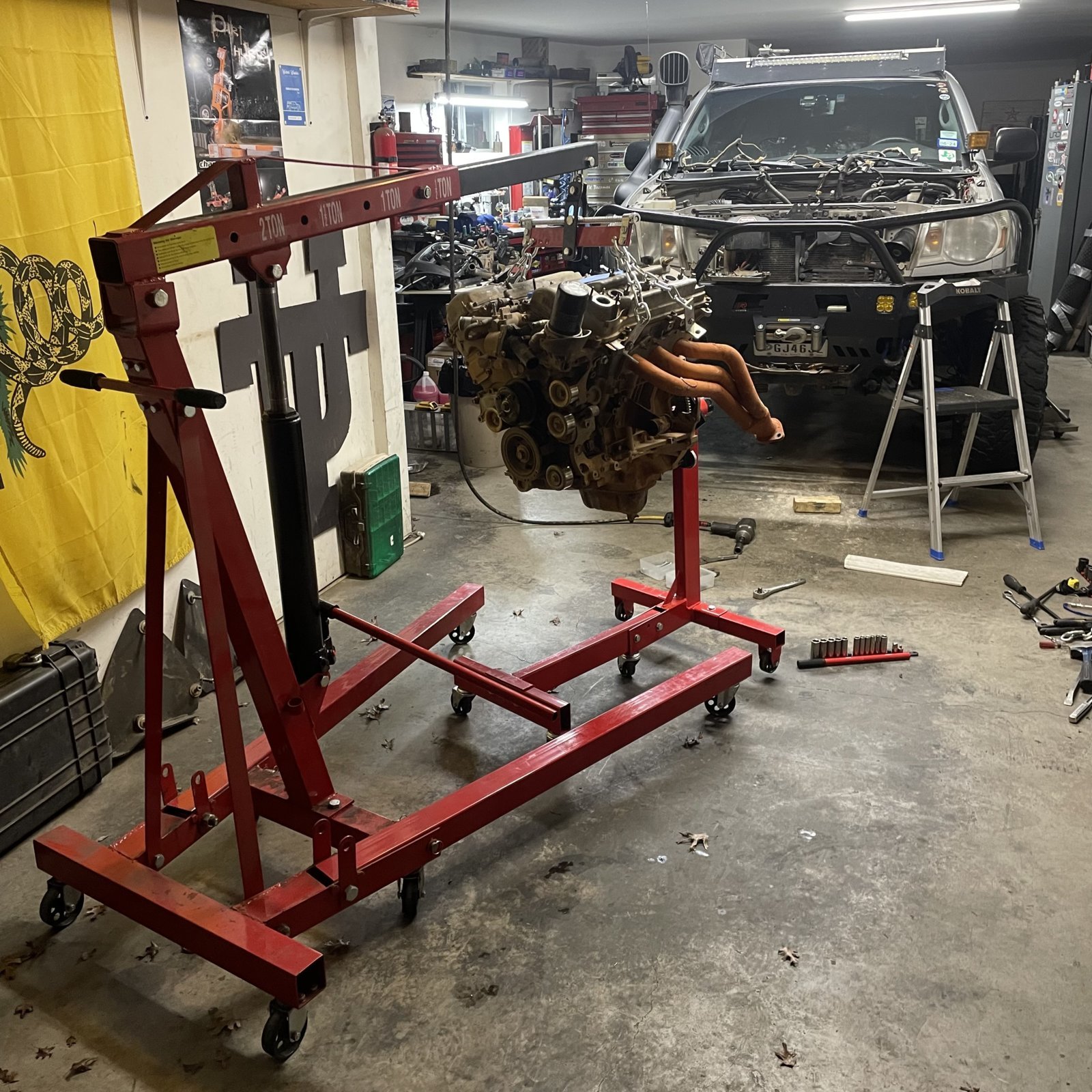

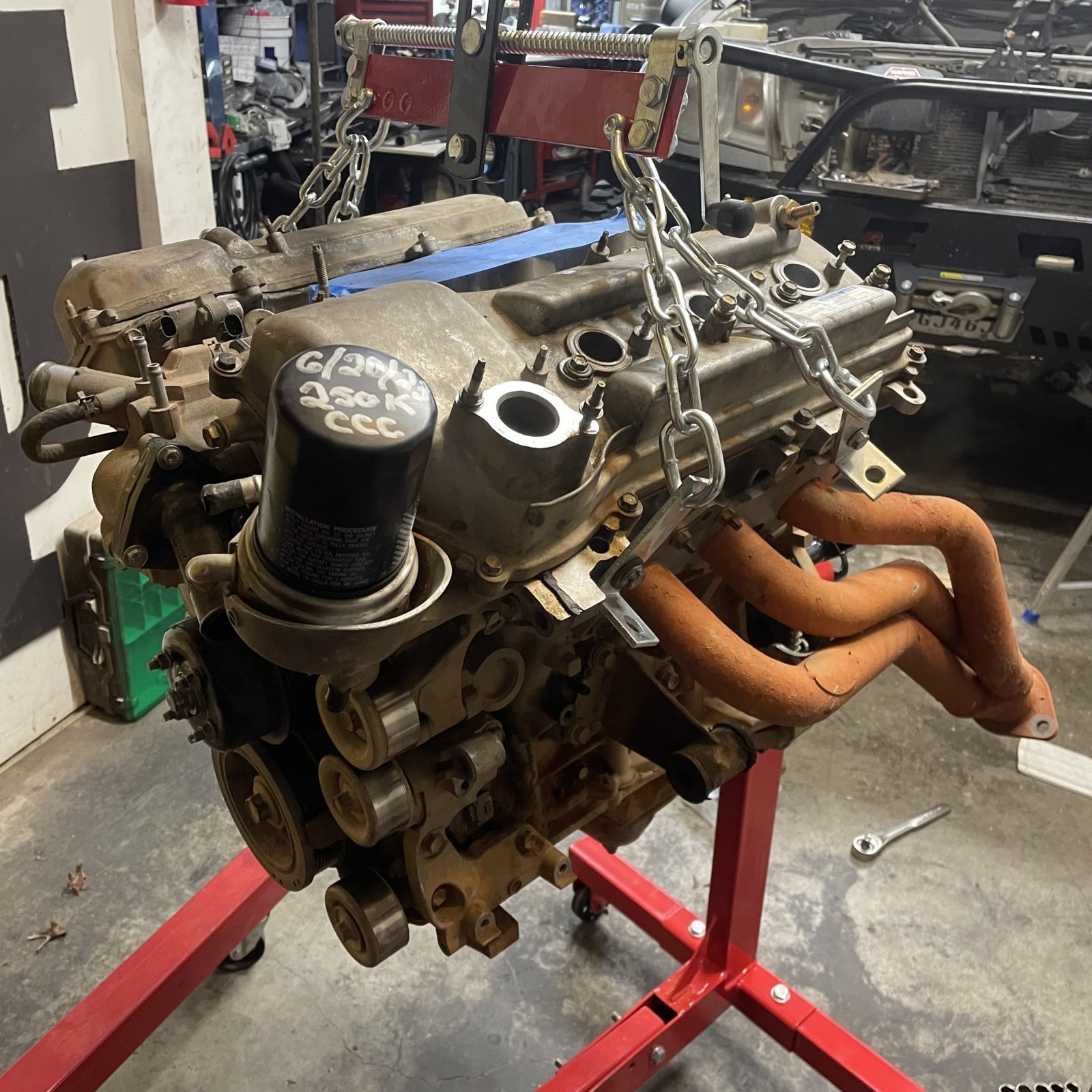

    Bluetooth engine mod complete.

  15. Dec 10, 2023 at 8:36 PM
    Torspd
    Torspd Tor-nication
    Sep 18, 2009
    #22958
    26,311
    Tor
    The Great America!
    Well done. Trans still in the hole. :thumbsup:

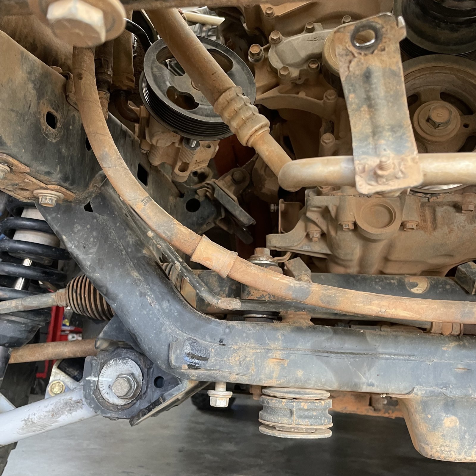

  16. Dec 11, 2023 at 3:43 AM
    #16
    Texoma
    Texoma [OP] IG: Triple C Chop Shop
    Feb 1, 2011
    #50374
    18,955
    Chris(Topher)
    Lago Vista, TX
    10 Taco 4x4
    A bunch a cool stickers, a bada ass MetalMiller Tx Longhorns grill emblem painted Hemi Orange, JBA long tube headers with o2 sims, Diff breather mod, Red LED interior lights, Fancy head unit that plays ipod n movies, Also DIY install factory stuff like, factory cruise control, factory intermittent wipers, OME nitro struts with 886x springs and toy tec top plate, JBA high caster UCA's for better alignmnet and dey beefier too, Old Man Emu Dakar leaf springs in da rear with the gear, U bolt flipper, Ivan Stewart TRD rims with 33" K Bro 2's, some bad ass weather tech floor liners so I don't muck up my interior, an ATO shackle flipper for mo travel in da rear wit the gear, also super shiny Fox 2.0 shocks back there too, all sorts of steal armor for bouncing off of the rocks like demello sliders, AP front skid, trans skid, n transfer skid, demello gas tank skid, and a tough as nails ARB bumper with warn 8k winch, I'm sure there's more
    Yup, I’ve hit that cross member too many times for it to come out easily, so didn’t take that out. Figured bolting the mount up and some wood in the frame ought to keep it happy.
    Torspd[QUOTED] likes this.
