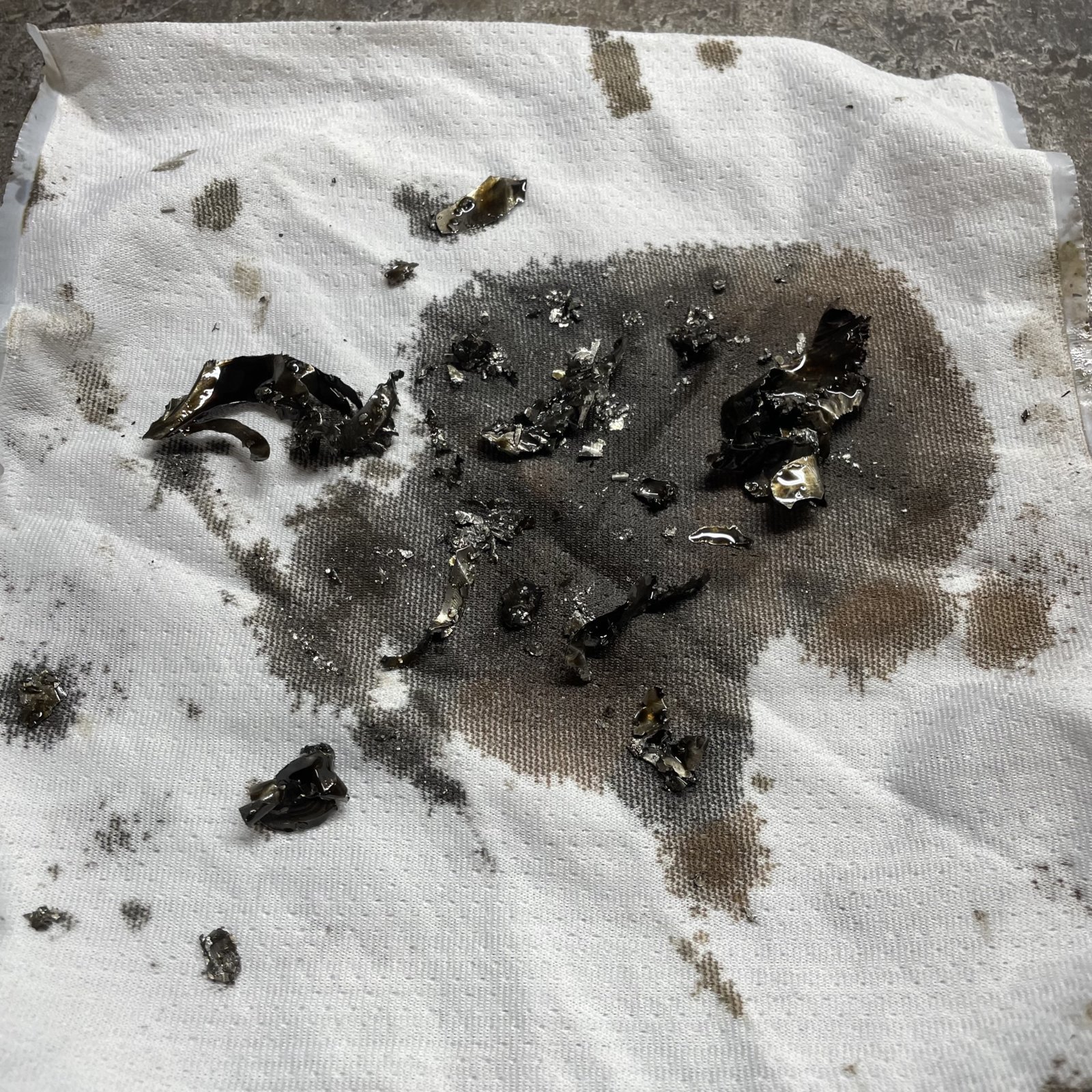

    Should have taken that last pic with a ruler or pen for reference

    Looks like you found #3 rod bearings that made their way outside of their normal habitat.

    that’s what I’m hoping and not cylinder wall shavings

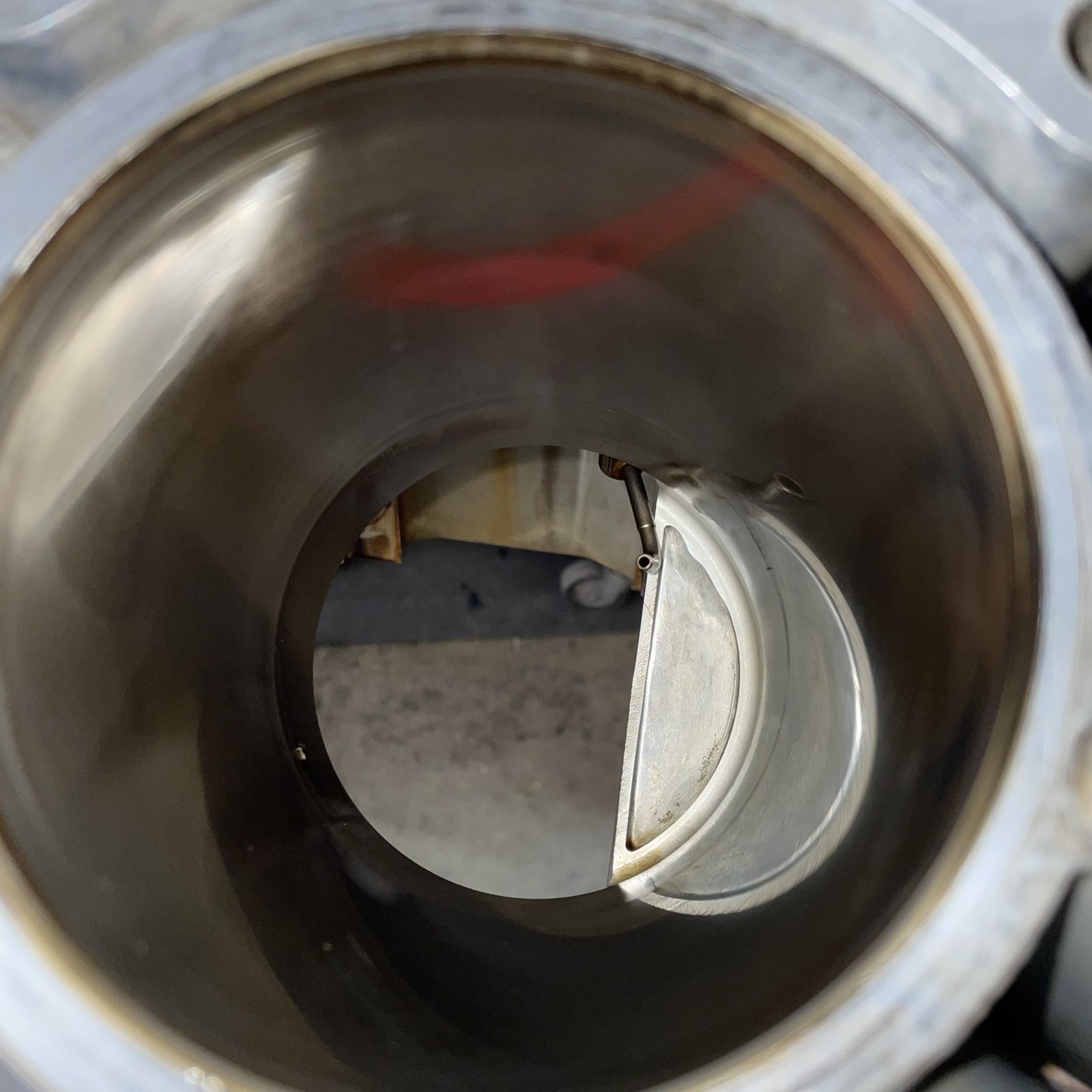

    You’ll know soon enough! But cylinder walls are steel sleeves, and this doesn’t look like steel

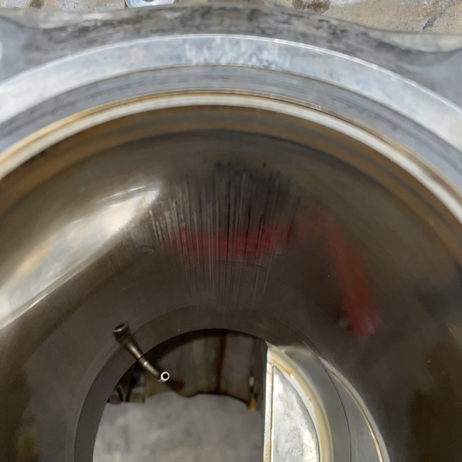

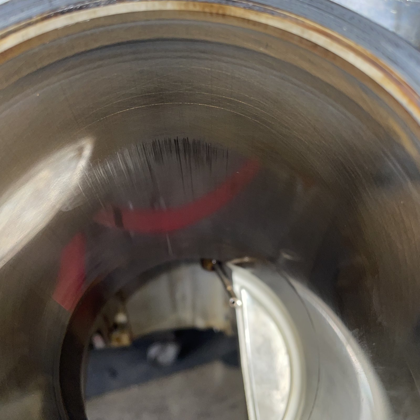

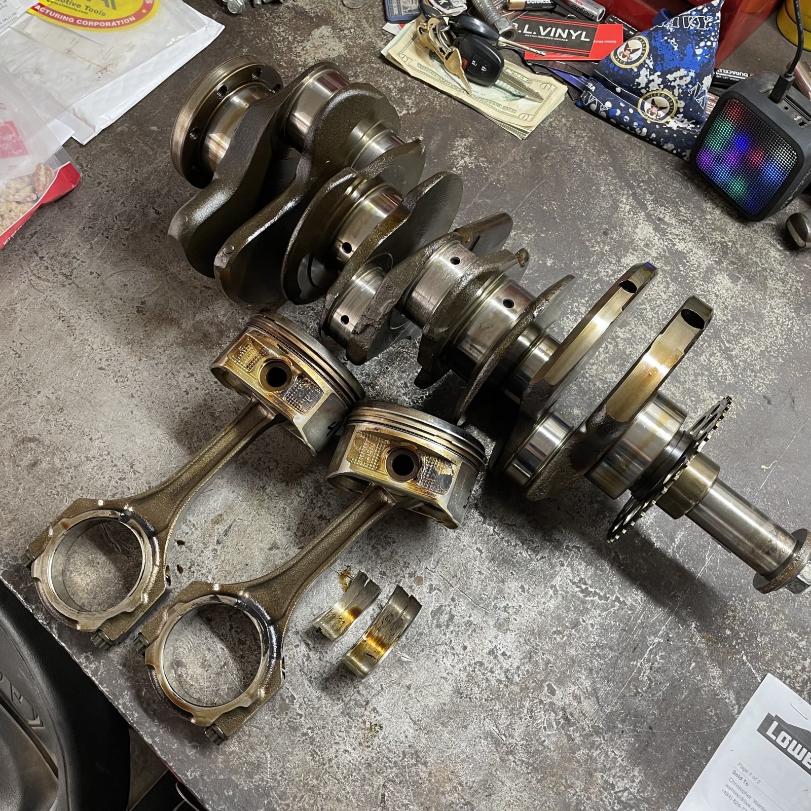

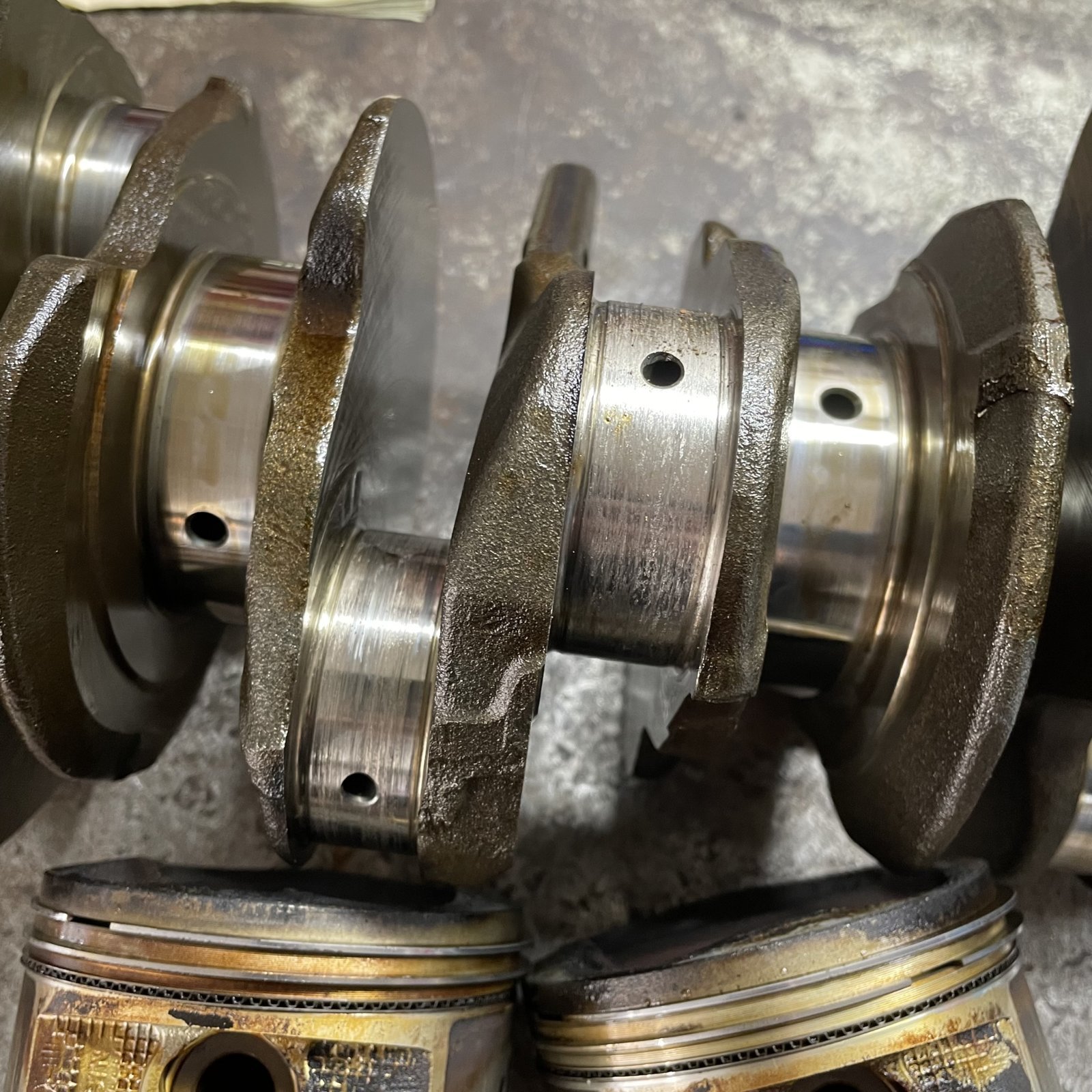

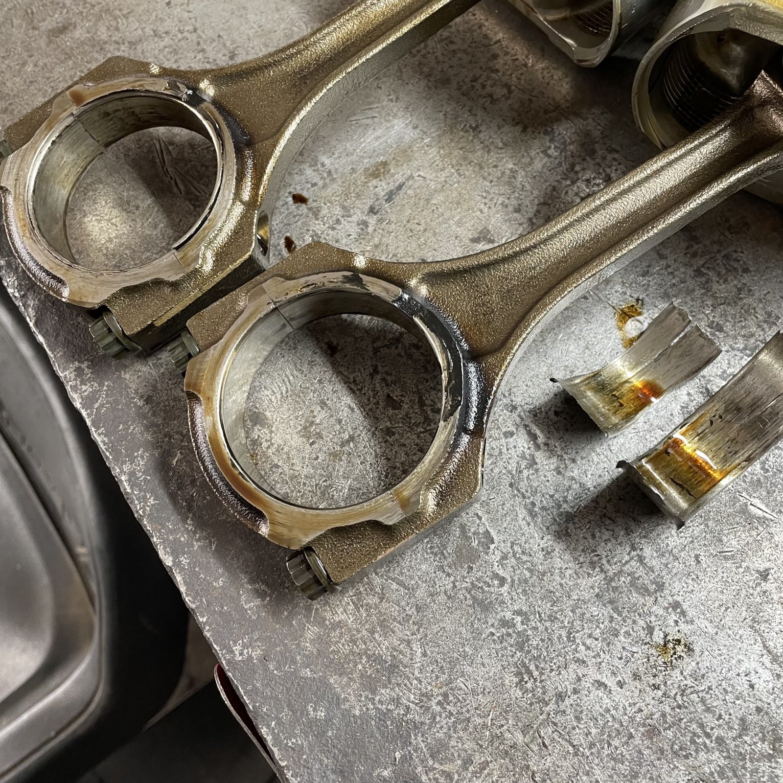

    I think I found a nail in the coffin for the ole motor. 3 and 4 piston walls are scored. #4 I can’t really feel with my finger, but my finger nail can feel the scoring. #3 I can feel how bad it is with my finger alone. The crank 3 and 4 is scored and the rod bearings are toast. Also looks like the thrust bearings took a hit as well. I personally think it was oil starvation, but really I don’t think I can find that out. If it was just the crank, I’d get a new one and move forward with rebuild, but since the cylinder walls are scored, I don’t think I can hone that out. 3rd pic is of a good cylinder for example.
    IMG_3301.jpg IMG_3302.jpg IMG_3303.jpg IMG_3304.jpg IMG_3305.jpg IMG_3306.jpg IMG_3307.jpg

    I gotta say, the difference between using the 14mm triple square and the 10mm double hex is huge. Triple square has a huge amount of movement compared to double hex does not move

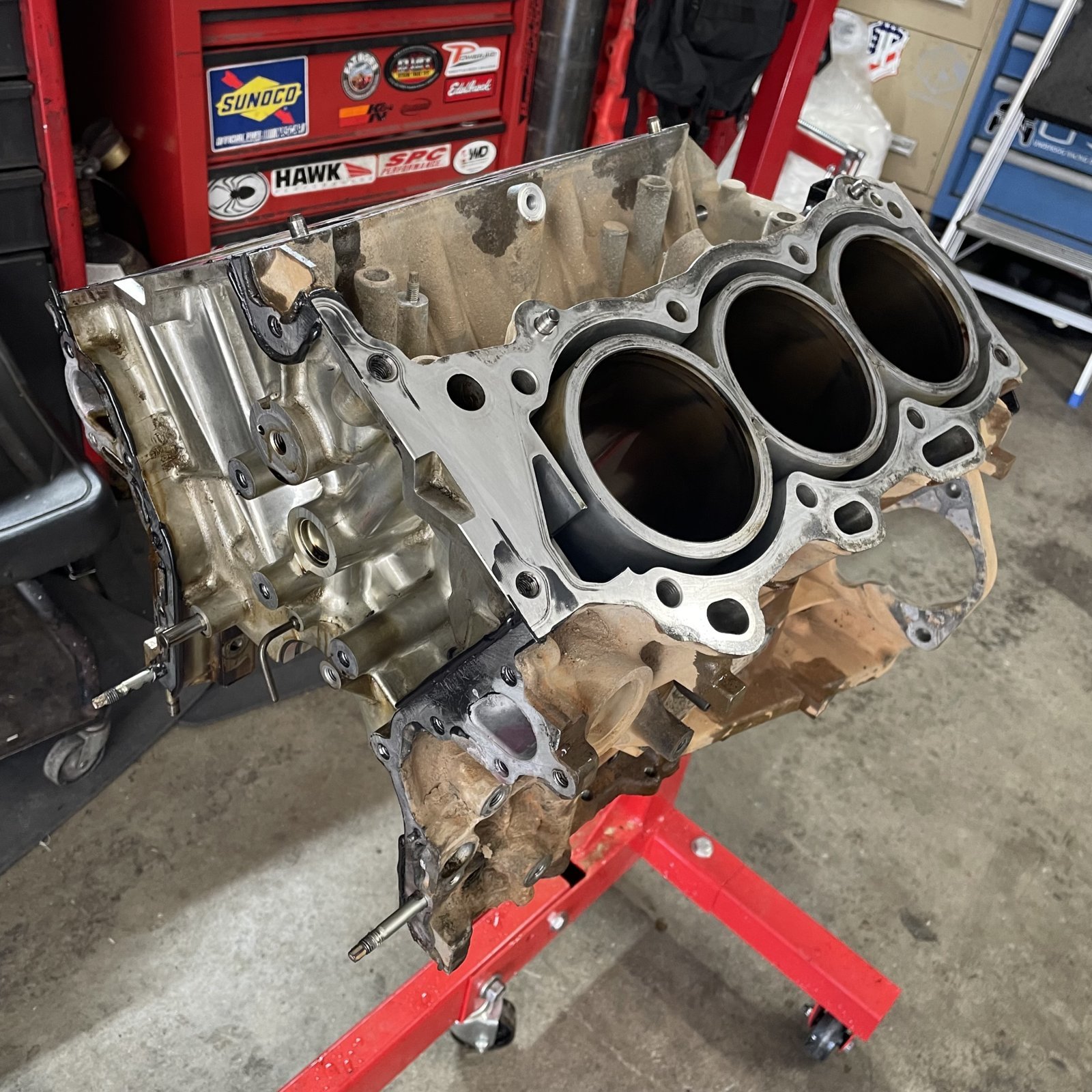

    used 4.0 for $1650 delivered is well within my budget. I’ll do a light tear down and reseal on it. Mainly reseal the timing cover and replace rear main, then drop it in the Taco and be done.

    it’s a possibility that I could have been at an awkward angle over the past 13.5yrs of this motors life, I do wheel it hard. The bearings are what caused the cylinder scoring for sure.

    Yikes. Those rod-cap bearings look trashed.
