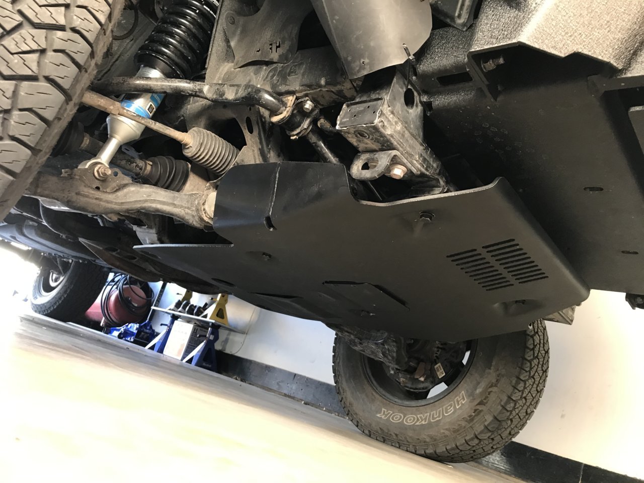

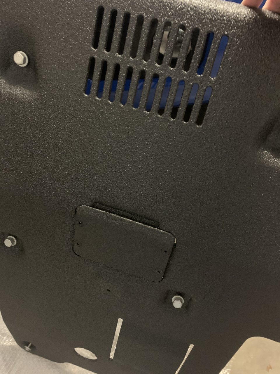

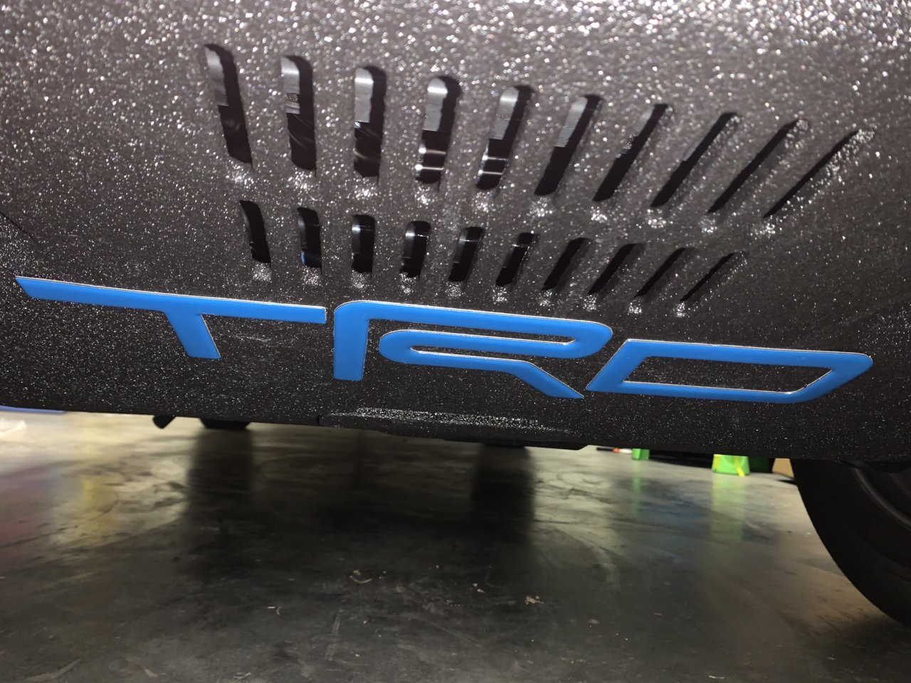

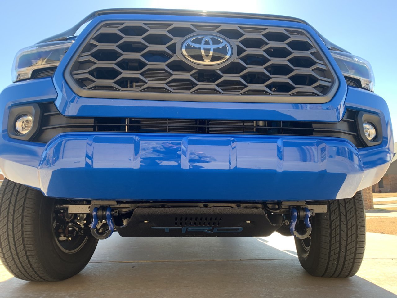

    I haven’t seen the $130 one. I sprayed mine with bed liner, stuck some color matching TRD decals from BDTRIMS on it, put anti-seize on the bolts, and installed it without too much trouble.
    Start in the front and work towards the back, but screw them in just enough to hold them in place. This will give you a little bit more working room to screw in the smaller back screws which were more difficult because of the rigidity of the plate. Once the rear ones were in I tightened them down then worked my way back to the front tightening all the screws down.
    A couple things to note: it did NOT come with any TRD letters and there was no TRD impression on the skid. It was flat. Also, the front and middle screws/ spacers arrive incorrectly. You will need to switch them before the install. The LONGER screw and spacer must be in the front, and shorter in the middle. The rear ones were correctly placed.

    That is Sweet! I love the blue TRD. The color of the skid and the lettering are perfect. Would you be too upset if I used this idea on my Blue Taco?

    Hell no I don’t mind! Isn’t that what this thread is for?
