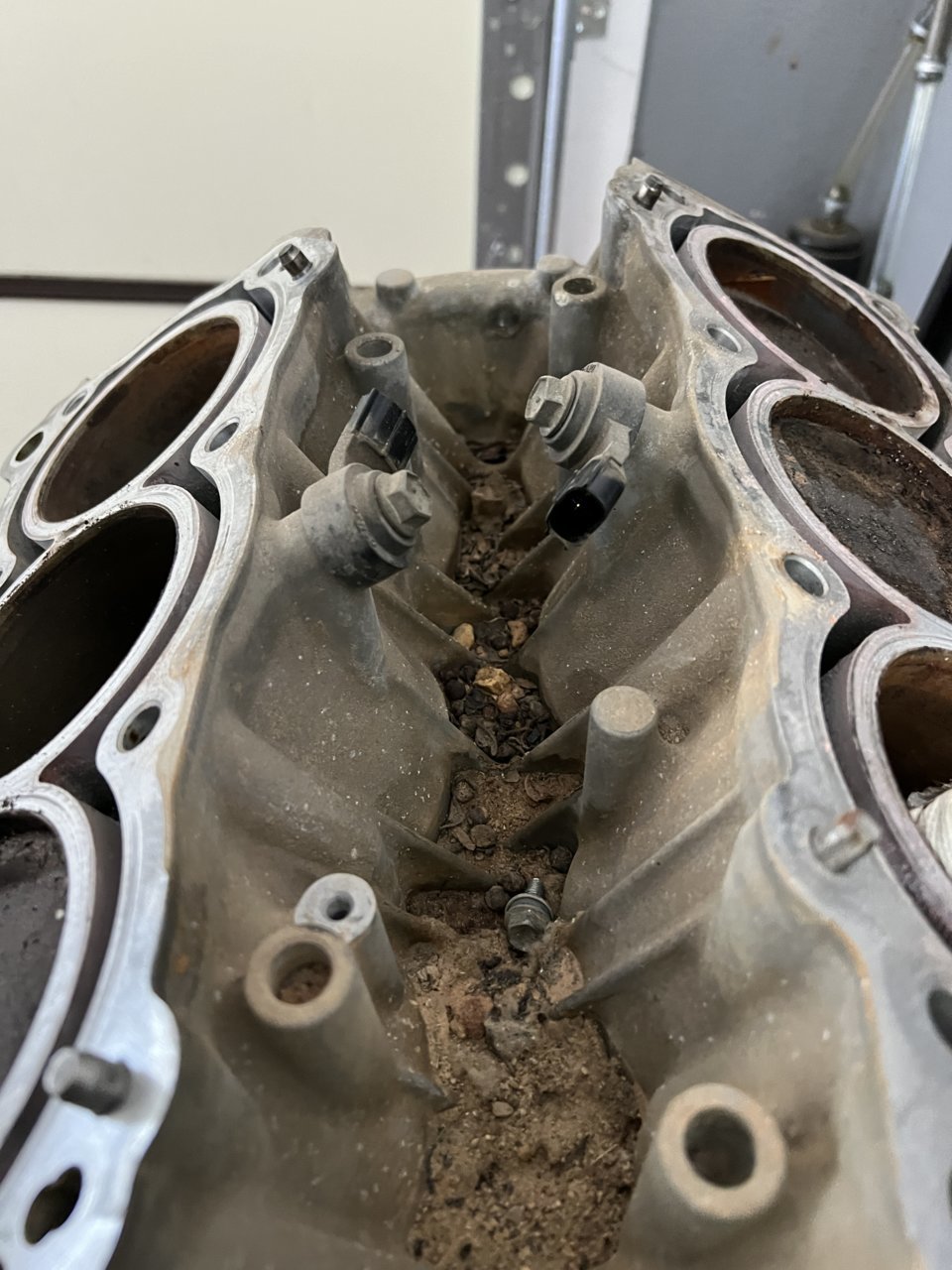

    Brandon###
    Brandon### Well-Known Member
    Apr 27, 2010
    #36105
    1,046
    Here is a pic of the sensors without the cylinder heads, intake, etc in the way. You can tell how they’re buried under everything.
