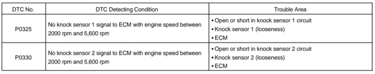

    Slightly off yet on topic, those DTC codes show an RPM range of 2000 - 5600, I was under the impression the OEM ECU only looks at the knock sensors from 3000 - redline. Is this in error and its essentially in "knock closed loop" starting at 2K RPM?
