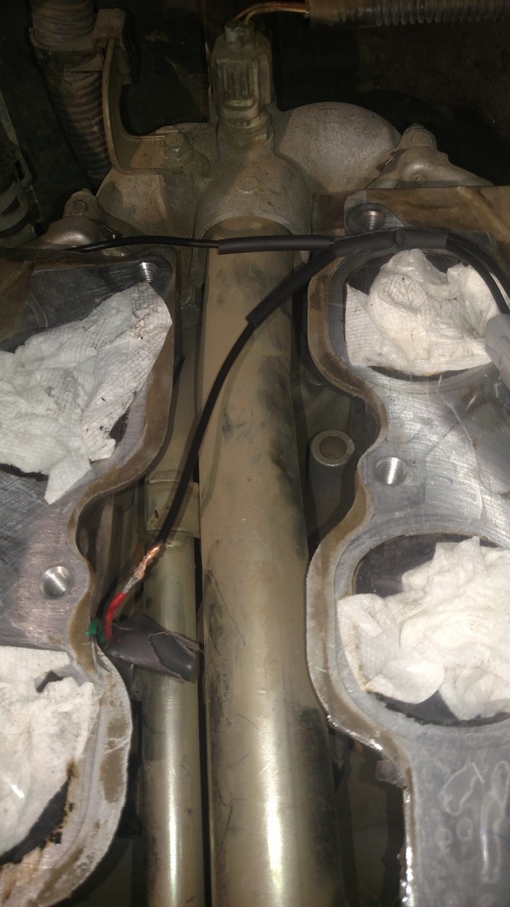

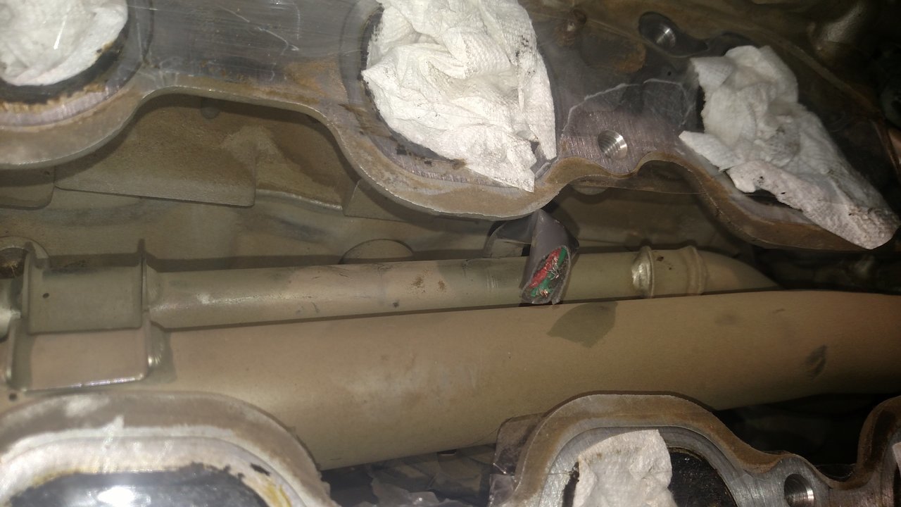

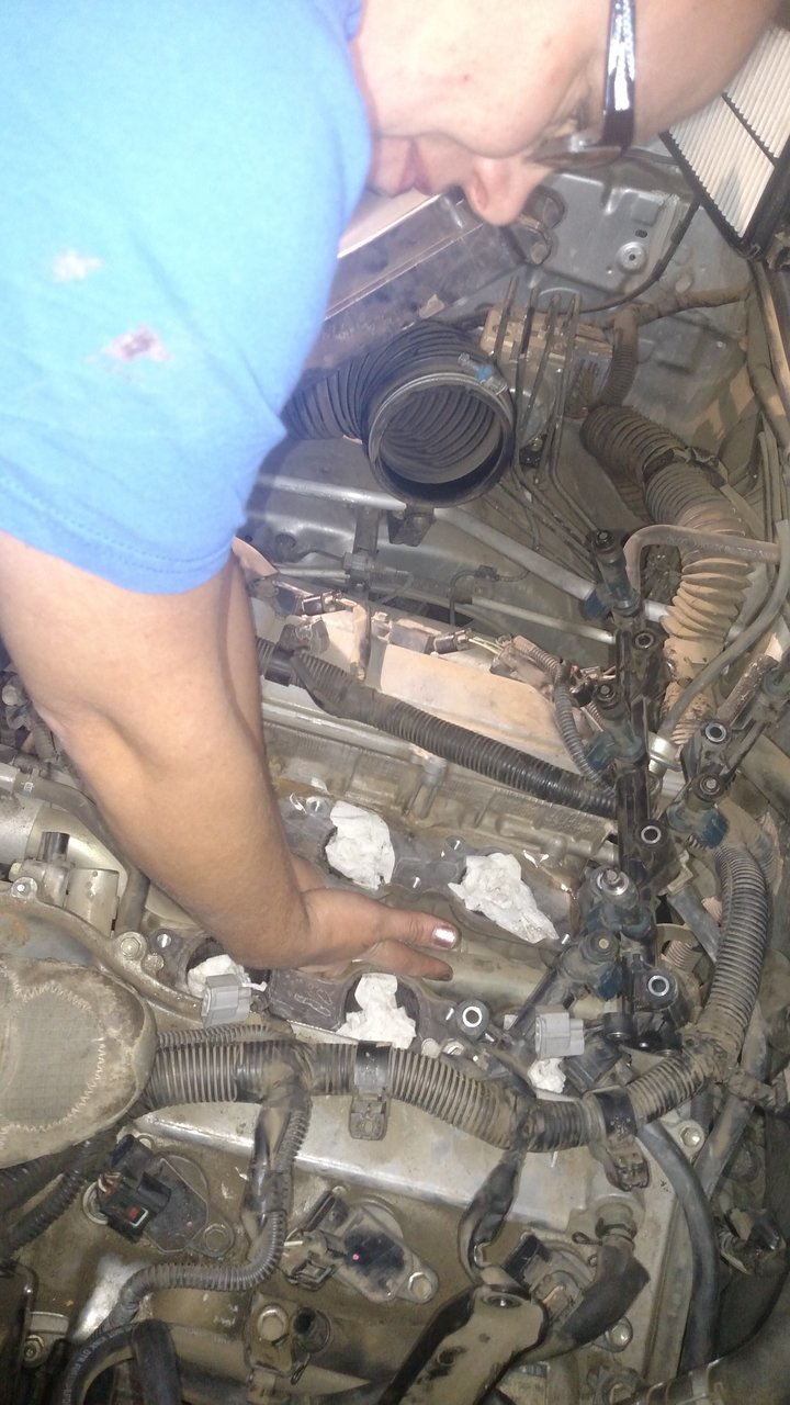

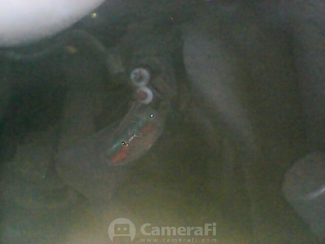

    After I got home last night, I started tearing into it and using an endoscopic camera to look for the wiring.171101_192721.jpg a pesky rodent had climbed under the intake Wednesday night after I'd called it quits and taken liberties with the wiring. Luckily one of the local parts stores had ONE connector in stock for ~$10. Quick trip to town and back, bit of solder and some shrink wrap then it was time to button her back up. Oh, but it's also helpful to have someone with smaller hands (my wife) who can more easily reach under the coming pipe to unhook/hook up the connector. IMG_20171101_212427674.jpg IMG_20171101_212503065.jpg
    When you're removing the fuel rail, be mindful of dirt/debris sitting around them. I had pine needles and dirt dobber nests that I vacuumed up. Also be careful that you don't damage the injectors. You can set the whole assembly to one side after only removing the 2 bolts and unplugging the left side. Also if you're using an endoscope to check the wiring, look from the front rather than the rear. The plug ends on the sensors should be visible from the front.
    In all, it took just over 5 hours, $10 ($12 with tax) replacement connector, and my wifes smaller hands to get it fixed. I did use 2.5 cans of brake cleaner on the lower intake manifold as it was so filthy and I DID reuse the gaskets. Yes I know I should have replaced them but the lower 2 were still in excellent shape and came off clean and unwarped and the upper was still pliable.
