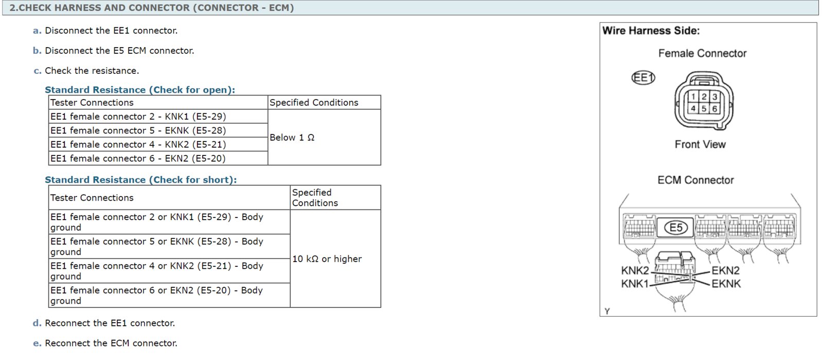

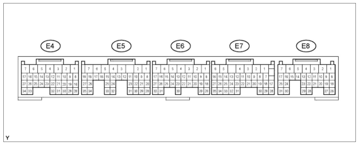

    Sounds like you have an open in the Bank 2 circuit.

    Why do all that when you can just unplug EE1 and check the voltage across Pin 4 (Green) and Pin 6 (Red) on the PCM side of the harness with the key on and the connector unplugged you should see 4.5-5v across the 2 pins if the wiring is good between the PCM and that connector.

    To be honest, I didn't want to look at the diagrams.
    It was just easier to "Copy and Paste".

    No worries, that is what Toyota has you doing in the flow chart for that code but it would be much easier to do one voltage check than 4 resistance checks.
