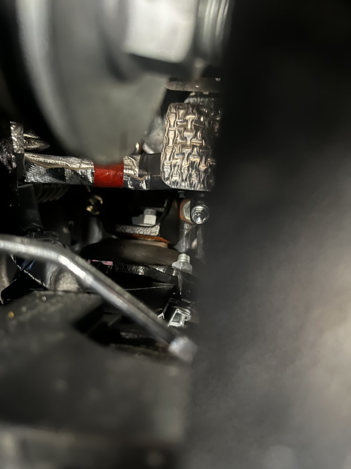

    Waiting for the field engineer. I looked at my engine mounts and noticed the drivers side doesn’t seem to be seated correctly. I went to look at bunch of tacomas on the used lot and they all don’t have this massive gap between the two parts of the mount.

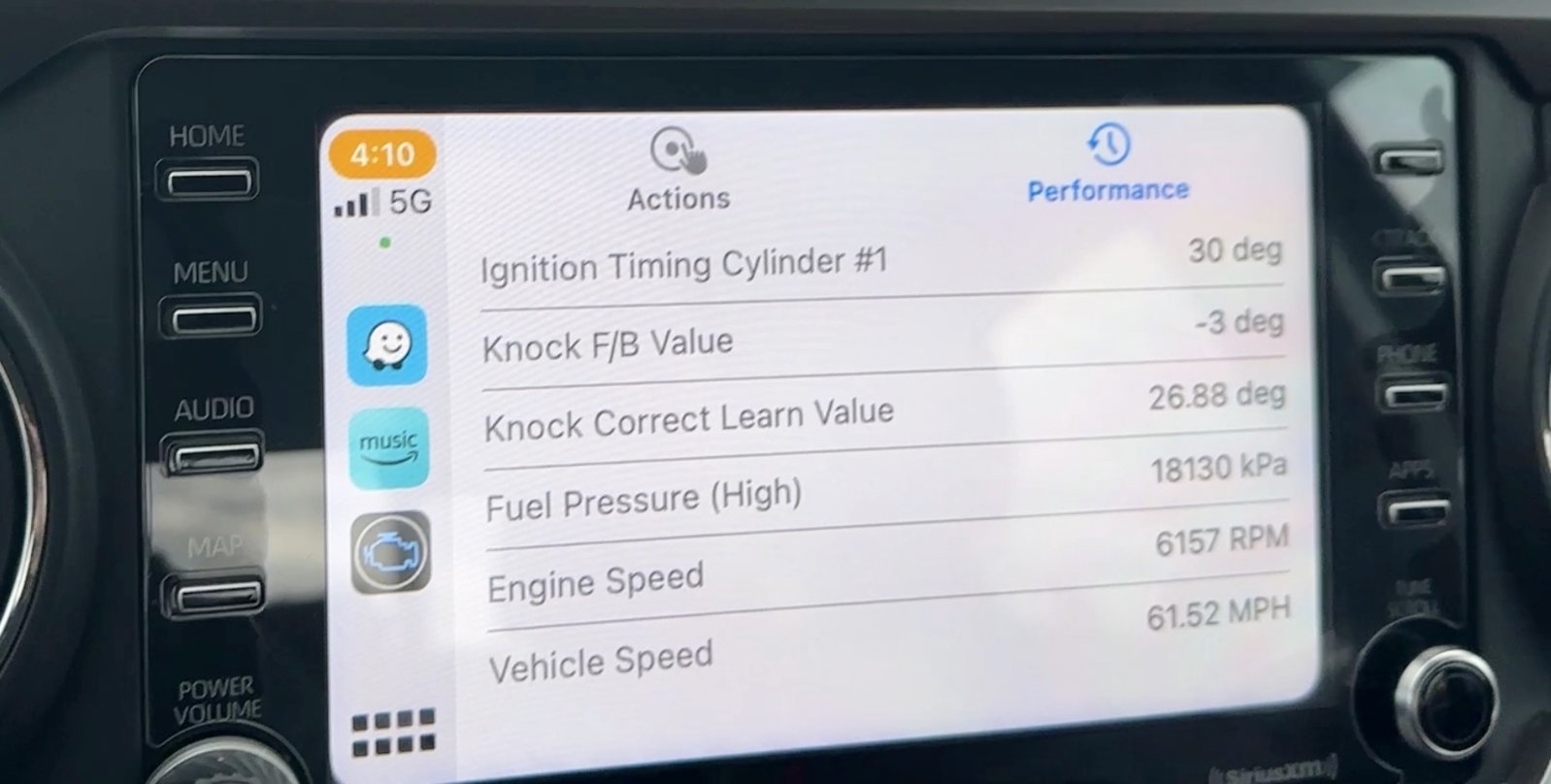

    #428769
    553
    2023 Trail Edition
