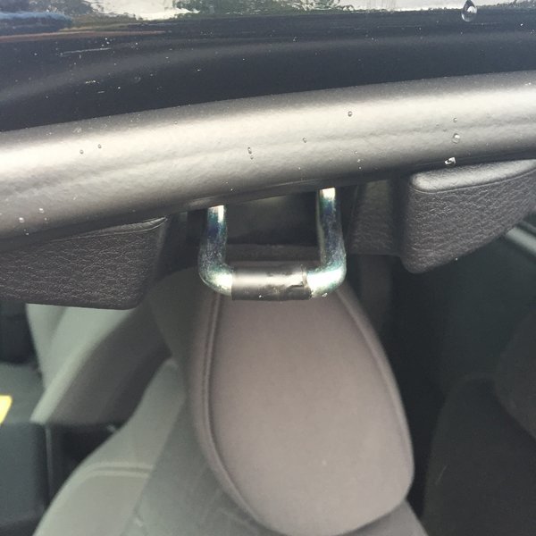

  16. Jun 18, 2016 at 3:07 PM
    #16
    Wolf2
    Wolf2 [OP] Member
    Dec 18, 2015
    #172542
    15
    '16 TRD OR ACLB
    It's the door latch itself. There seems to be just the slightest bit of play between the latching mechanism and the bar. I wrapped a bit of electrical tap around it and now I can't hear it at all. This isn't a permanent solution, but it'll do till I figure something else out.

    Thanks for posting.I had my wife in the truck yesterday and we drove over 200 miles, and I did not hear the rattle once, so now I wonder if you have a passenger who wears their safety belt, the belt has extra tension on the 3rd door which prohibits the latch / locking mechanism from the occasional rattling? Thanks for the pic.
