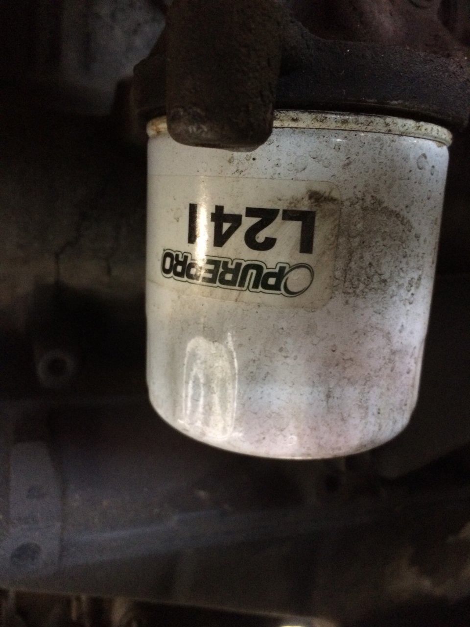

    Are you using OEM oil filters? If not, they may not have an 'anti-drain' check valve.
    This may cause the initial knocking.

    Spokane
    2016 Tacoma SR 5spd
    I'm not sure. I have been going to the oil shops to get it changed. Whatever they have been putting in but i can ask. Or request that.

    I'm betting on slightly improper oil weight (in reference to ambient temp), or cheap-o oil filter. This is likely especially the case if you're getting the "$24.99 oil change special". Super low quality conventional oil and filter.

  19. Aug 22, 2018 at 10:25 AM
    #19
    Teal_6
    Teal_6 [OP] Well-Known Member
    Jul 12, 2017
    #223879
    203
    Robert
    Spokane
    2016 Tacoma SR 5spd
    Ok not sure what brand of oil they used. The place i go is called grease monkey but here is the filter that is in it from them. Also the oil looks good after 2200 miles but is halfway to full on the dipstick. I will see about pricing out a valve adjustment but it doesnt seem to be hard to start up right now.

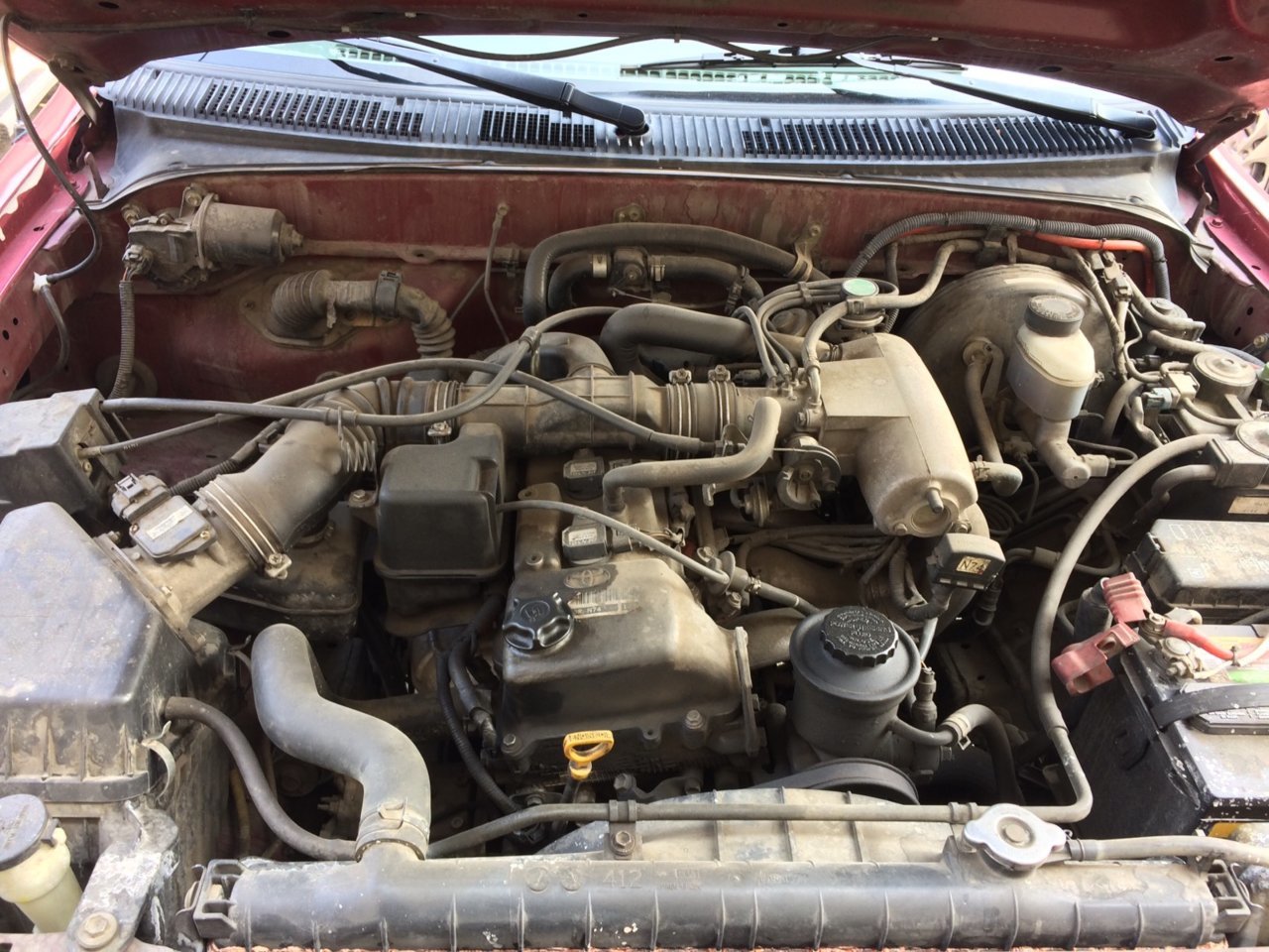

    KdF
    KdF Old Rednek Type
    Jul 13, 2007
    #2079
    948
    East-ByGod-TEXAS!
    2000 Prerunner SR5 TRD 2WD
    AARRGGHHHHH!
    1.) Clean that Engine, a clean engine is a happy engine.
    2.) You are welcome
