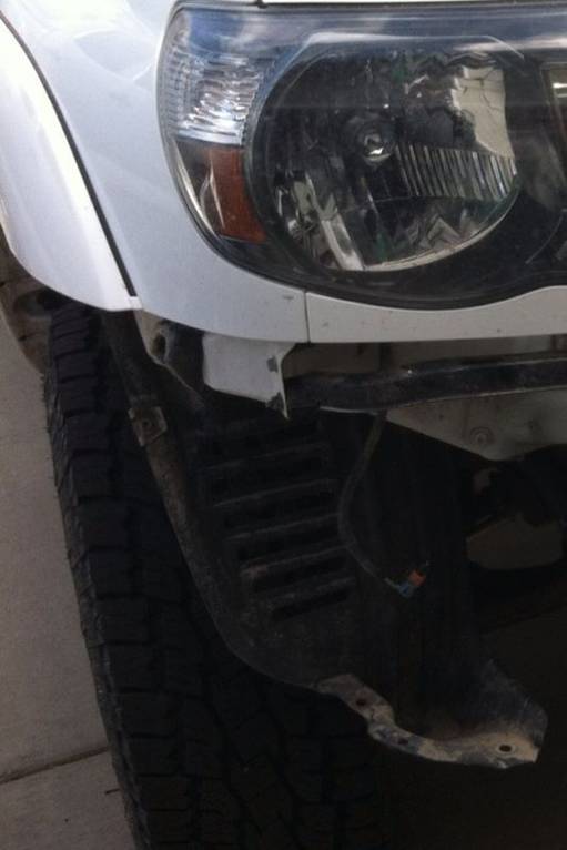

    I put a Relentless bumper on my truck this last weekend, and forgot to take off 2 bumper brackets. They are between the headlight and the flare on the bottom of the fender. They are held on with a single screw through the middle. When I hit a bump the bumper would contact those and make one hell of a racket. Pulled both of them off, and its good now. Not sure how similar the 11 and the 13s are, but its worth a look. All you will really be able to see from the top is 2 little clips that hold onto the fender. If you need pics let me know.

    Pics would be appreciated. I think the 13 and the 11 front ends are pretty different, but I'd love to see exactly what you are talking about so I can check. This noise only happens occasionally and only on one side if I hit a bump just right..

    The little black bracket just in front of the flare.

    I did get an alignment. I think it might be my bumper now. Had a friend stand out side it while i went up and back down a curb causing the noise. He pointed out that the bumper was touching part of the metal under my headlights on the side, and that the driver side had enough clearance that it wasn't touching it. So this weekend I plan on adjusting the bumper so it has more clearance on that side. I also went by my local off-road shop and they agreed that it looked like it was the bumper rubbing. They checked my install of the shocks and said everything looked good.
    i have not had a chance to check if the shock is loaded correctly like NVWIGGINS suggested, though that will be my next check if the bumper turns out to not be the cause.
    Skidooman - Mine is different but I do have a similar piece that my bumper is touching, though its a slightly different location. Not sure I can take it off but I know I can adjust the bumper so that it doesn't touch it. Hoping that is the fix.

    Turns out it was that bumper bracket that Skidooman posted. I removed both and adjusted bumper to make sure it wasn't touching anything and had room for the body flex. Been perfect since.
    Thanks Skidooman for the tip! And thanks everyone else for the input
