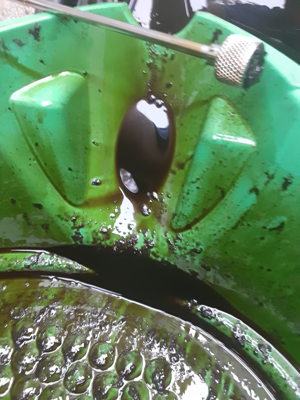

  10. Jul 3, 2023 at 12:25 AM
    JosiahDirtovkik
    JosiahDirtovkik [OP] Roadkill is my education...
    Aug 27, 2022
    #404499
    100
    Sumter, SC
    1999 Red Tacoma SST 5 lug 2.4
    Poorly painted hood, glasspack/muffler, toolbox on rear portion of bed, El cheapo radio n speakers.
    20230702_200235.jpg 20230702_160015.jpg Welp... Crap. That's all I got to say.

    Bought a stethoscope and put against the block. It's knocking. No denying it now.
