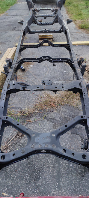

    Finally picked up a frame.

    How much

    Paid 2400

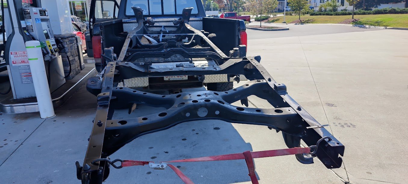

    Now that’s one way of getting it home. :thumbsup:

    Thanks, I had to do it with style, :crapstorm:
    unloaded it last night. Just dragged it of the bed most of the way. Used a cherry picker to lift it off the bed and drove the F350 forward then lowered frame to ground. Fairly easy task.
    Need steering rack (leaks) and an oil pan ( dented it with a jack)
    Came with cab mounts but ill get new ones if needed.
    Guy at work used to do frame swaps at a dealership. Going to pick his brain a bit. Hope the weather holds out for some work.

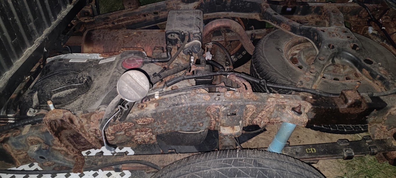

    bed is off

    I see that you cut the bed bolts, when you re-install, consider tapping the new frame bed bolt hoes to 1/2-13 and going with stainless bolts vs putting in the toyota bolts back in...

    i had to cut them, even with 3 foot cheater bar they would not turn much but enough to lift and push washer down and cut with sawzall with out affecting the bed
