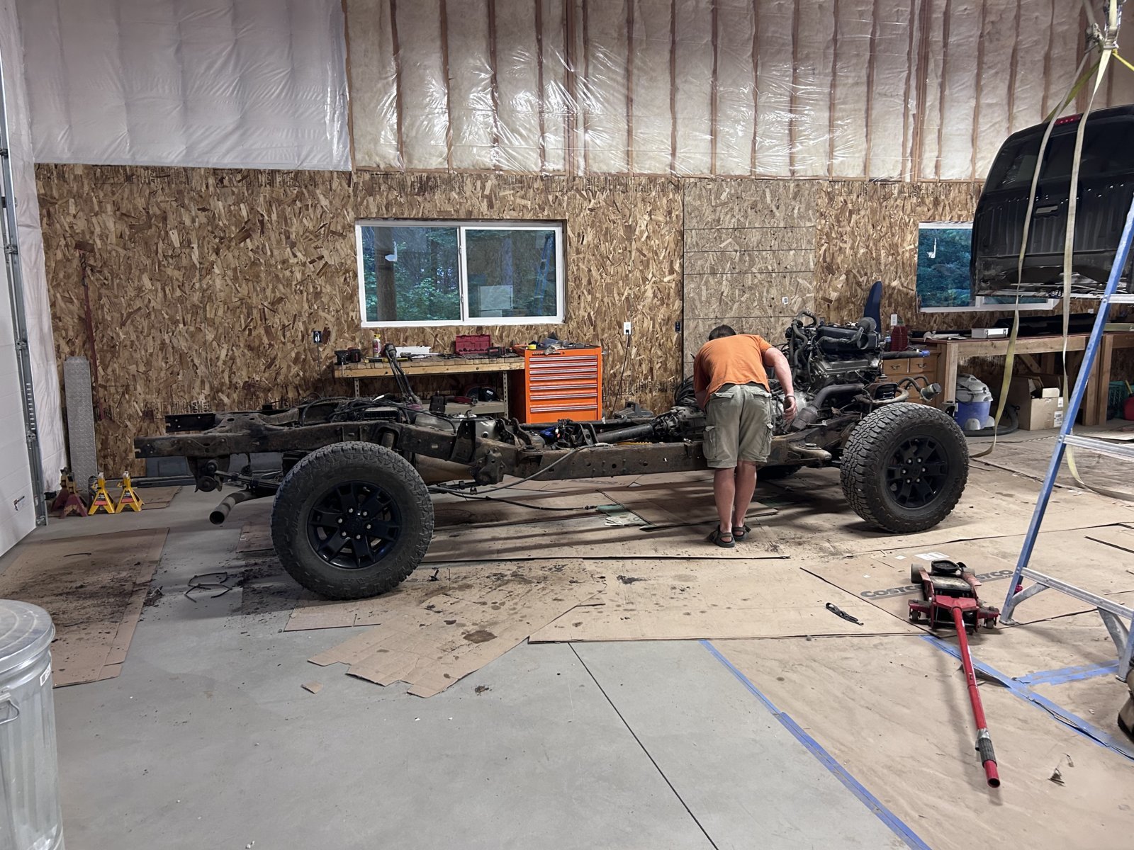

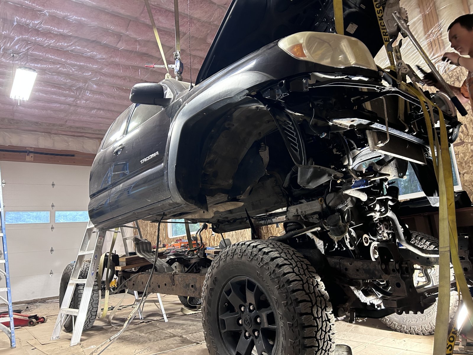

    Some progress made Saturday. Cab mounts are fun to cut off

    Rear is swapped and fighting the rusty bolts on the front end took a lot of time this weekend
    Need to order up some parts
    ADCreHclyv8lEerrYGOVFipelo5i8JWNt4PuKoDZ_295f40e10faaed492bb3ac374c41dc0a0562a06b.jpg

    Not yet, need to do front suspension and Diff, then can lift cab, swap engine/trans

    Interesting that you would do all that work under the truck. I would suggest pulling the cab and getting it onto a dolly, then pulling the engine/trans and front suspension, much easier to do it from the top
  11. Nov 7, 2023 at 4:58 AM
    #31
    jwarr
    jwarr Well-Known Member
    Jun 10, 2016
    #189219
    439
    Unless you are doing it the toyota way where you will leave the engine and trans with the cab? That will be a trick without a lift, props to you if you can engineer a way to do that! I have found that anything can be done with enough thought behind it

    6 days of fighting rusty bolts
    Might have gone faster if i had a impact gun and more daylight

    Front end is all un done. Just need to pop the CVs and get a helper to carry it over

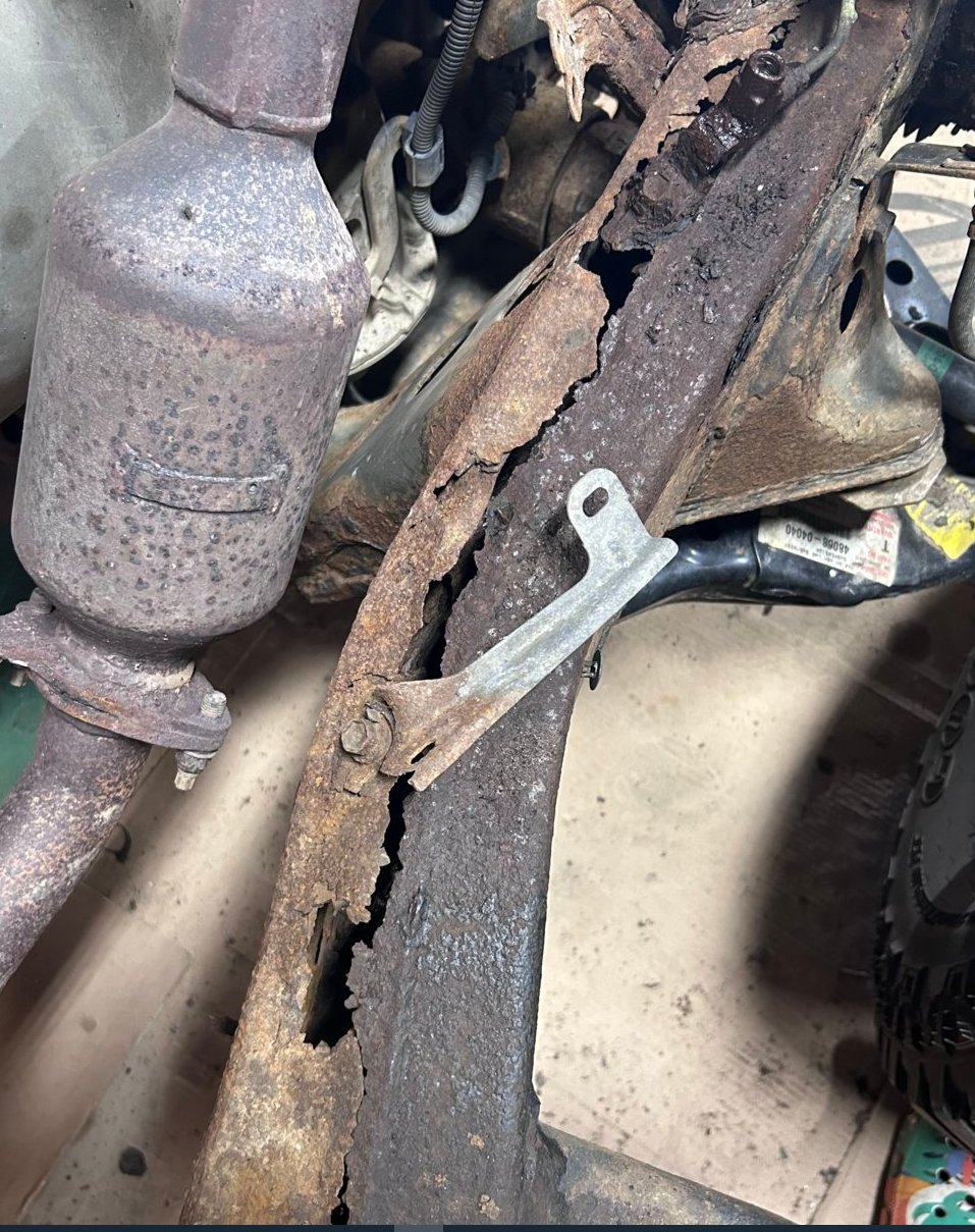

    ADCreHdDuXncczhWzOalxLjoHfCt7tUrDsONPbcr_df2cd846aaa008fce9576b6eef9842abb3e37b70.jpghere is the damage

    Ah, just bolt a couple of pressure treated 2x6 boards on the inside.

    That is the worst I have seen by far!
