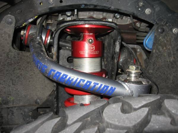

    I'm a 4x2...
    I'm running Camburg Coilovers with Total Chaos (TC) UCAs (see pic above)... :D

    that's it... and just to review:
    Camburg Coilovers set at 2.5"
    Swaybar relocation kit (comes with the coilovers)
    Total Chaos UCAs
    Alcan 2" Add a leaf in the rear with Bilstien 5125 shocks.
    that's it... :thumbsup:
