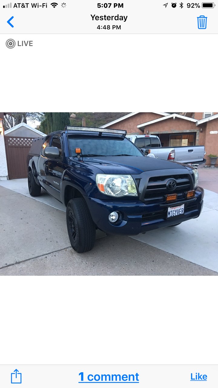

    I had the clear coat coming off and used carbon fiber vinyl wrap to cover it. Works great. B584F780-D410-4CB0-9778-EF446B27416A.jpg
