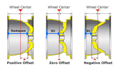

    So since my new wheels have 4.5 does this mean more clearance or less? I'm new to the offset/backspacing and honestly confuses me

    This is a good visualization.

    2010 Tacoma TRD
    Ok that makes things a little easier to understand. I'm just wanting to be 100% sure or as close to 100% that everything's gonna fit and not rub in reference to frame and steering components. I know I'll have to do some trimming and shaving on fenders just wondering about the parts you can't cut haha
