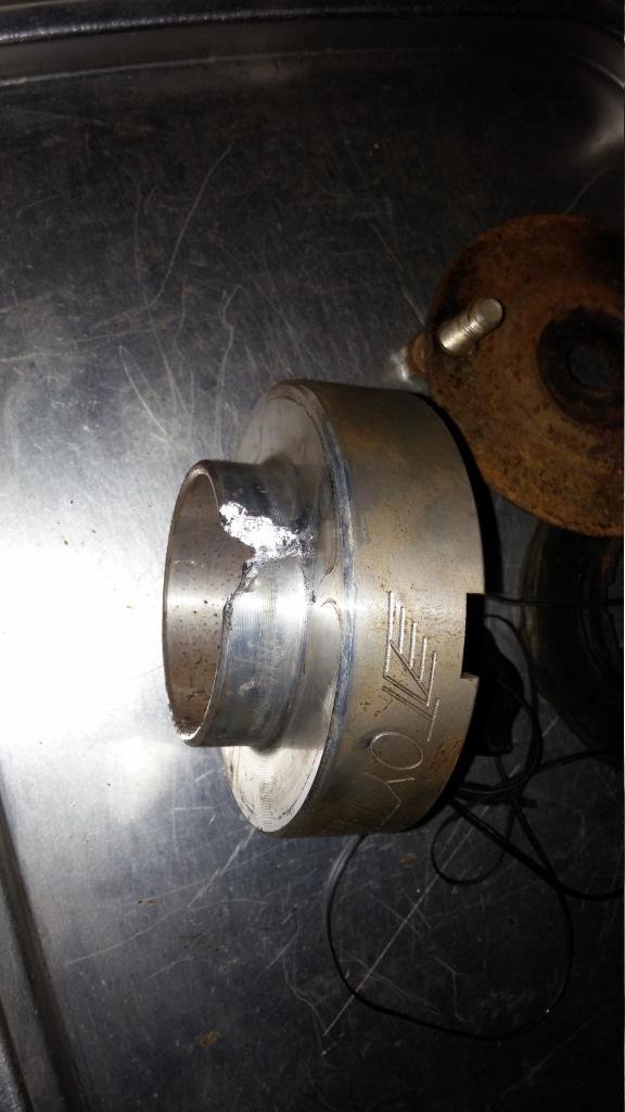

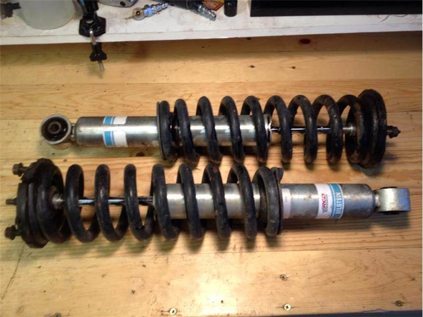

    I had some black steelies laying around so I mounted up my 31" all seasons that were on the truck to them as well as installed the spacer lift I had.
    The spacer lift was short lived- I noticed the threads to the passenger strut were in bad shape when I installed them, it looked like they were stripped pretty bad and someone used a die to straighten them out the best they could.
    Anyways the threaded part on the top of the strut let loose causing this.
    Oh well, I needed a real lift anyways...

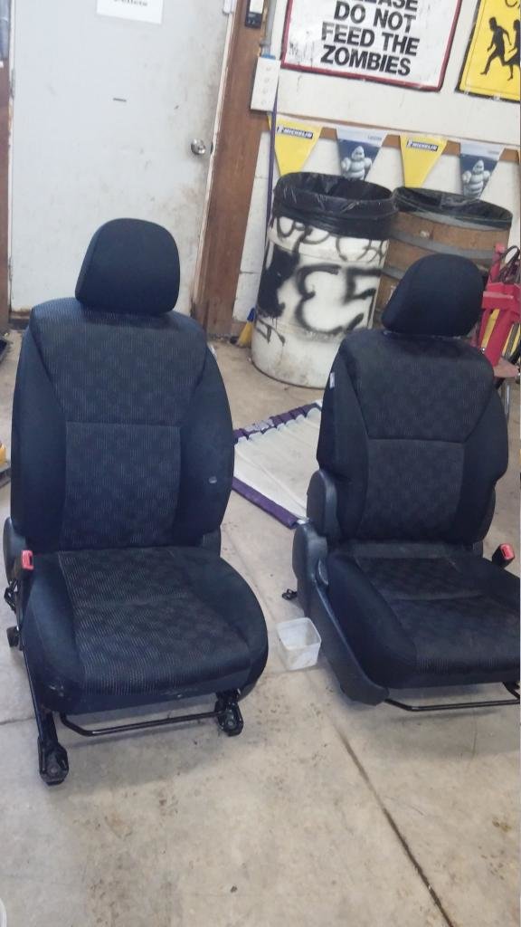

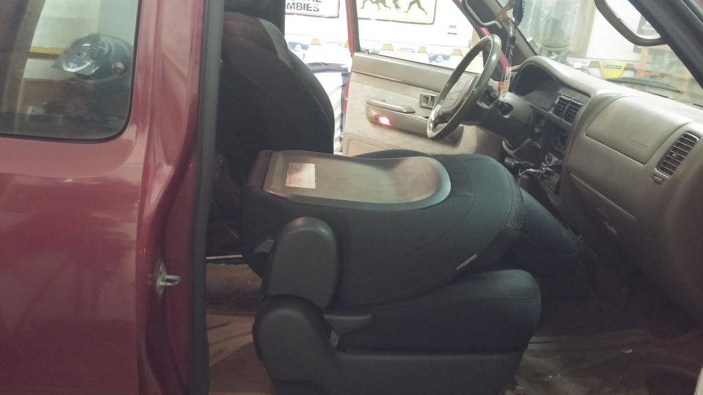

    The truck pretty much stayed in the shop while I was figuring out what to do about some,new front suspension. I figured this would be a good time to do a few other things.
    I picked these up at a local scrap yard for $50 they came from a- i believe 2012 or 2013 vibe/matrix
    Got the brackets fabbed up, man they are alot better than the stock 60/40

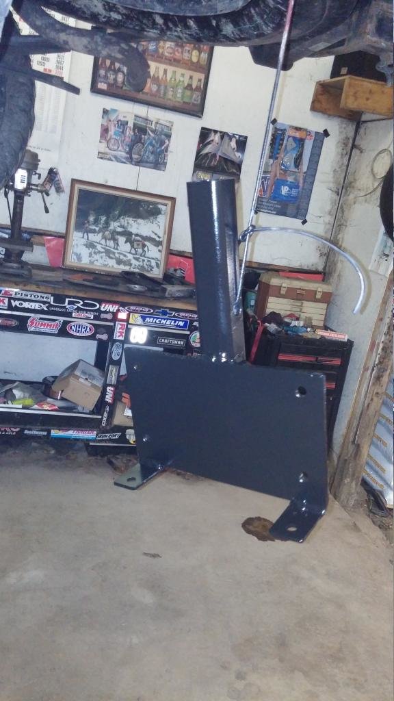

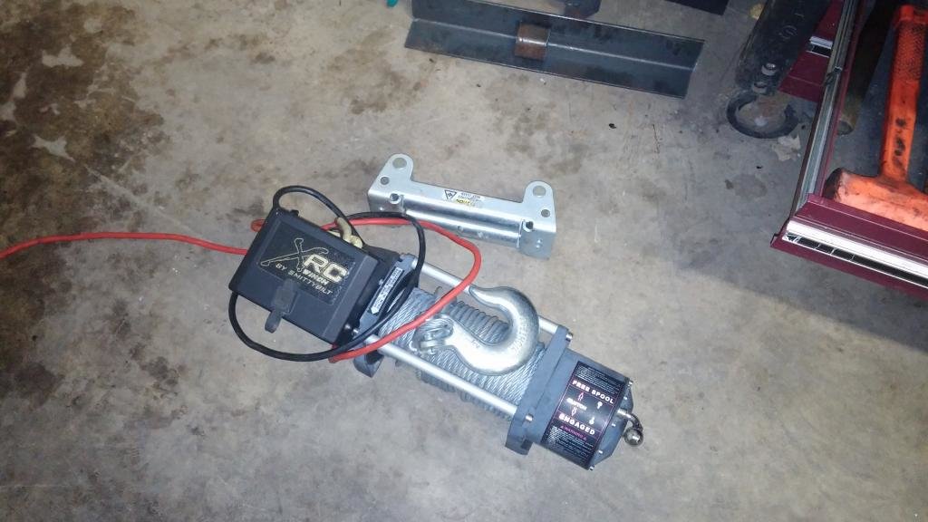

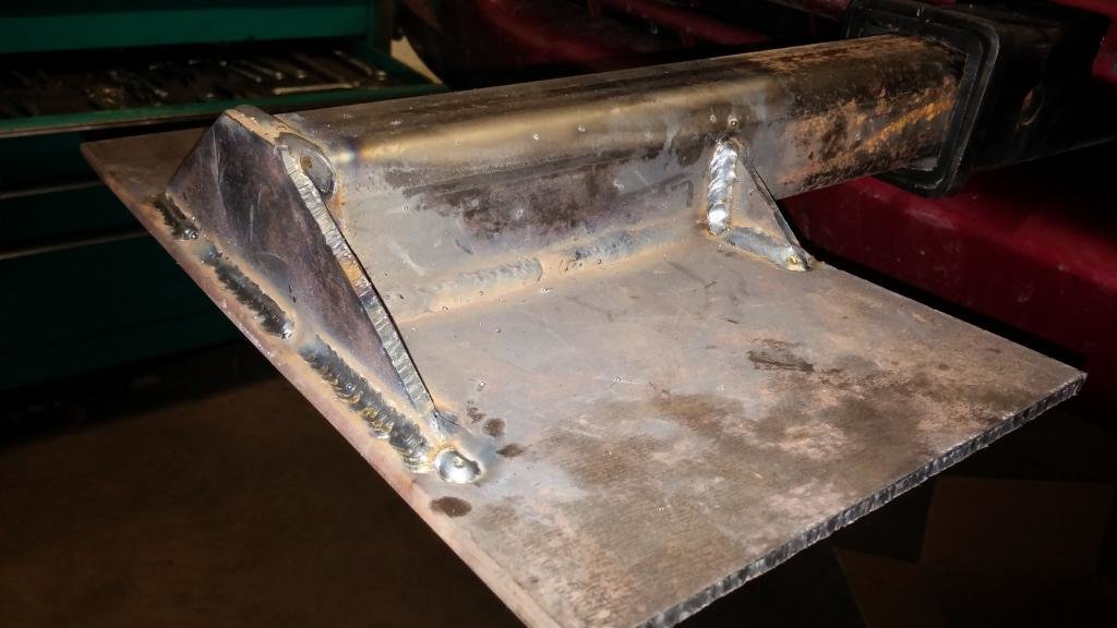

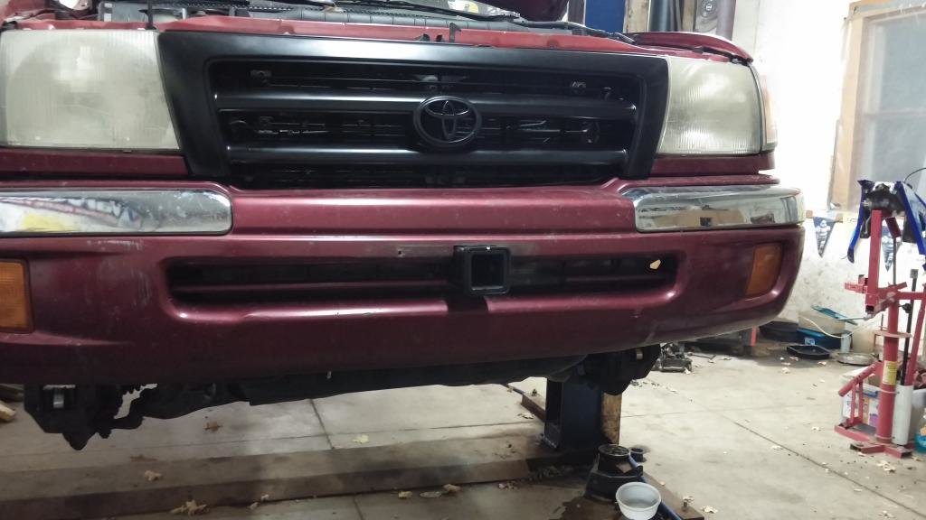

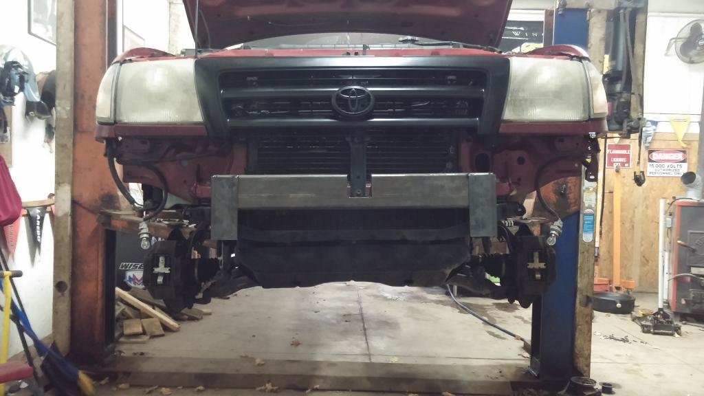

    I decided I wanted a winch as my last rig had one and I really missed it, not just for wheeling but theyre pretty handy for,other things also.
    A $1,000 bumper wasnt in my budget so I opted for a front mounted reciever.
    Off the shelf ones were chincy and $200-300 not to mention they sit super low on the front of the vehicle.
    Time to fire up the welder and plasma cutter...
    This is what I came up with for a high clearance reciever. Its leaps and bounds stronger than the off the shelf ones I looked at.

    Started on the winch plate

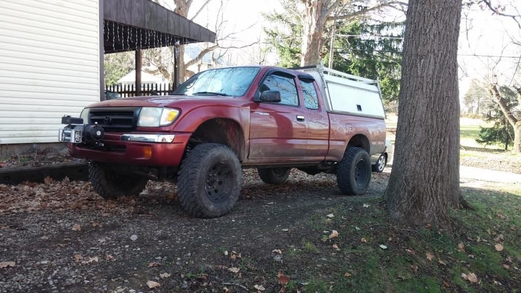

    'llI had a couple nice mt 31's I bought on cl over a year ago for $30 that were 70% tread. I had been searching off and on since I got them for another pair. After a year of looking I found another pair on cl for $50.
    I used my harbor freight manual tire changer to mount them up to my steelies. I need to get them balanced yet still to this day. Anyone ever used airsoft bb's to balance tires?
    Ended up finding a cap on cl also. Usually if I haul something I use my tunda so the topper will probably be on here for quite a while. I plan to do some camping in the taco this upcoming summer. The cap has a toolbox mounted inside that im thinking about mounting an auxillery battery in and running an inverter with some outlets in the back.

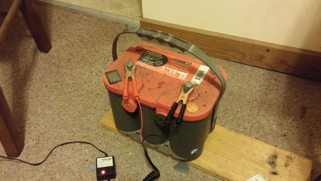

    While at a buddys house last night I noticed this red top sitting under a work bench.
    I asked him what was up with it and he said it was in a vehicle he had and sold, said it wouldnt hold a charge so he figured it was bad, told me to take it home with me as it was headed to the scrap yard.
    I left it on the charger overnight, when I woke up this morning it was at 11 volts, i checked it around 2pm and it was at 13.4 im hoping its good- ill test it out tomorrow.
    I plan to run dual batteries. Im not sure if I want to run them in series or use an isolater.. I need to do some more research on it as well as a good spot to mount the 2nd battery.

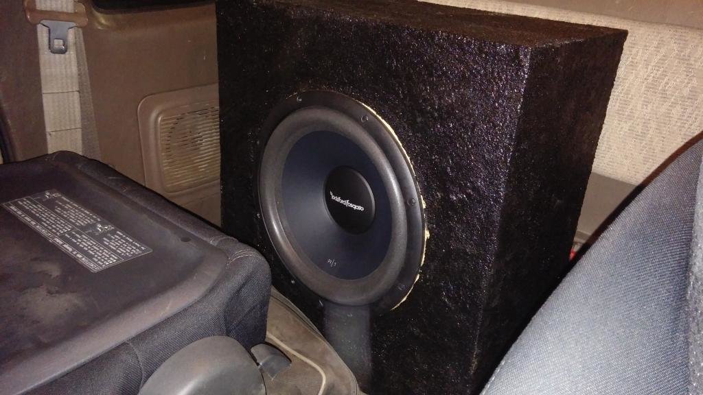

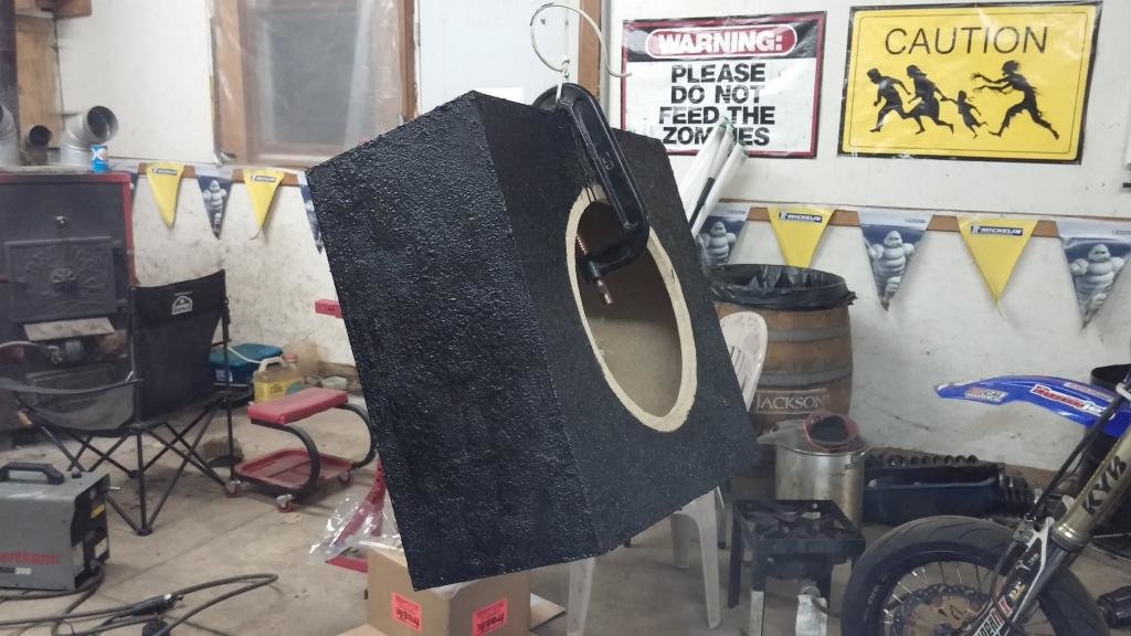

    Decided on building a box for the sub.
    I found a sheet of 1/2" particle board at menard with a busted corner for $4.99
    I would have liked to use 5/8 or 3/4 but whatever.
    I sealed it up inside with liquid nails construction adhesive in effort to reinforce it a bit.
    I thought about using marine grade carpet to cover it witb but after pricing it out decided against it.
    I had half a gallon of herculiner from a previous project from back in 2009.
    Honestly the stuffs garbage on the exterior of an automobile imo and I had thought about trashing it a few times. Well, I decided to put it to use and coated the exterior of the box with it.
    I just use a handheld circular saw to make the box and there was a few imperfections in my cuts Herculiner did a good job at hiding those. still have to go to RadioShack and pick up some speaker terminals before I can finish everything up I had some wiring laying around and some RCA cables so thats $$ i wont have to spend.

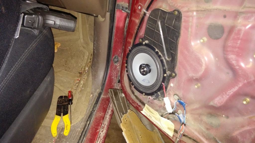

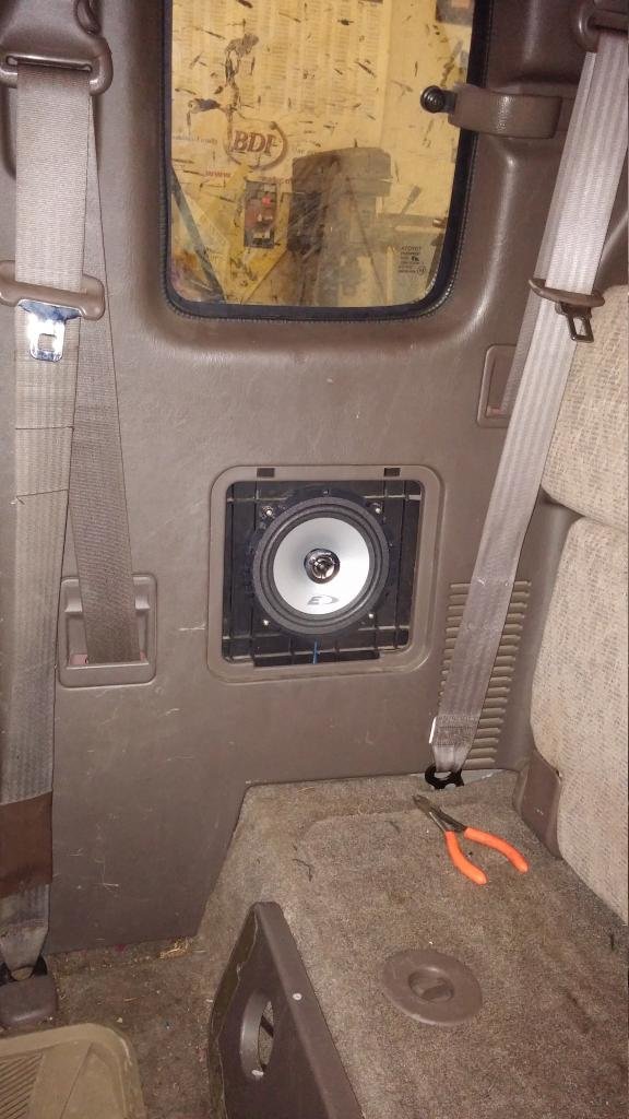

    Few pics of the coax speaker install.
    Would like to have had a component set for the doors but for $18 these will have to do.
    They sound alot better than the factory speakers.

    Still need to paint around the hole where the sub mounts. Didnt want to use the herculiner around the perimeter as it would effect the sub sealing to the box.
    I used a 2 channel kenwood amp I found on cl for $25 that pushes 150 watts rms bridged. Seems to work ok.
    Im not big on having a huge sub back there but the price was right and it will do until I can find a good deal on some shallow mount 8"s to put under the seats.
    On a side note, installed the optima red top last night. Seems to be a good battery. Started the truck right up today without any effort.
