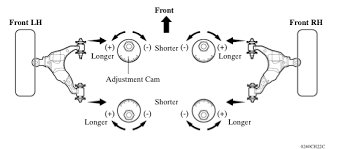

    #22

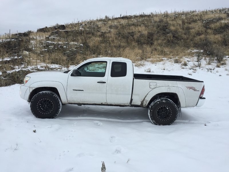

    FinnJ
    FinnJ Well-Known Member
    Sep 22, 2016
    #197981
    688
    Finland
    2007 FJ Cruiser 6M/T
    TRD SC, UCON, CNG conversion, RC 6" (lifted 4"/3" air suspension) w/FOX 2.5, 315/70R17 Duratracs, RECARO seats, etc.
    Adjust the LCAs, there is about 1" play how much further the tire can be adjusted.
