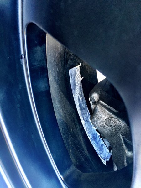

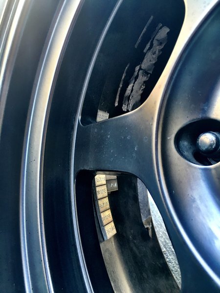

  20. Jul 28, 2016 at 12:56 PM
    #40
    Josh S
    Josh S [OP] Well-Known Member
    Sep 22, 2013
    #113017
    54
    Josh
    Topanga, CA
    2016 Tacoma Limited 4X4 DC & 05 Tacoma 4X4 Double Cab
    05: Big Tires, Big Black Wheels, Leveled and raised a couple inches, Extra leaf in the back 16: Stock. For now.
    No lift, the suspension is stock.
    I went back to a different America's Tire to try one last time. It's actually much better as far as I can tell. They made a mess of my wheels and didn't clean them up, but at least it's on the backside of the wheel and not super visible. Don't think I'll be buying tires from America's Tire any more. IMG_3457.jpg IMG_3456.jpg
