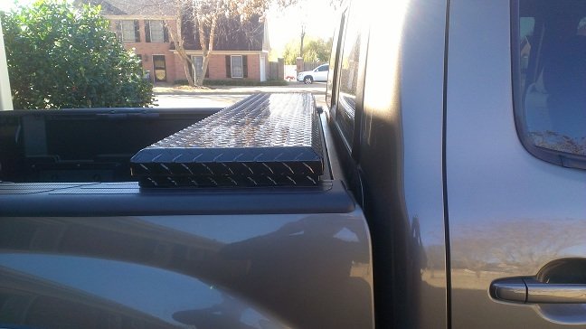

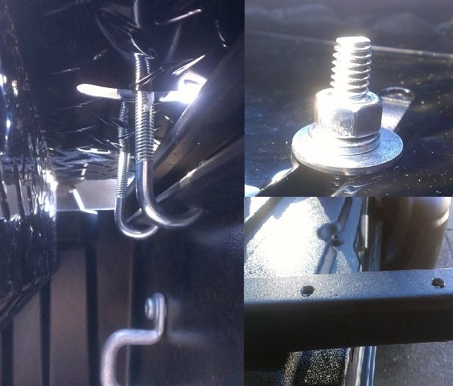

    I installed mine with 5/16 x 3" long J-hooks from Lowe's. They were about $1 each. I put a washer and lock washer on there before the nut. I took the bed rails off of each side (4 screws) and drilled 5/16" holes in the bottom of it where I wanted the J-hooks to grab. Before doing that, I placed the box on the bed rails and marked the accessory rails with a dot using a permanent marker so I would know where the toolbox slits were. My toolbox came with slits already cut in it for the J-hooks (top right pic), so I needed to line it up with a hole in the rails. I just tightenend the nuts down to the point that the box metal started bending. Make sure there is some rubber or foam padding between the box and the rails.
    Pictured below: J-hooks under rail (left), inside the box with washers and nut (top right), and accessory rail where I drilled two 5/16" holes (bottom right).
    Edit: I had someone ask me about drilling holes in the rails. They are made of metal even though they appear to be plastic. They are strong and will hold the box fine. If you tighten the toolbox down too much, the box will break before the rails bend.
    Here's a side view of the (Lowe's) Kobalt toolbox that is about 61" Long x 12" Wide.

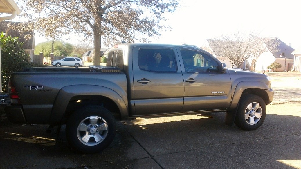

    And here's the overall look of the truck. I think this narrow Kobalt toolbox is perfect for the doublecab short bed Tacomas. I only have a 5 ft bed, so a 1 ft wide toolbox looks perfect.
