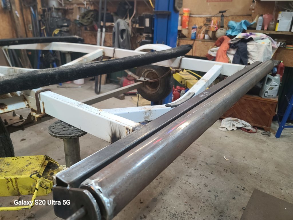

    Got the roller fabbed up. Should make it easier to drop/load the raft at unimproved boat ramps.

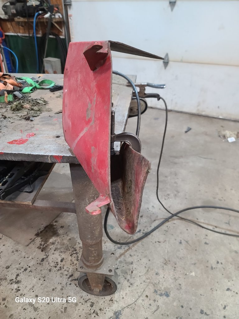

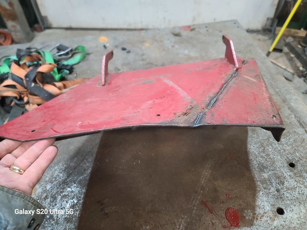

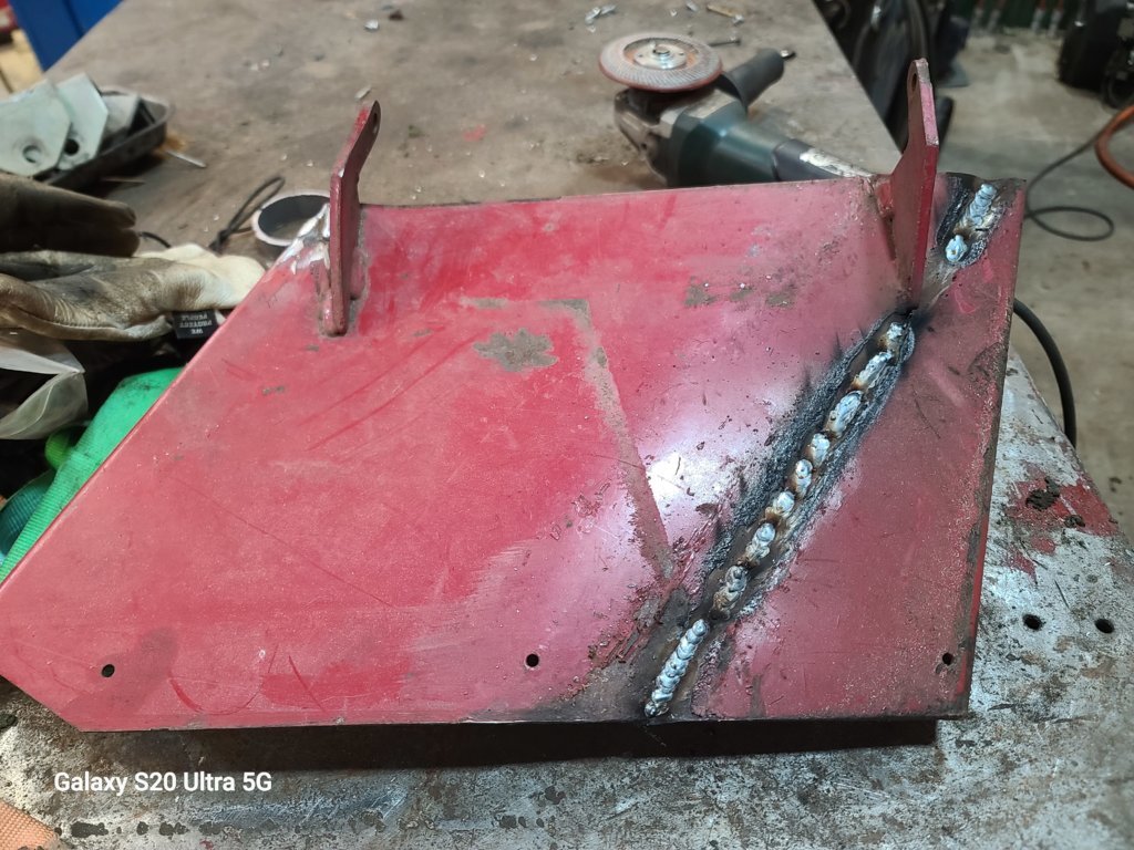

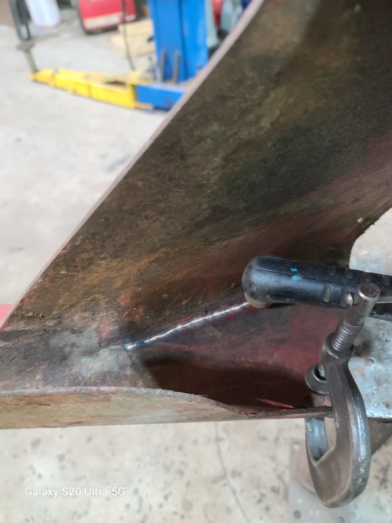

    Customer of mine bent the shit out of his grass deflector.
    Asked if I could bend it back.
    The 10 gauge iron was stubborn and resisted me beating it into proper shape.
    Is was no challenge after I made some relief cuts with the plasma cutter.
    A quick coat of paint and it's ready for the customer to bend it next season.

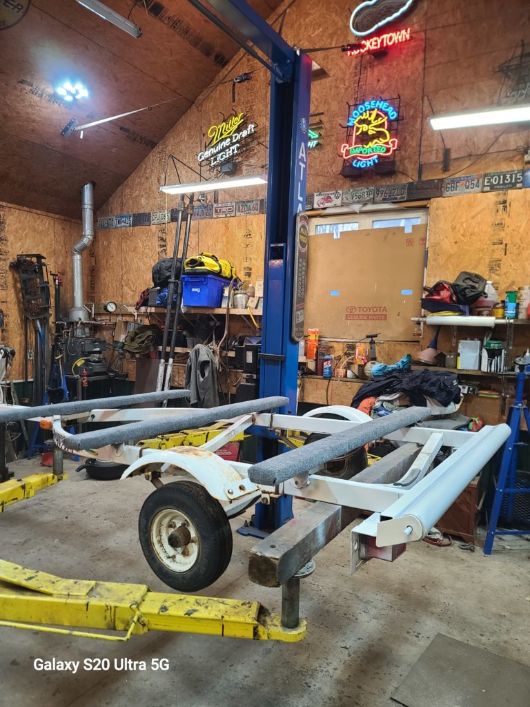

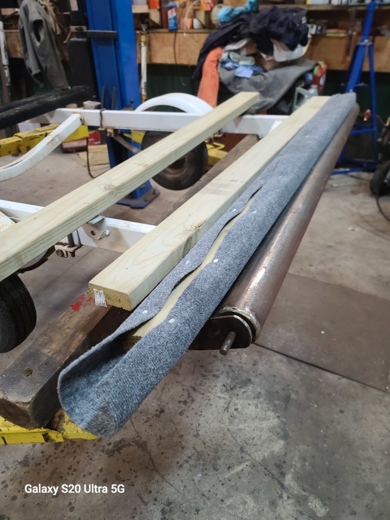

    Finished up the river boat trailer.
    Hope to deliver it Monday.
