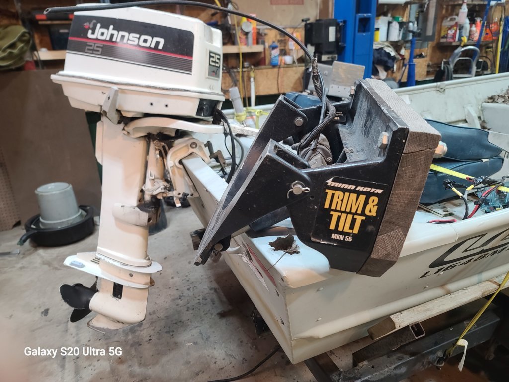

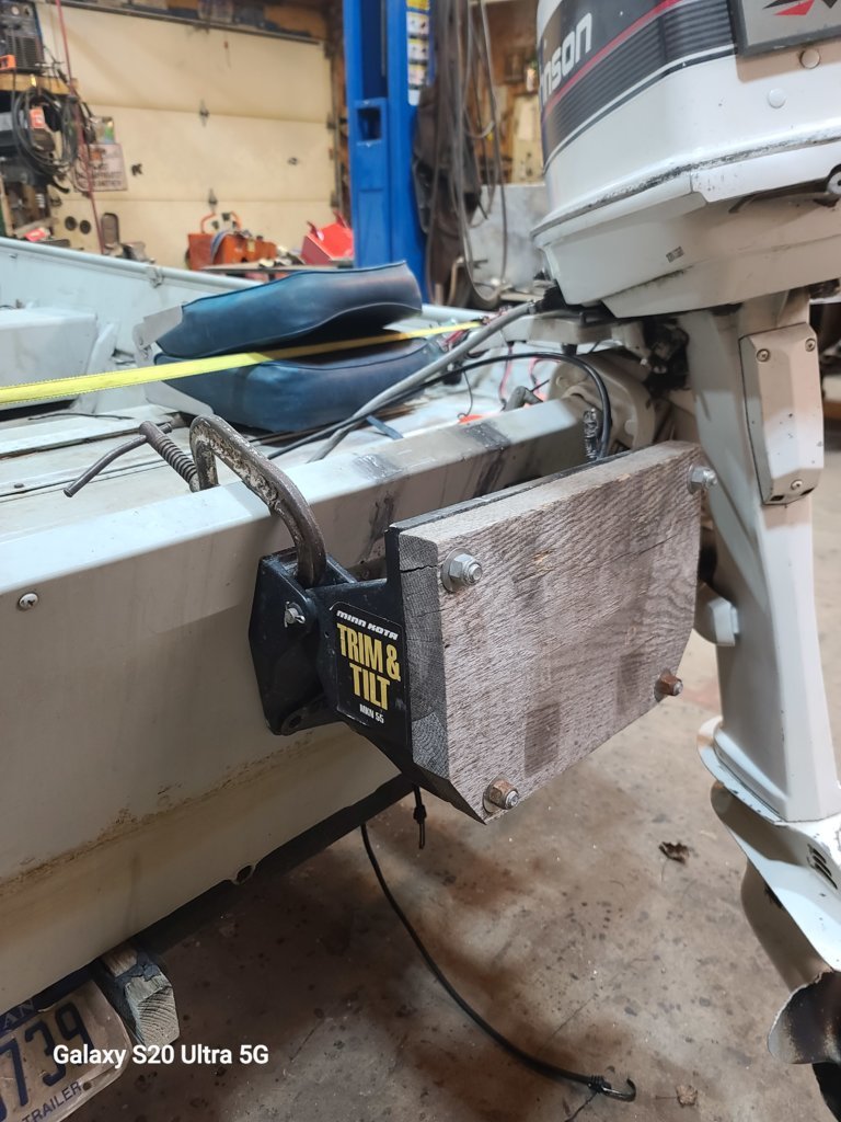

    Bud has a Jon boat with a small outboard. the motor has no tilt/trim feature and there was no factory version available for such a small engine.
    Fortunately the aftermarket industry has a solution.
    These panther lifts work great and they take up little room.
    I just started the install.

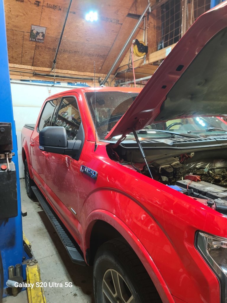

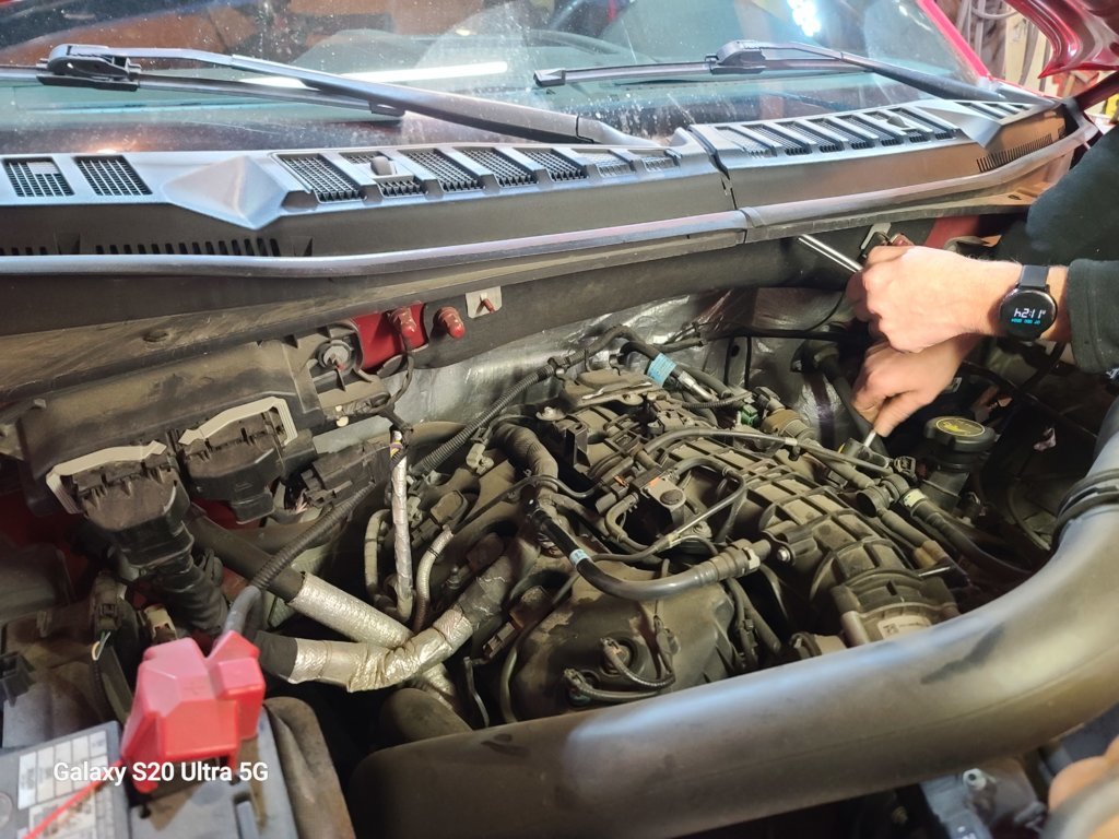

    New plugs on a '16 TT FISO. Owner says getting misfires under WOT load.
    Plug gap is to be .027-.033.
    These were all .037-.040.
    New plugs and the misfire is gone.
    I have to say, even though the truck is a Fuc, er, ah a Ford, the maintenance was fairly straightforward.
    The owners previous truck was one of those monumental pieces of shit Triton motors. I was worried the job was gonna be a 2 day nightmare.

    Nice, what motor was in it?
    six5crèéd and koditten[OP] like this.
  4. Dec 7, 2024 at 5:38 PM
    #244
    koditten
    koditten [OP] Well-Known Member
    Sep 8, 2013
    #112077
    19,713
    Kirk
    Central Michigan
    04 trd x-cab 4 x 4 3.4l
    Reserected from the dead.
    3.5 twin turbo Ecoboost.

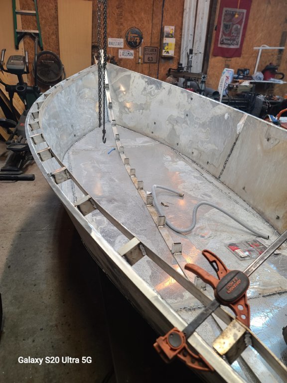

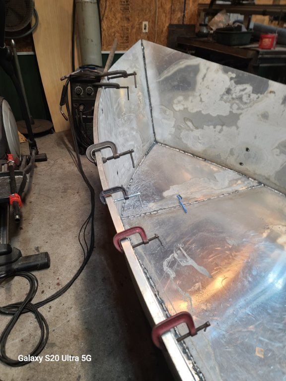

    A little boat progress.
    Tack welding on the gunnel tubing. Takes a bit of clamp work to make the tubing follow the hull shape.

    upload_2024-12-8_16-14-52.jpgjust about got it lined up.

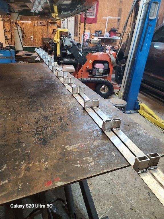

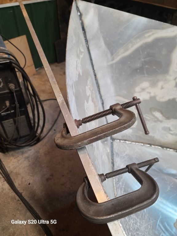

    This gets bent to the shape of the hull.

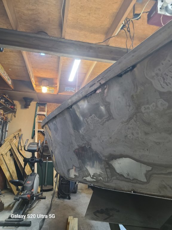

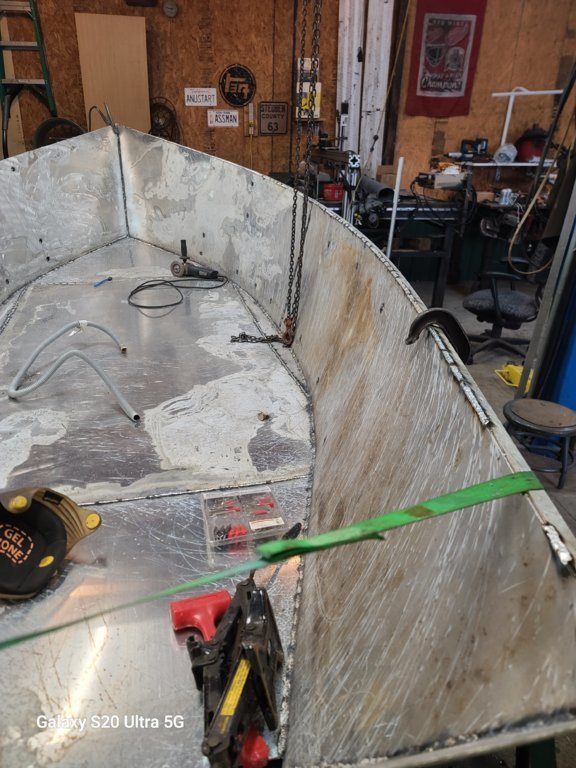

    Both gunnels tacked into place.
    Notice the green strap. When I tacked the left side in place, hull twisted ever so slightly. Was able to flex the right side down a smidge, the tack the gunnel in place.
    Boat is straight and rigid now.
    It is pretty stiff at this point, but will be getting more structural members that will make it even more rigid.

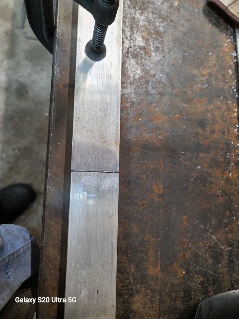

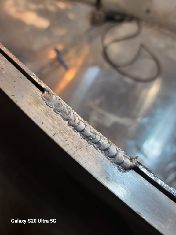

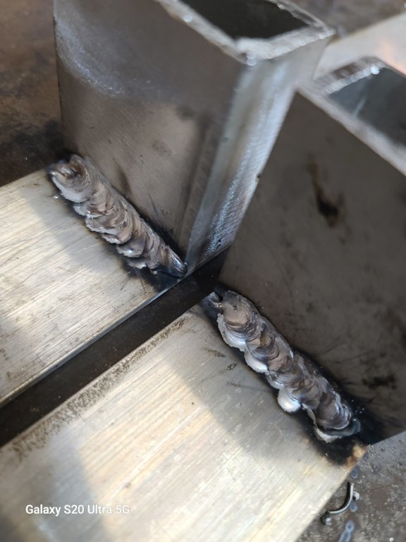

    Aluminum MIG spool gun welding will never look as good as TIG welding, but I think my welds look pretty decent.
    Spool gun welding is amazingly fast. It took me about 45 minutes to make 35+ foot of welding.

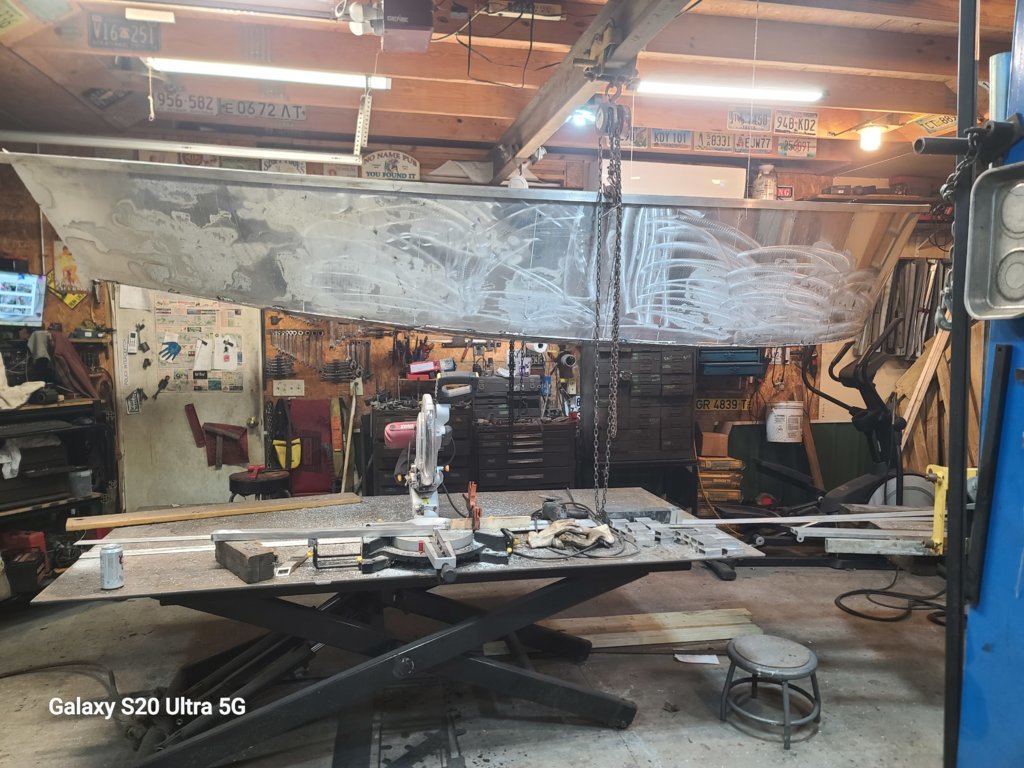

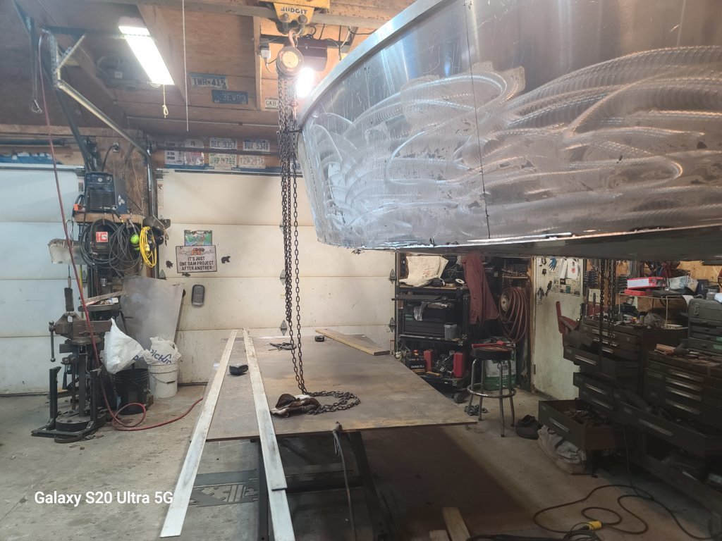

    Needed my work bench, so just hoisted the boat to the ceiling.

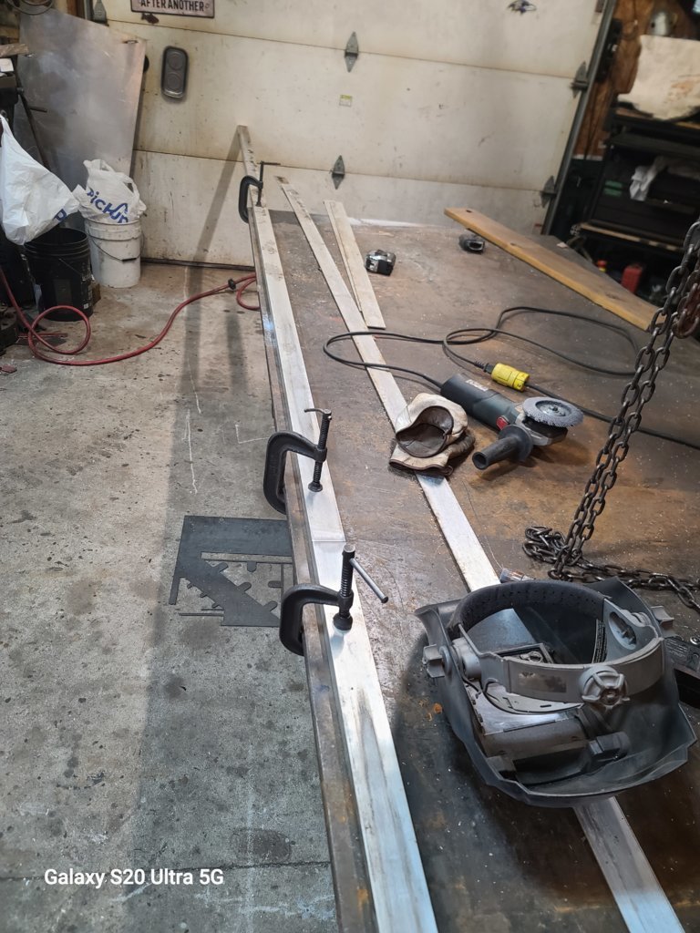

    Fabbing up the gunnel reinforcement. This step really makes the boat rigid. It also helps with tree collisions.

    upload_2024-12-13_17-26-19.jpgpic of the welds before the soot is removed. It's not TIG welding pretty, but it's not bad for blow and go spool gun MIG welding. It's getting painted, so who gives a shit?

    Starting to weld in the gunnel reinforcement.
    It's starting to look like a McKenzie drift boat.
