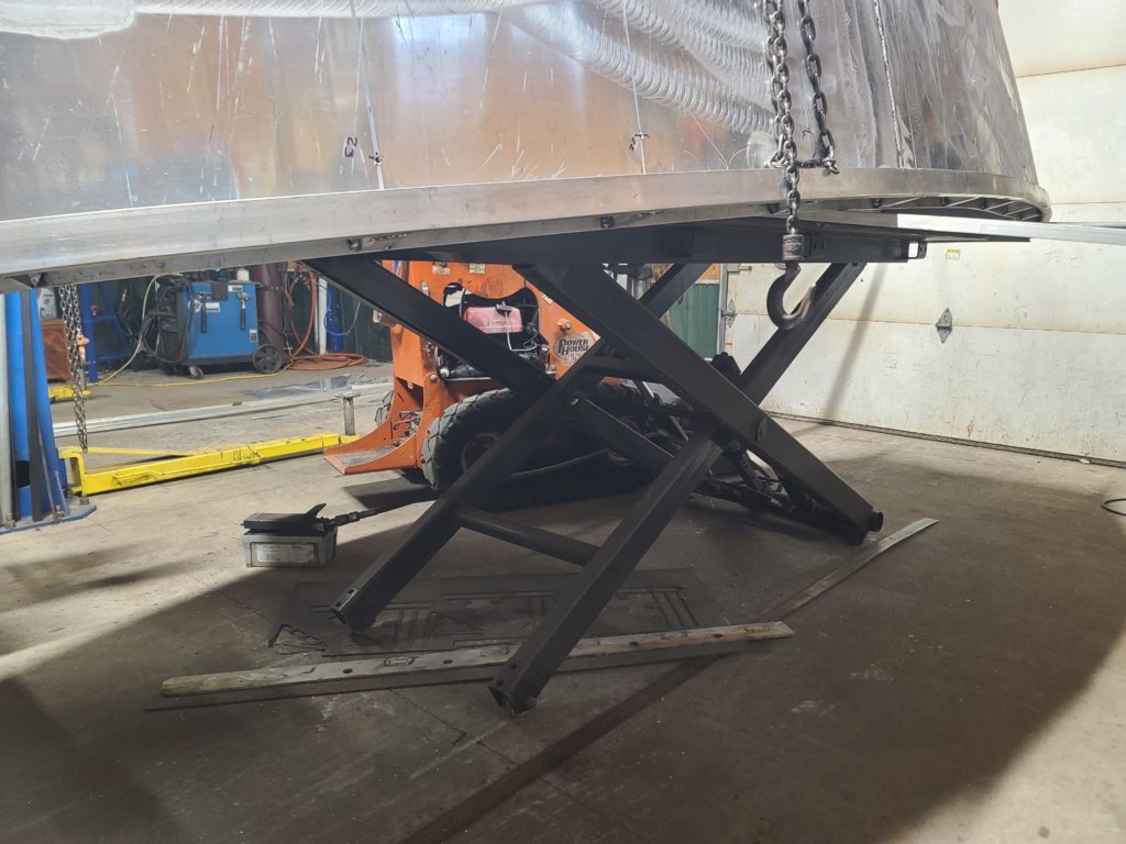

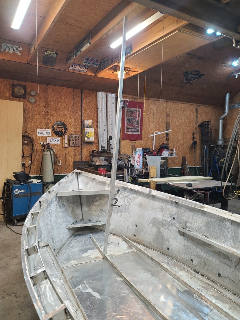

  11. Dec 27, 2024 at 5:45 AM
    #271
    koditten
    koditten [OP] Well-Known Member
    Sep 8, 2013
    #112077
    19,615
    Kirk
    Central Michigan
    04 trd x-cab 4 x 4 3.4l

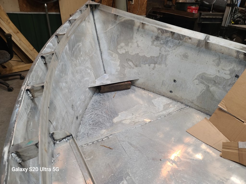

    Reserected from the dead.

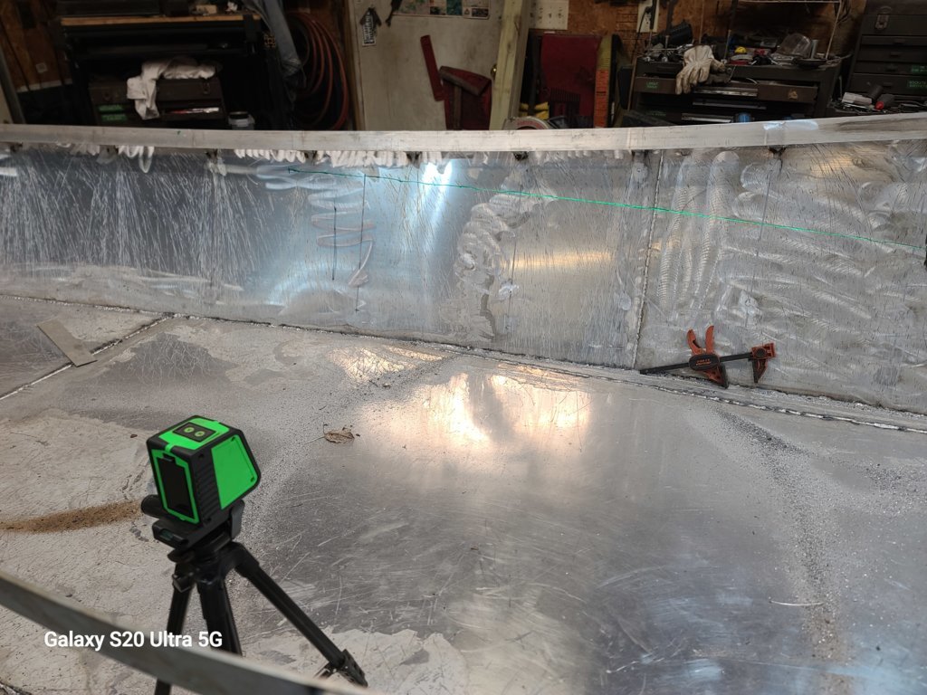

    Prepping to fab up the side shelves/lateral reinforcements.
    Cheap laser level to find horizontal.
    I positioned the boat on the lift as close as possable to its normal float height.

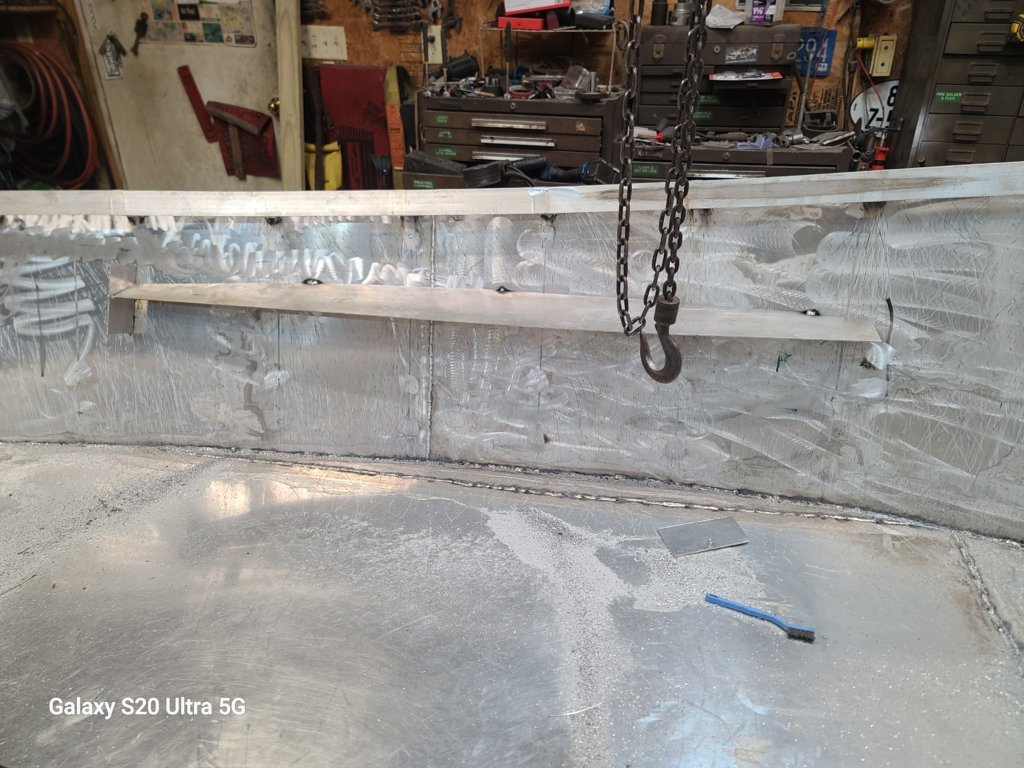

    Installed the side shelves.
    six5crèéd, soundman98, MarX and 2 others like this.
  13. Dec 27, 2024 at 5:55 AM
    #273
    koditten
    Sep 8, 2013
    #112077
    19,615
    Kirk

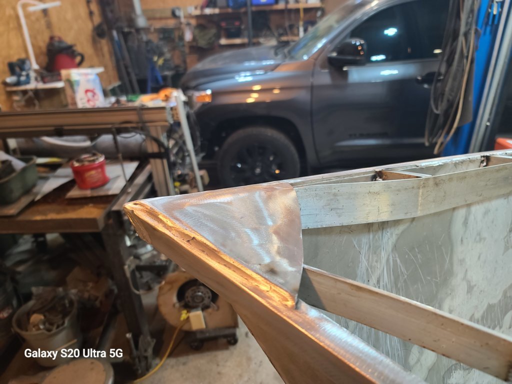

    Central Michigan

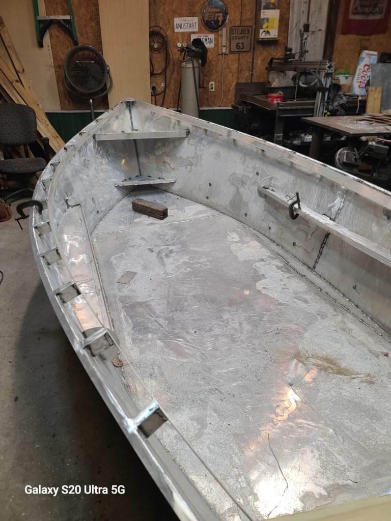

    Fabbing up front bow braces/shelves.
    This pic shows test fitting.
    six5crèéd, soundman98, MarX and 4 others like this.

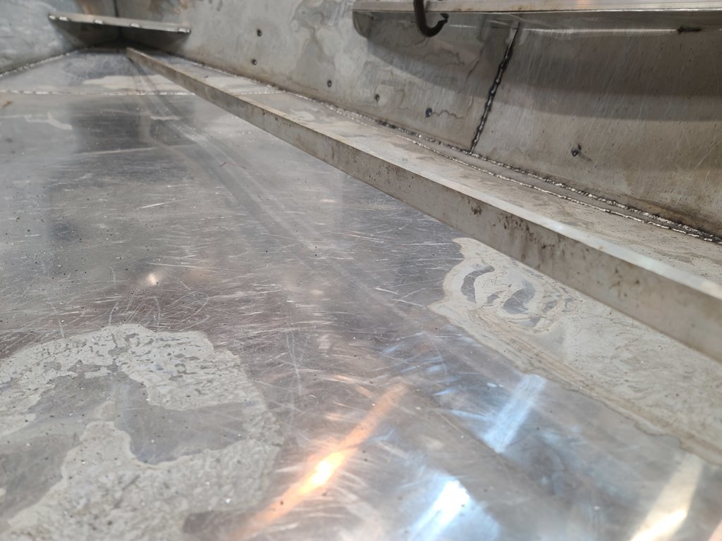

    Got the 2 bow braces/shelves welded in.
    The bottom shelves really isn't very big, but it is at a nice height to rest a foot on while casting. just like the pub foot rail. Takes some strain off the lower back when standing.

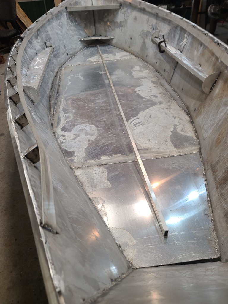

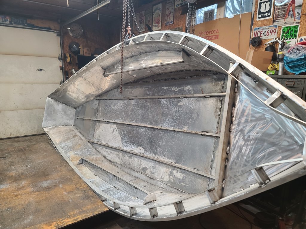

  15. Dec 27, 2024 at 6:11 AM
    #275
    koditten
    Sep 8, 2013
    #112077
    19,615
    Kirk
    Central Michigan

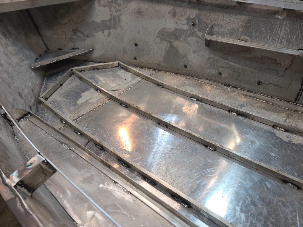

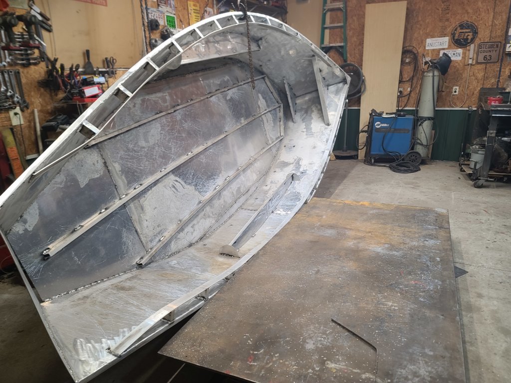

    Starting the floor supports.
    This part is a bit slow. The 3/4 x 2" rectangular tube must be flexed to match the bend of the bottom of the boat.
    It's a pain because of all the in and out of the boat making adjustments before the braces can be welded in.
    The second pic shows the amount of bend I need to put on the center brace.
  16. Dec 27, 2024 at 6:14 AM
    #276
    koditten
    Sep 8, 2013
    #112077
    19,615
    Kirk
    Central Michigan
    I use the lift table and a scrap piece of tubing braced against the ceiling joist to press against.
  17. Dec 27, 2024 at 6:25 AM
    #277
    koditten
    Sep 8, 2013
    #112077
    19,615
    Kirk
    Central Michigan
    The floor braces are welded in now.
    There will be foam board fitted into the space between the braces, then plywood wrapped with outdoor carpet bolted to the braces
    The foam serves 2 purposes. It helps keep your feet cool or warm as well as adds floatation in case of a capsize.
    The small pieces in the front are to prevent dropping and losing anything under the floor.

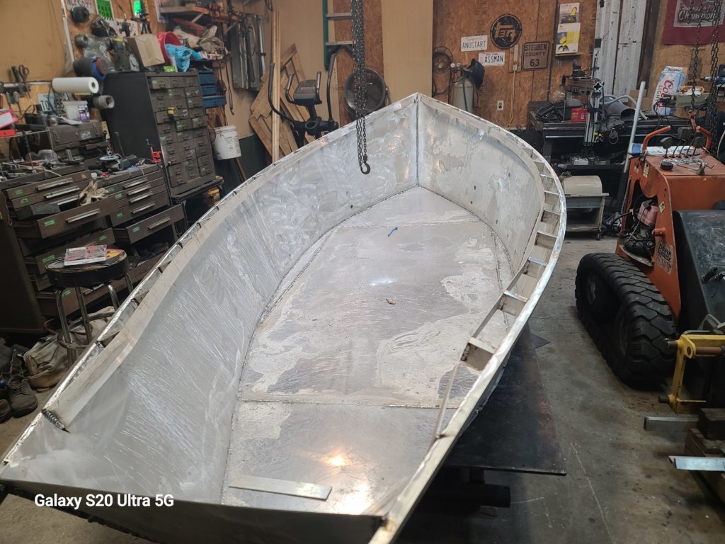

    Central Michigan
    Flipping the boat in preparation to weld on the trim pieces.
    Pretty much where I stopped.
    Stay tuned...
