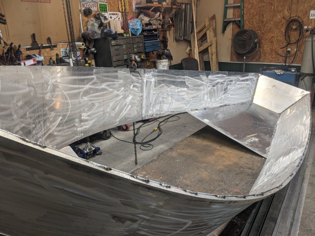

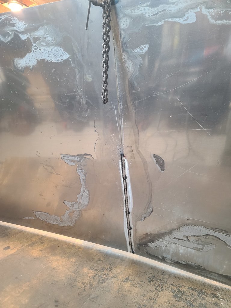

    Gave the side a quick sanding to find all the sins. The black spot is a filled hole that I had missed earlier.

    Much orbital sanding. My hands are sore big time.

    Finished up the stern... mostly. Still need to blank off the side lateral support ends.

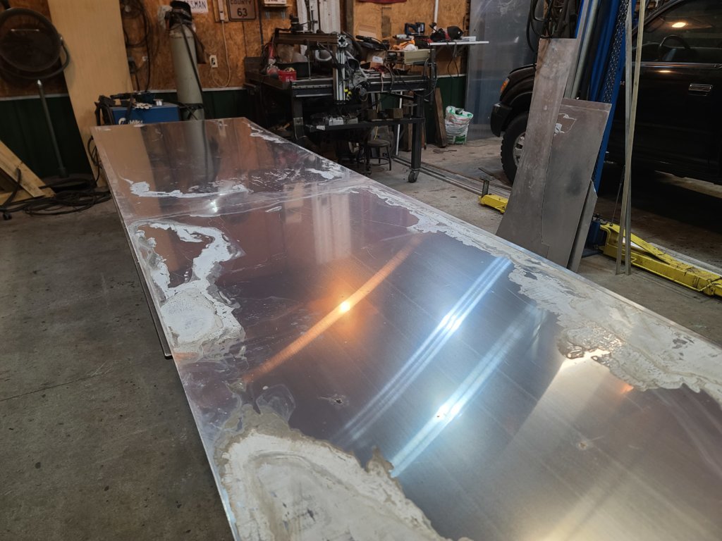

    Flipping the 2 sheets. They get to become the sides. I weld half then flip then weld the other half. This way the weld wi

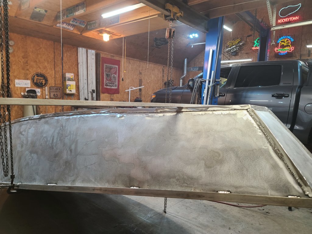

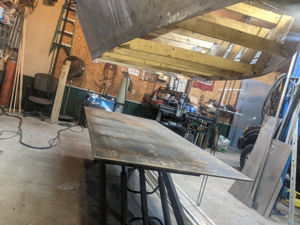

    Got the rough hull done. Lifting it so I can use the table to lay out more parts.

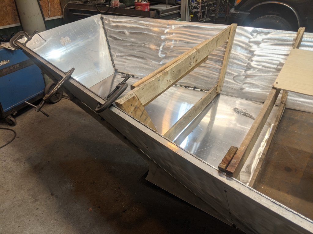

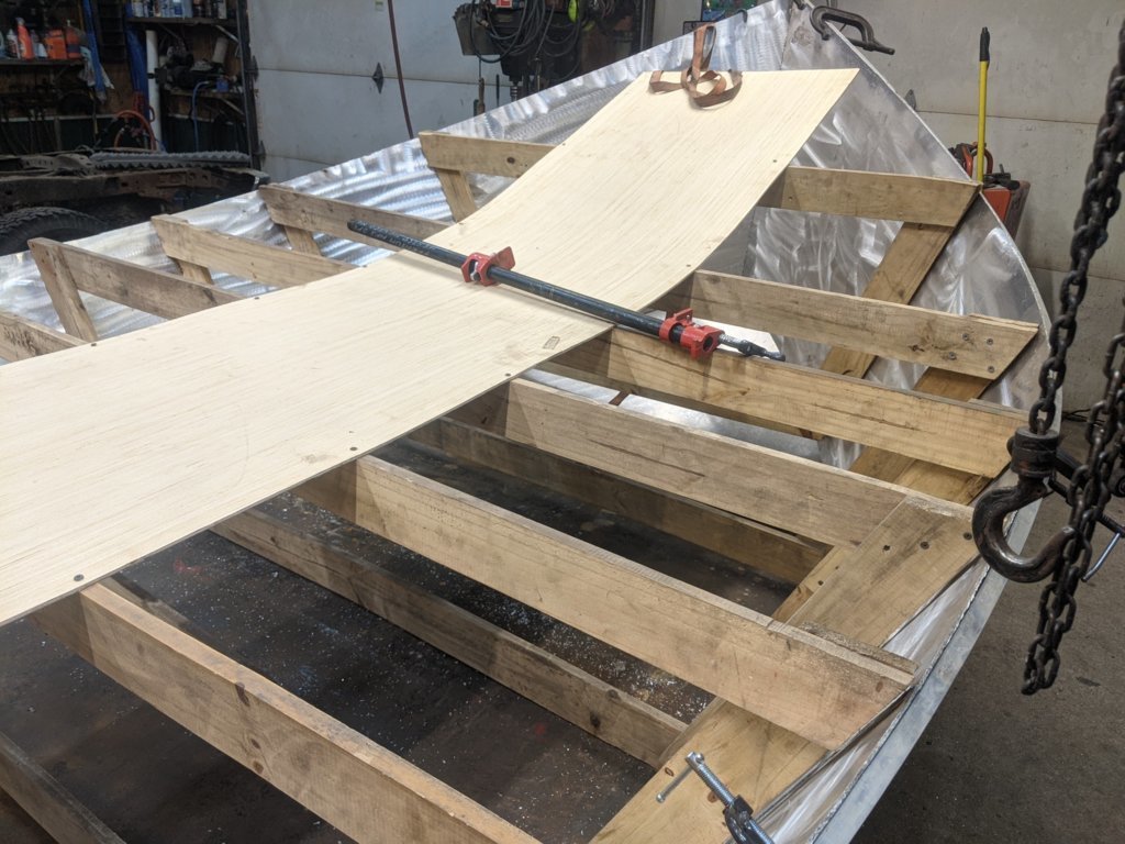

    Screwed down the anti twist panel to the forms. Aluminum wants to do some wild things when you weld it. Steps need to be taken to keep the boat from twisting.

    Heavy tacked in the rear floor piece. Its starting to get less flexible.

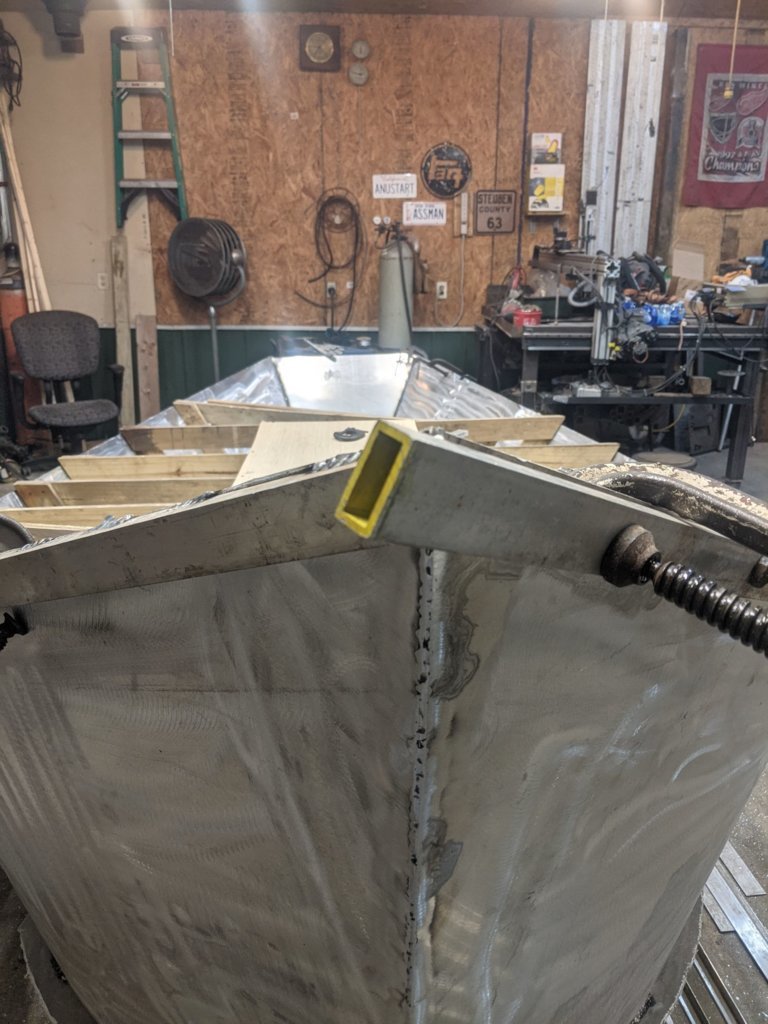

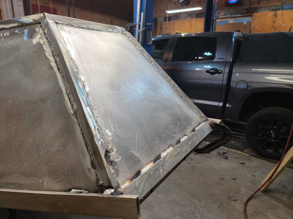

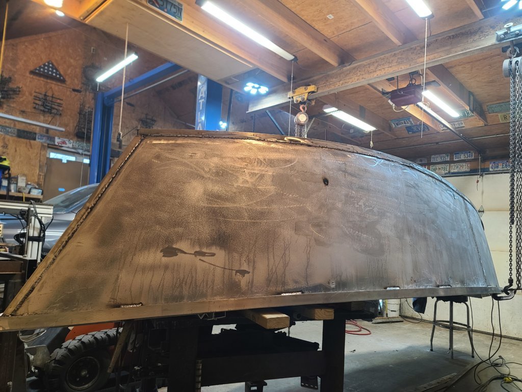

    Front floor panal tack welded in and the forms removed. The shape of the boat is pretty much set in stone at this point.
    Edit: Top rail/chine tack welded in. This realy starts to maske the boat rigid.

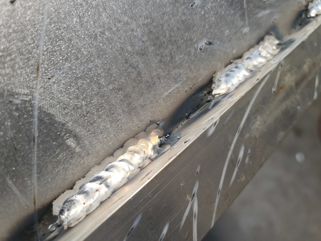

    Close up of the top rail/chine. 3/4 x 2" aluminumn extrusion clamped to the top of the boat side.
    You just clamp and weld and work your way from one end to the other.
    Its not hard, just takes some time.
    I think I used 6 C clamps to do the job.
