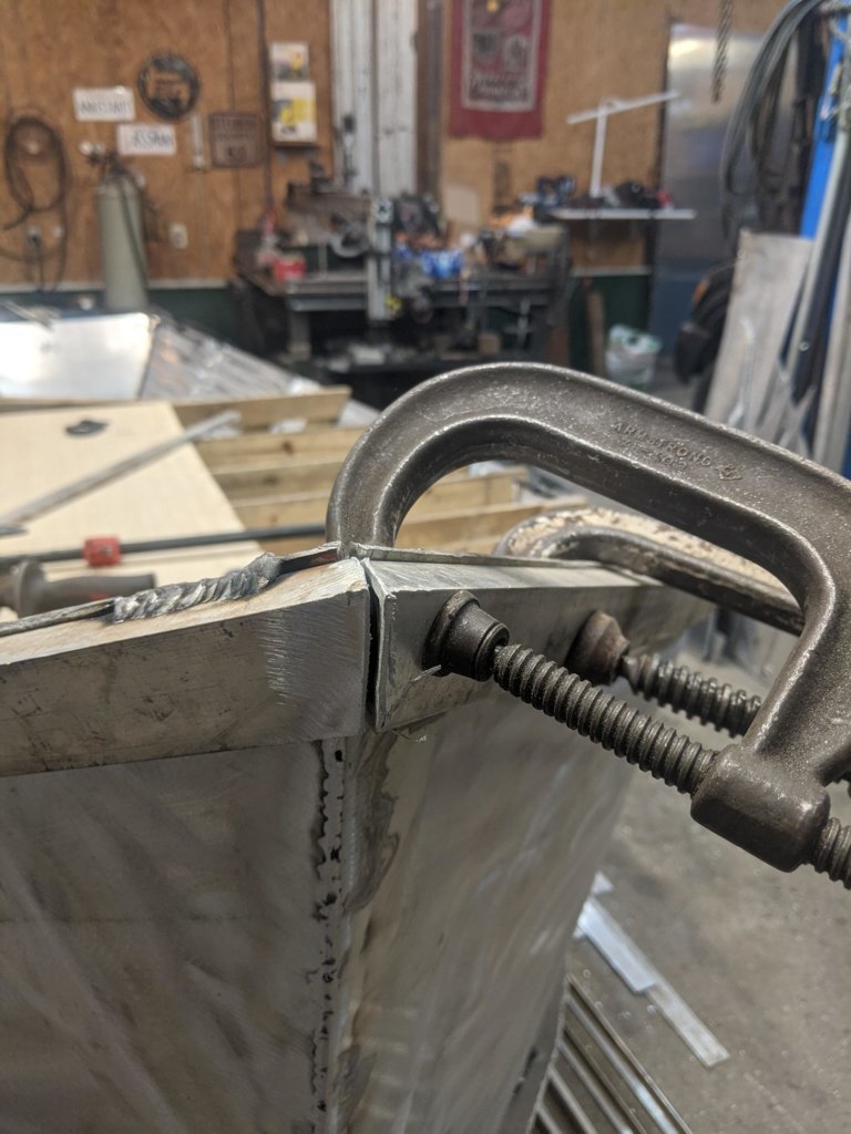

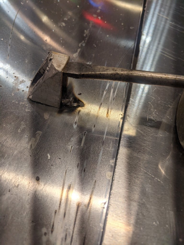

    Joining both chines at the bow after done flexing them the length.
    I cant lay out compound miter joints...I got the last one close and just thin disc cut it with the abngle grinder. Faq finish carpentry.

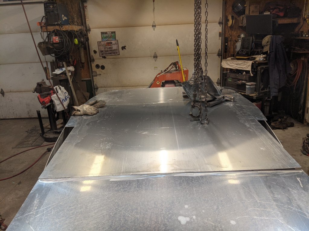

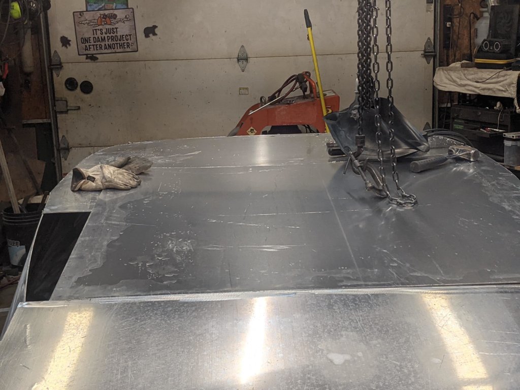

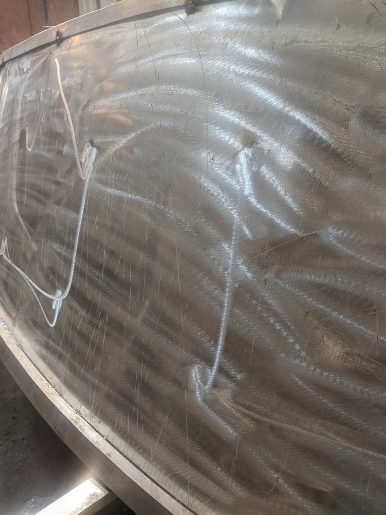

    Boat is upside down now. I didnt feel like sacraficing a complete 4 x 8 sheet of aluminumn to finish off the bottom.
    I went back and fourth. Do I want to section in a piece on both sides or section a larger piece on one side?
    I opted to to do a single, larger piece on one side. This is the bottom and no one will see it except me and those here following from home.
    You may have to zoom in to see the differnce because of shadows.

    Using a bit of scrap aluminumn to pry up the sheeting to match the sister piece.
    This is pretty much were I ended up for the day.

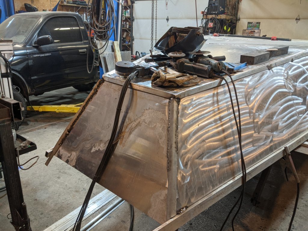

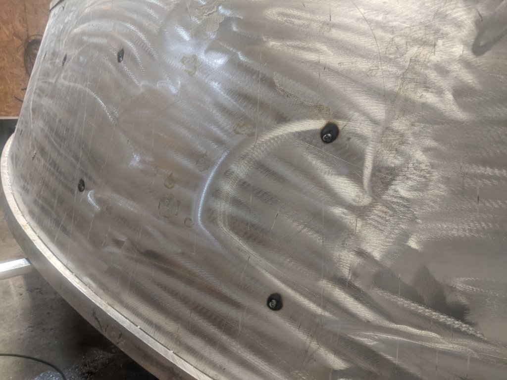

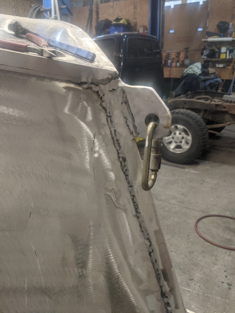

    Finished up welding the bottom chines.
    Installed the trailer winch eyelet.
    Welded closed the screw holes that were used for the wooden forms.
    Ground flat, can't even tell they were even there.
    Installed aft trim. Still need to find sand it.
    Just about out or welding wire, gonna make a hot lap to harbor freight.
