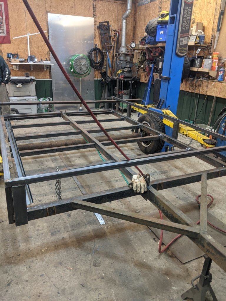

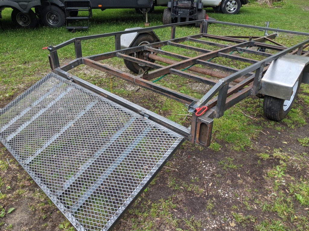

    One of my best buds' step son scored this trailer frame and axle off the Internet.
    The axle is from a mobile home, so it's heavy as fuck. The frame was welded together by a very skilled welder, but they weren't no utility trailer builder.
    The deck sat 30" off the ground when it showed up. I knew this was gonna be a nightmare job.
    I flipped the axle so it is now slung above the springs. This lowered it 3".
    I removed the 4" sub frame that the spring hangers were welded to. This dropped it 4".
    The spring hangers were some bastard, home made, janky things that were 5".
    I installed som standard 2" hangars. We are now at 20ish"
    I wish when people bought something, they didn't tell the seller " I know a guy" that can correct the fabrication mistakes.
    I'm tired of being " that guy".

    Are those scabbed in sections of tubing on the cross members? Oops.

    Yep, some interesting fabrication, to say the least.
    It's 1/8" wall tubing. Pretty stout. Makes the trailer very heavy, but with those mobile home springs, the extra weight is good.
    This is intended to haul a side by side ATV.

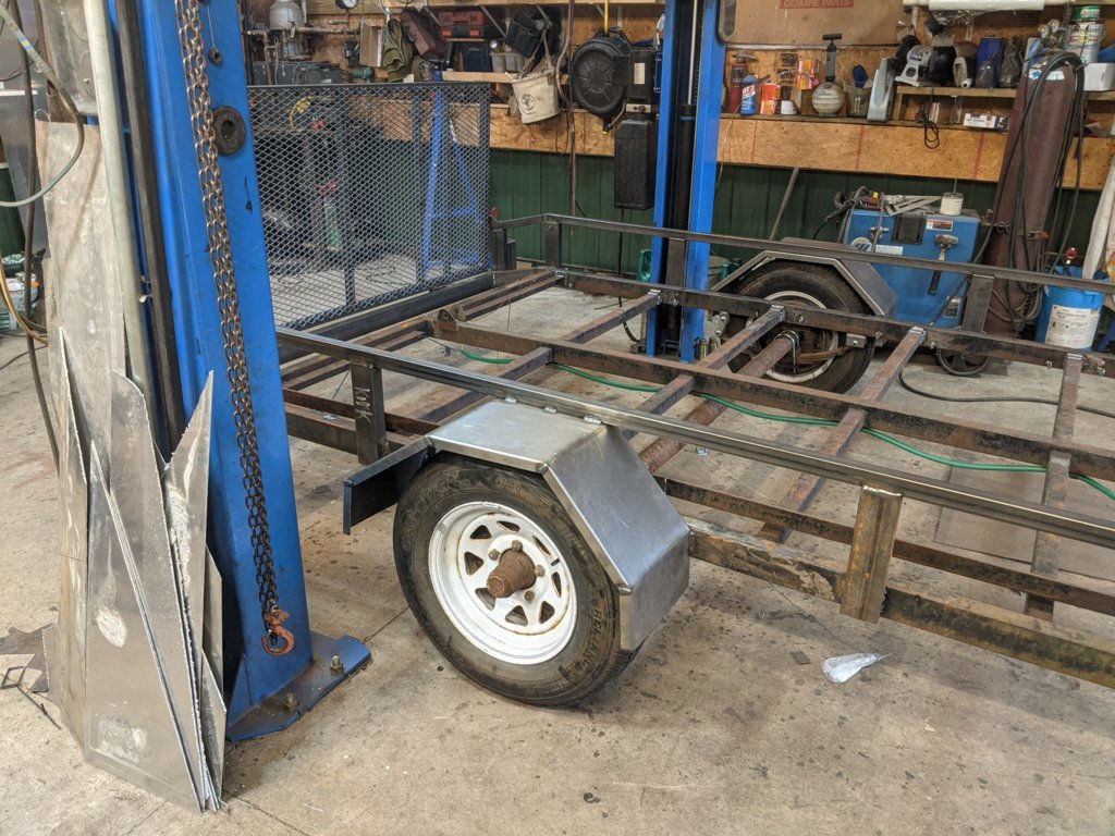

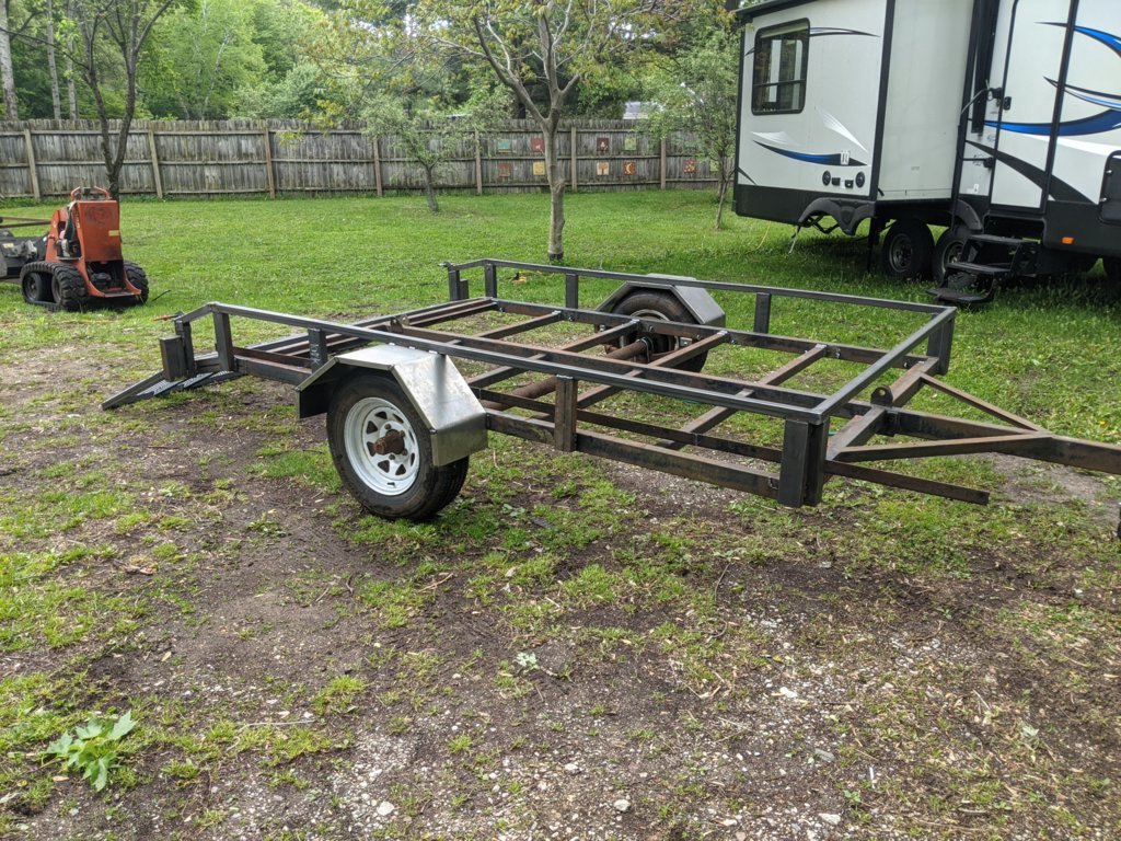

    Got the fabricated fenders mounted. I order 48" x 10" x 1" channel bent out of 16 g. Sheetmetal. They are heavy duty enough that you can stand on them.
    The bender read the prints wrong. They gave me 12" wide fenders with 1" flanges. I asked my bud if he wanted them rebended? His answer..." Fuck no, the step son hasn't lifted a finger on this project. He gets it as is.
    I was sweating a bit. I only had 1/4" of gap to get it out the garage door.!

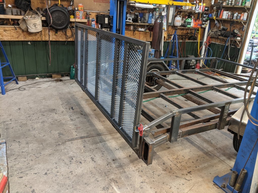

    The ramp gate turned out quite nice. The beaver tail deck makes the loading angle much more reasonable.
  7. May 22, 2025 at 5:52 PM
    #367
    koditten
    koditten [OP] Well-Known Member
    Sep 8, 2013
    #112077
    19,728
    Kirk
    Central Michigan
    04 trd x-cab 4 x 4 3.4l
    Reserected from the dead.
    Ramp gate lowered: I think the angle is not so steep, even short lawn mowers could load without scraping the bottom of the deck.

    Another angle.
    Not bad for 3 afternoons' work.

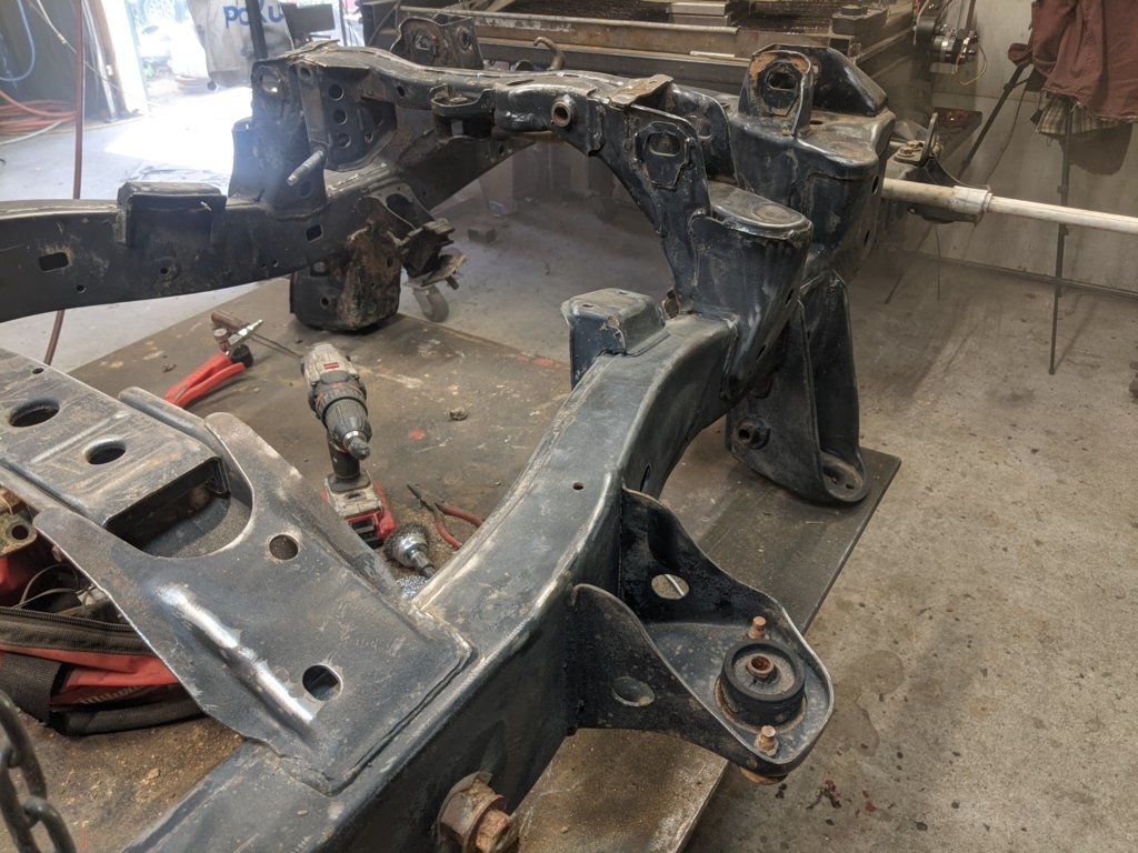

    Wire wheeling the wife's truck frame.
    Rust free Tacoma standard cab frame from the south.
    No rust on the thing, but lots of sand packed into closed sections.
    MarX, SACTOWN, RustyGreen and 2 others like this.

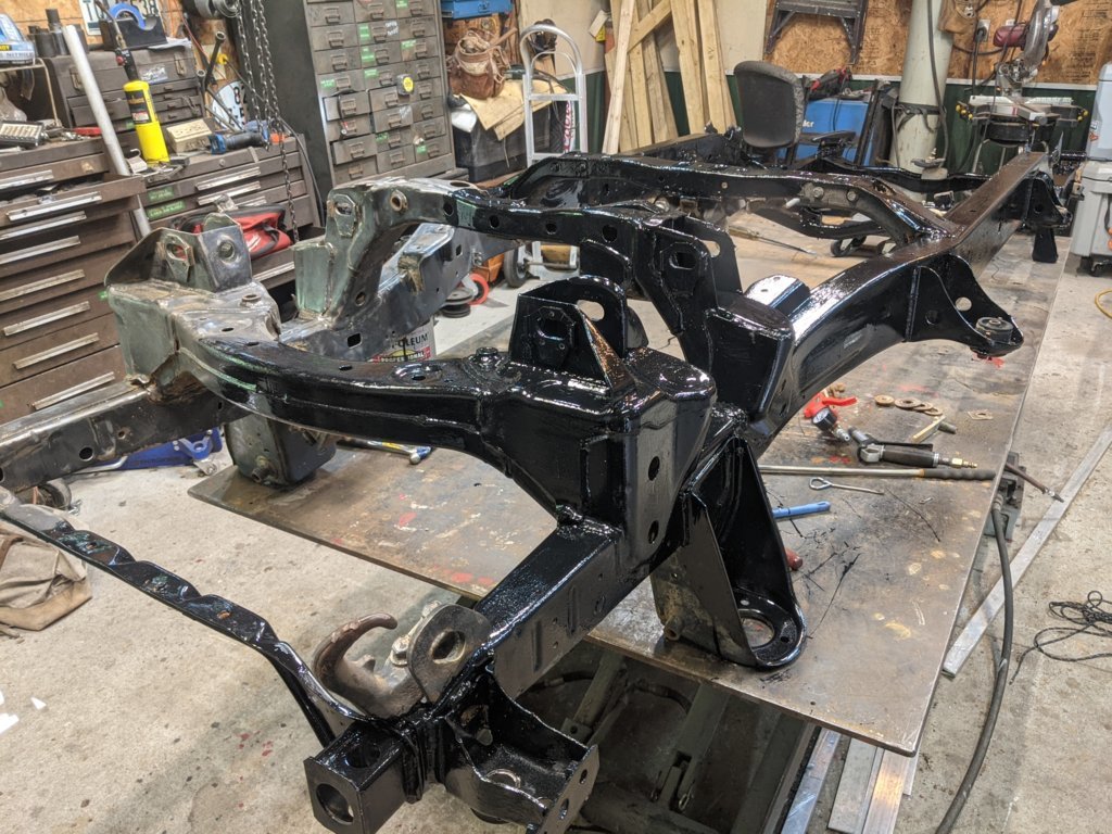

    Bottom side painted.
    Hope it's dry by this evening, I want flip it and tackle the other side.
    I had torn latex glove at that time, so took a pic while I could grab the phone without getting paint on it.
    The bottom side is all painted now.

    I don't think they looked this nice straight from the factory.
    I'm glad that bullshit paint prep and painting is done!
