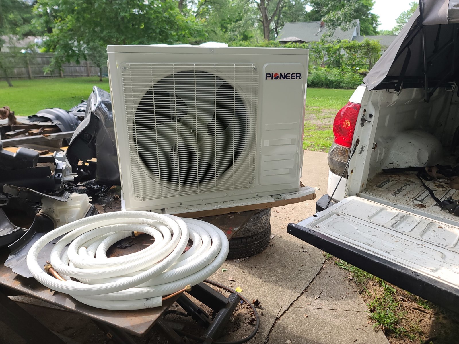

    Slight derailment on the trailer build.
    I had intended to put air conditioning in my shop when I built it 10 years ago.
    I fucked up and put windows in it that match the house, never thinking that a window mounted AC units won't work with jealousy windows.
    Found a deal on 24k mini split unit.
    With AC, my wife can spend time in the shop with me without the heat Making her feel worse.
    I started the install on Sunday. It was started up Tuesday afternoon.
    My shop was 86* at 2pm. It was 74* at 3pm.
    More details to fallow if anyone is interested in the mini split install.

    Is this one of the units that comes pre charged & ready to hook up the line set?
    six5crèéd and Tiedie like this.
  18. Jul 17, 2024 at 1:04 PM
    #38
    koditten
    koditten [OP] Well-Known Member
    Sep 8, 2013
    #112077
    19,711
    Kirk
    Central Michigan
    04 trd x-cab 4 x 4 3.4l
    Reserected from the dead.
    No. This one the base unit has a charge but the inside evaporator comes with 5 lbs of nitrogen.

    I wondered how they evacuated the air in the line set, clever.

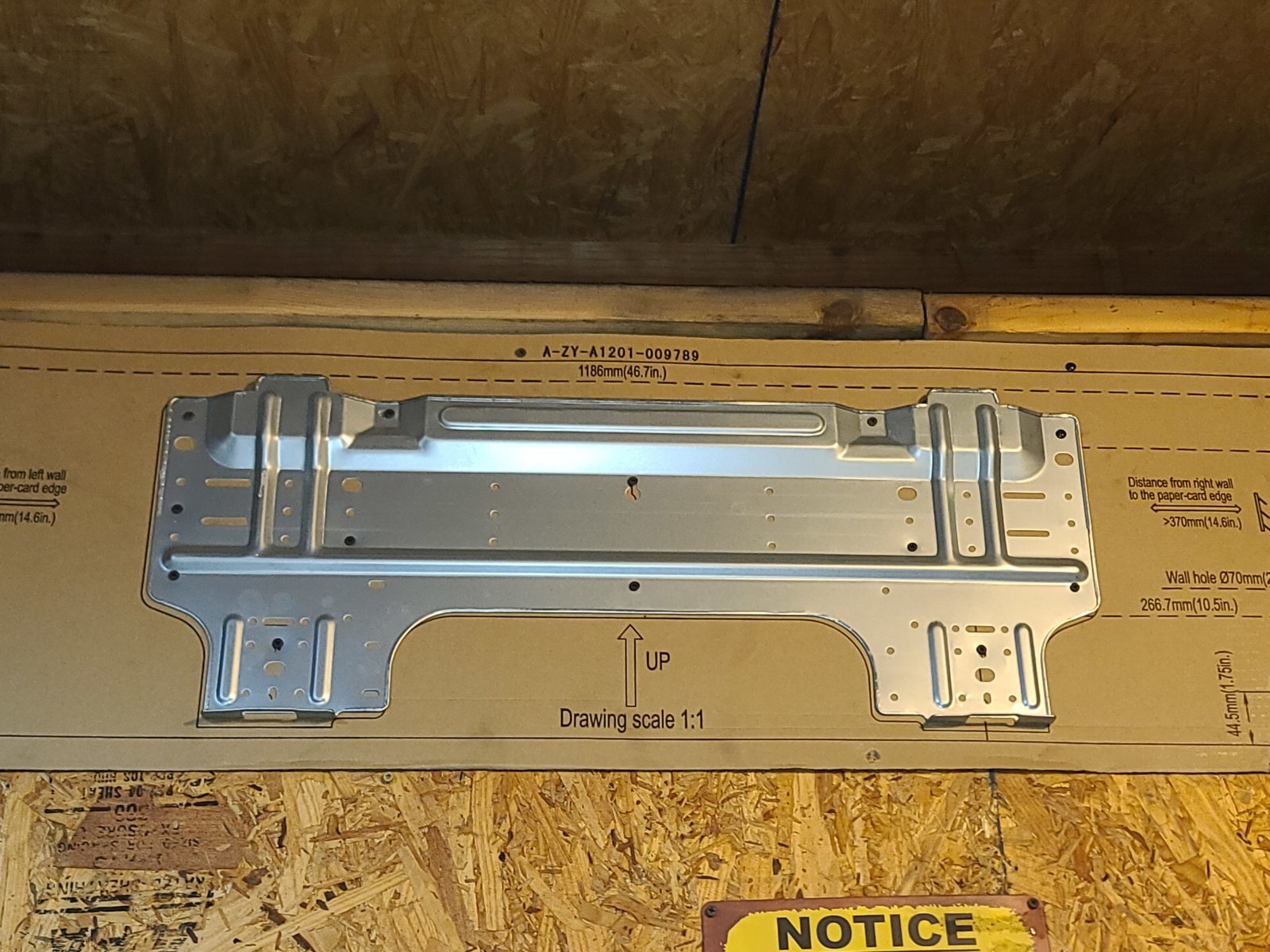

    The kit comes with a template so you know where to drill the access hole and where to mount the bracket.
    I cheated and left the template in place when I screwed the bracket to the wall.
