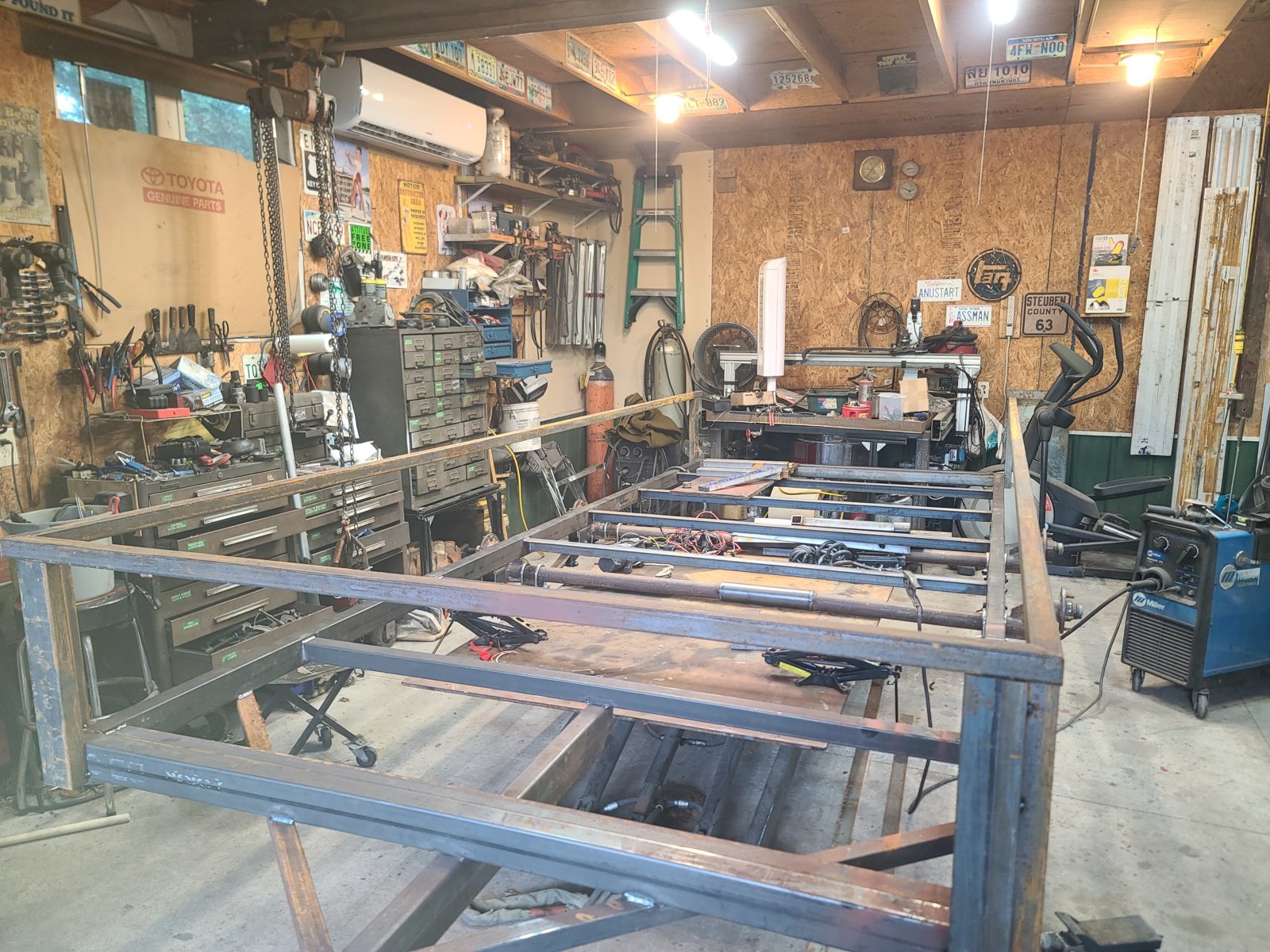

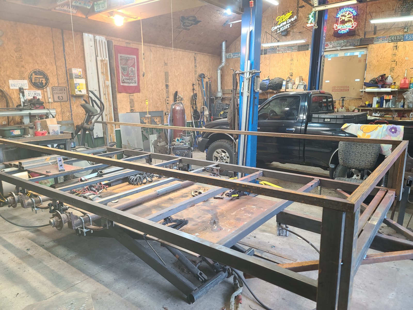

    Welding in the top rail.
    Adding a top rail and tieing it into the uprights really increases the trailer rigidity.

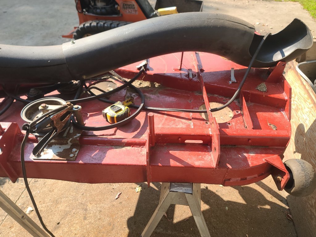

    These decks are crap. They rot out much faster than the chassis wears.
    I can find these mowers cheap, but the decks are always shot.
  17. Aug 25, 2024 at 2:15 PM
    #97
    koditten
    koditten [OP] Well-Known Member
    Sep 8, 2013
    #112077
    19,800
    Kirk
    Central Michigan
    04 trd x-cab 4 x 4 3.4l
    Reserected from the dead.

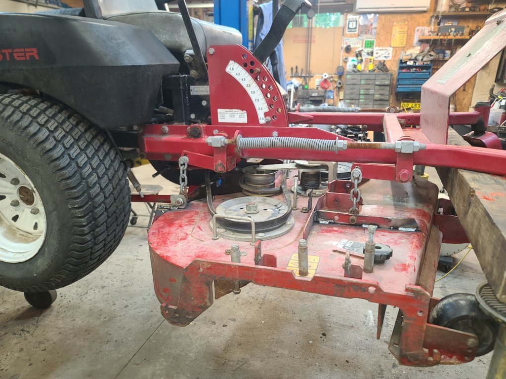

    Toro uses the same deck, but just changes the suspension.
    I'm grafting the mounting hardware from the crap deck to this new model.
    Lots of plasma cutting and grinding to make it happen.

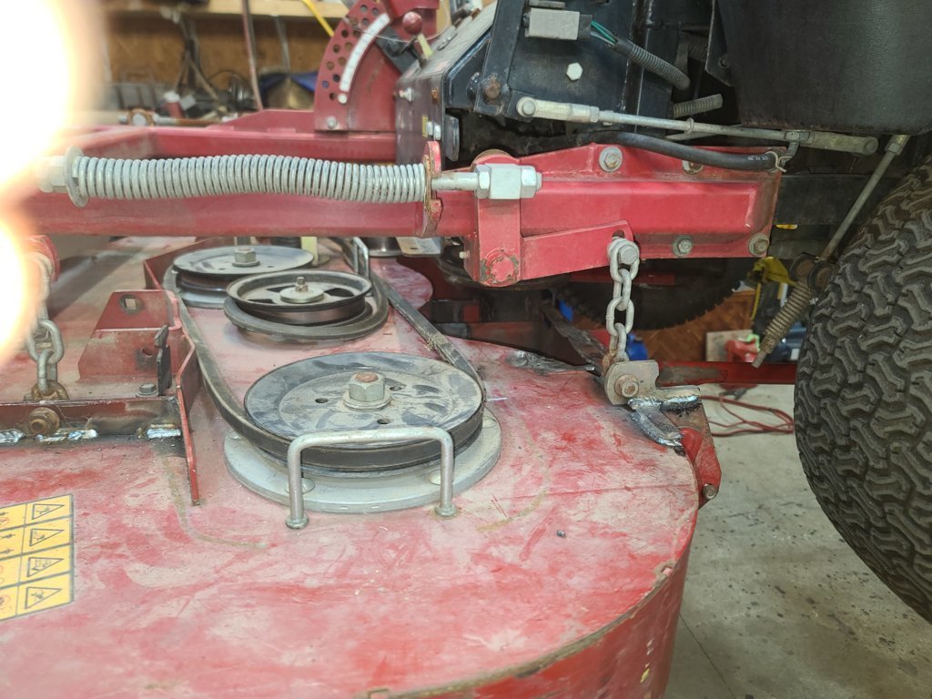

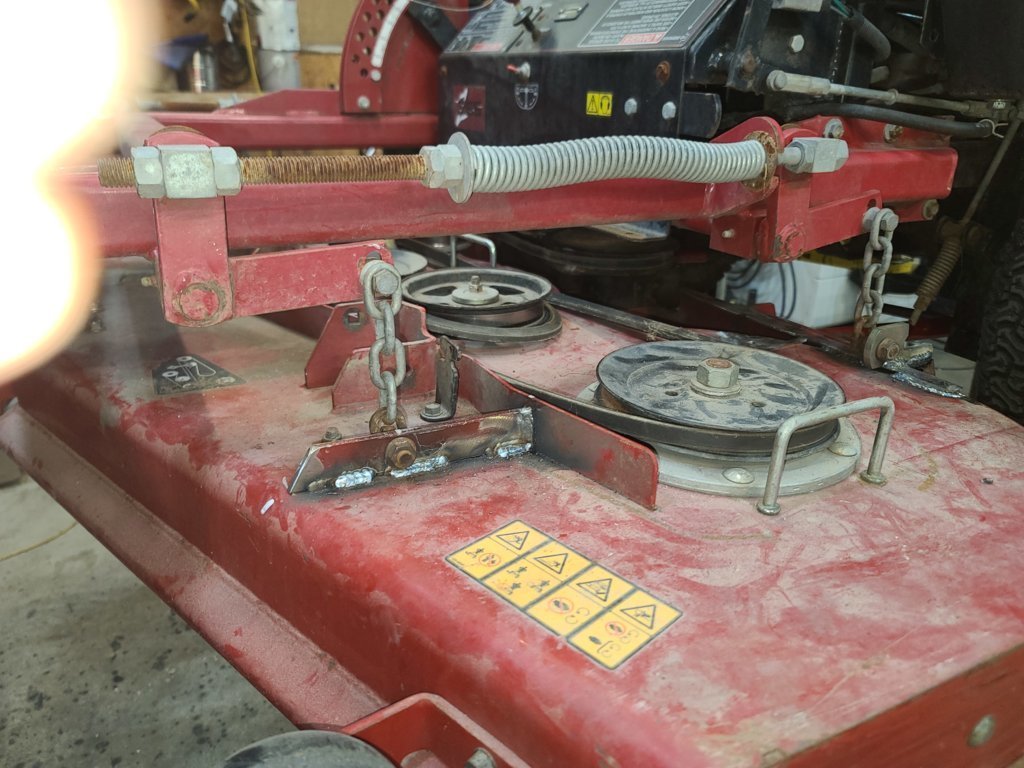

    Welded on the chain supports. Lots of up and down with hoist to make sure they are welded in the proper position.

    Things look good.
    As I said, I've never used one of these decks, but I have confidence that they will work quite well.waiting on belts before I can test run.
