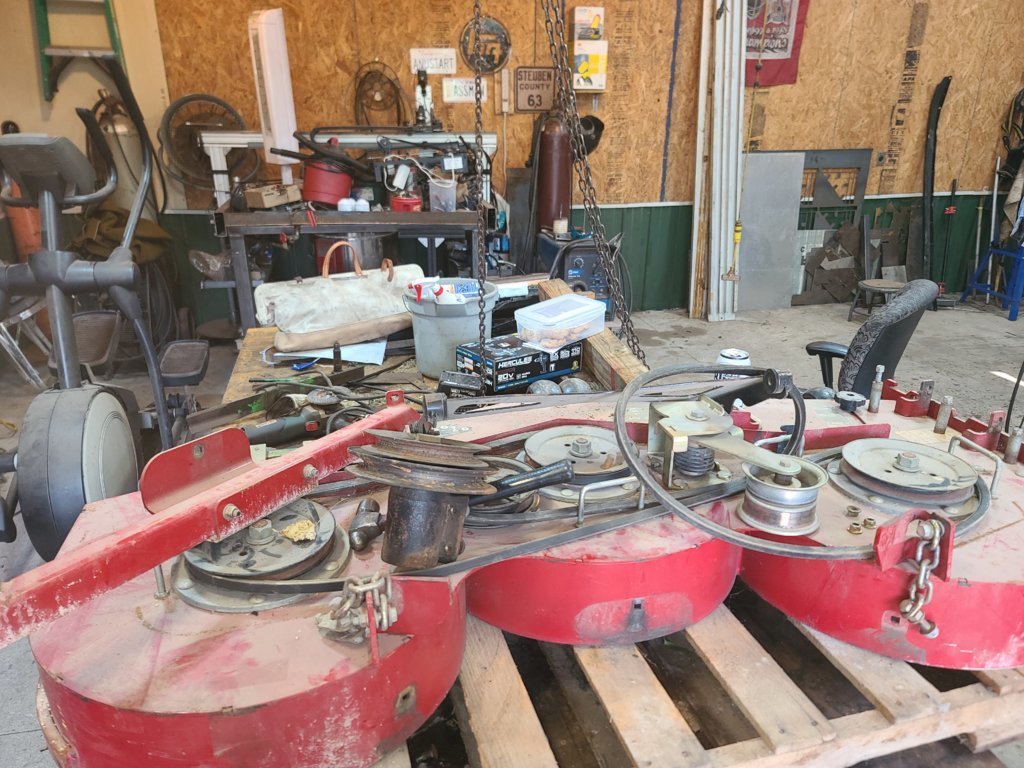

    This pic is out of sequence. It's a dry mock up before I welded on the trailing arm brackets. Since the deck is suspended by chains, the trailing arms keep the deck from swinging around.

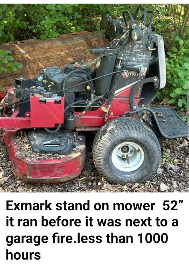

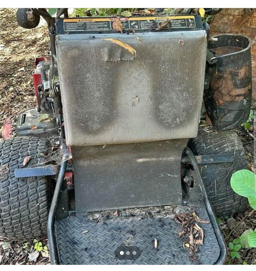

    Picking up my next zero turn project in the morning.
    I see the pro cutters are using these more and more.
    This one was sitting next to a garage that caught fire. I like repairing units that caught fire. Just plastic and wires that need swapped out. Hopefully it's a straightforward fix.

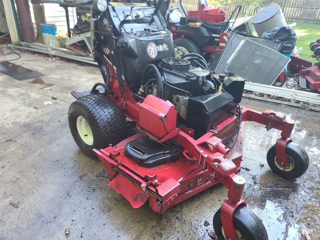

    Got a few minutes to give the project stand up ZT a quick assessment.
    Gave it a serious pressure washing. The top of the deck is coated with built up oil residue and lawn clippings. Huge mess.
    I could not get the unit to roll over with the starter. Tried using the flywheel with a breaker bar. No go.
    She is froze up.
    I'm assuming it has a bad main seal. The engine has to come out regardless of my next step...
    Unfortunately, with these units, the deck and the engine are bolted to the same carriage. The deck needs removed before I can gain access to the engine drive pulleys. I know, strange .
    The way the chassis is designed, I can't even access the #1 spark plug.
    Not a fan.

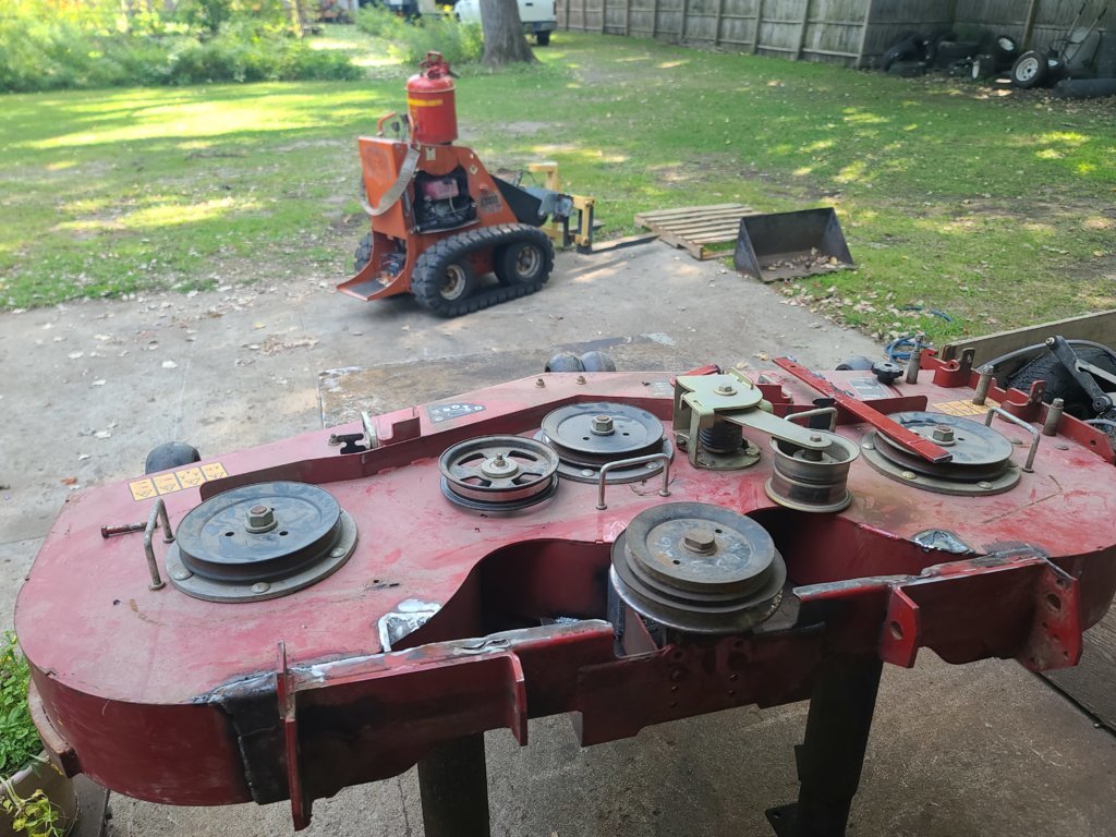

    Update:
    Pulled the deck. Removing the deck from a stand up ZT is no fun. 1 star!
    This deck was coated with oily dirt. No way about it, you gonna get dirty no matter what pig you gotta wrestle.
    Once the deck was off I could access the electric clutch retaining bolt. Since everything was coated in oil, the clutch fell right off.
    With clutch out of the way I was able to put a pipe wrench on the crank. The froze up engine broke free with only needing 2-3 ugga duggas.
    At that point I figured what the hell. Let's toss a battery in it and see what happens. I was already prepared to hunt for an engine.
    Threw the choke on and twisted the key. Totally surprised that she kicked over and stayed running, took off the choke and it was even more smooth! Did a few full throttle/ idle cycles to see what kind of smoke I could make it produce. Nothing but warm butter! The thing just purred no matter the rpms I ran it. No smoke!
    Like I said earlier, the crank will need a seal, but with the deck out of the way, pulling the engine will be cake.
