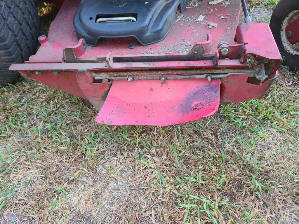

    Got to test out the standon/walk behind Exmark.
    Runs nice. Very smooth running rig. This thing must have some stellar blade speed, it just pulverizes the grass clippings.
    Hydros are smooth and powerful. I changed the oil and filter anyways.
    I like the remote controlled shute block.
    Even has head lights for night time mowing!

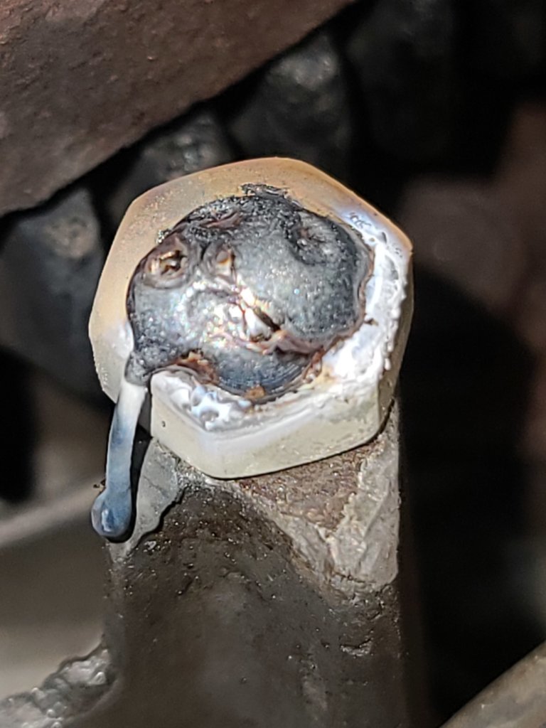

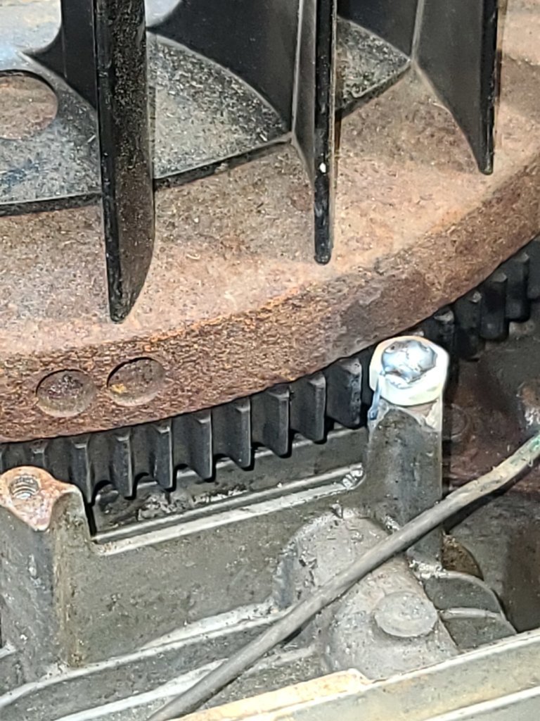

    I hope this works. Pretty small bolt stuck in the aluminum.
    Will try after it cools a couple hours.

    Failure.
    Drilling and tapping time.

    Left hand drill bits?

    No, I just drill the small bolts and retap. Iron screws and aluminum blocks is never been easy for me.
    That galvanic corrosion is a pain.

    Sometimes I’ll do a cut across and then try a flathead to remove. Usually my last option before drilling/ tapping (if I can).
