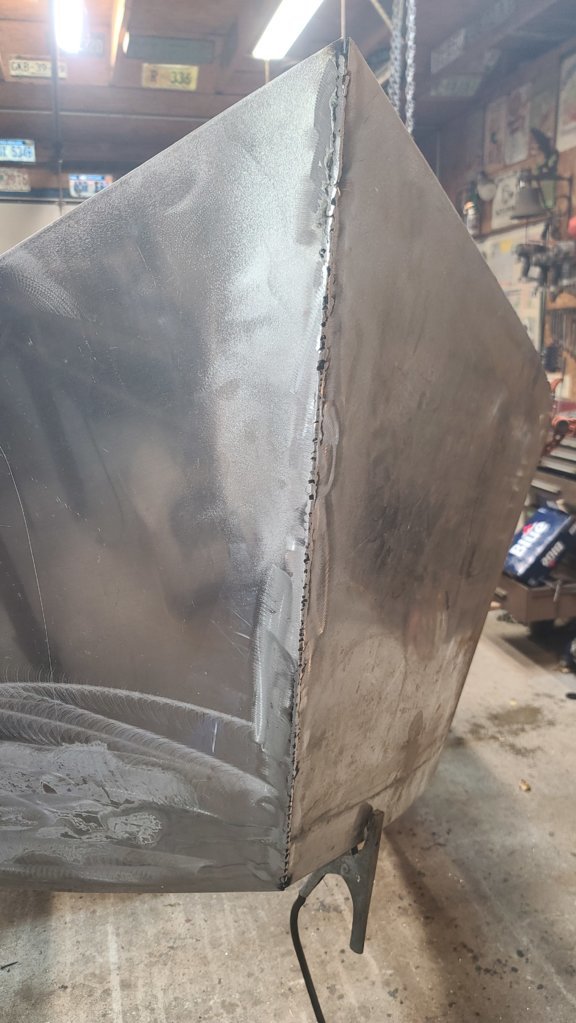

    Southern Virginia
    8 lugs no plugs

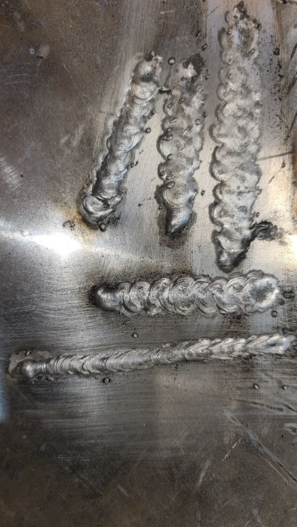

    Fighting that spool gun :rofl:
  13. Oct 19, 2024 at 2:34 PM
    #173
    koditten
    koditten [OP] Well-Known Member
    Sep 8, 2013
    #112077
    19,711
    Kirk
    Central Michigan
    04 trd x-cab 4 x 4 3.4l
    Reserected from the dead.
    They do take some effort to get dialed in, but once done, you can haul ass laying down a weld.
    You just have train your head that aluminum welds 3x faster than iron.

    It's nice that welding aluminum is 100% duty cycle.
    You can weld non stop...until the person welding runs out of duty cycle.

    Playing around with spool gun settings.
    Been 6 years since I ran aluminum wire.

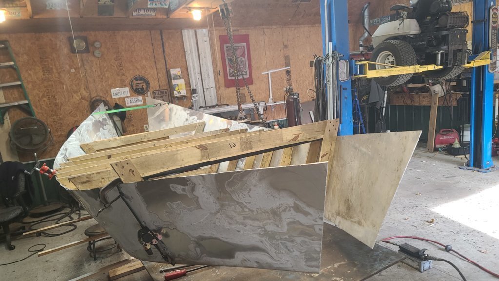

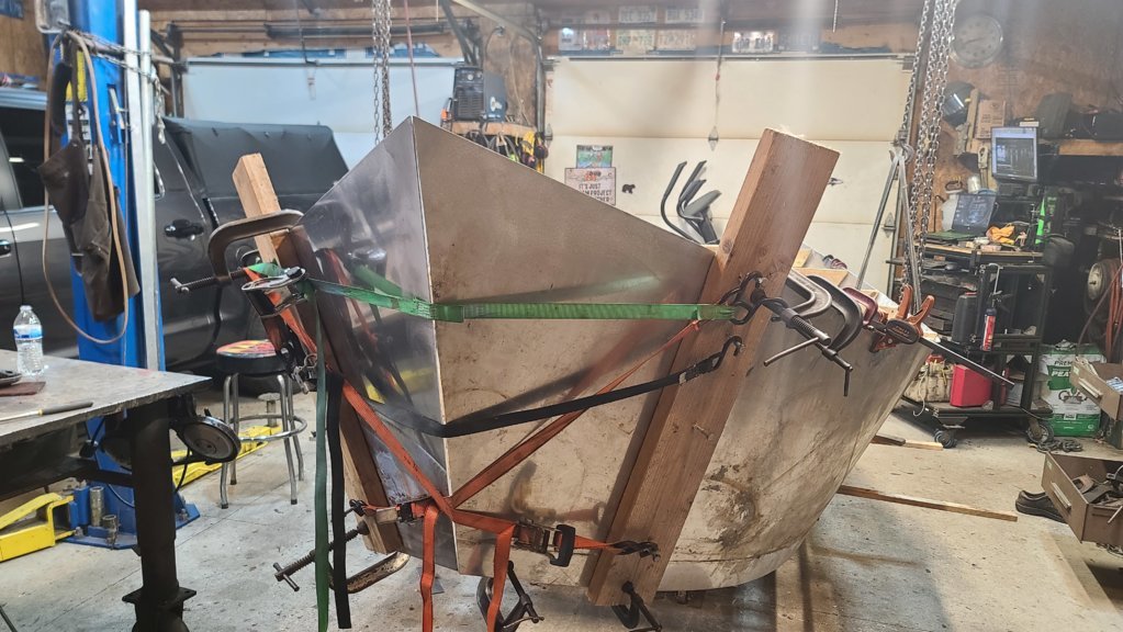

  20. Nov 1, 2024 at 6:21 AM
    #180
    koditten
    Sep 8, 2013
    #112077
    19,711
    Kirk
    Central Michigan

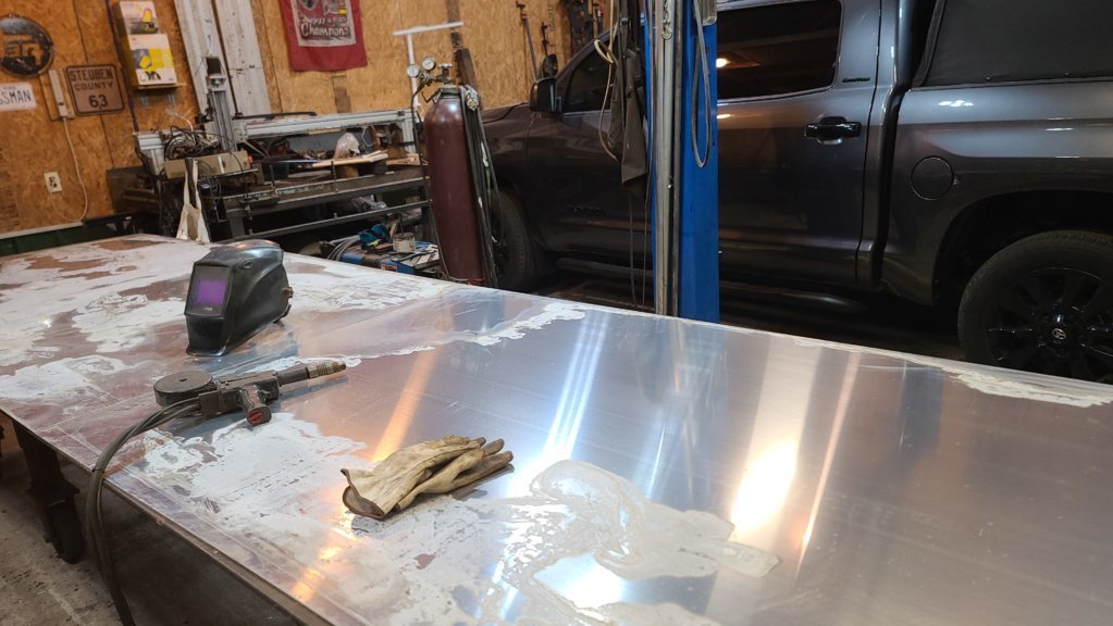

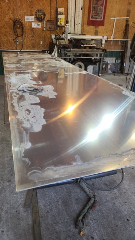

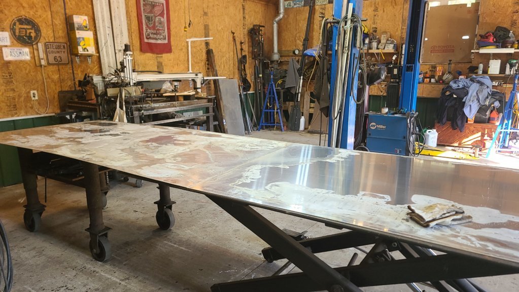

    I guess it's evident that I'm building another boat.
    I've had the materials taking up space for 3 years and am now just getting started on the beast.
    If anyone has looked at the build process of my previous, they will notice that it's very similar. I am incorporating a few changes for this boat build.
    The first change will be the width of the stern. This boat will have a wider stern.
    The second change will be the floor. This boat will not have a flat floor, just a 30" wide strip of treated plywood wrapped with outdoor carpeting. I found the flat floor in the previous boat was a nice feature, but for the amount of work and materials needed, juice wasn't worth the squeeze.
    The last change will be the outside coating. I'm going to save time and just wrap the hull with vinyl.
    I am not sure what pattern/color/design I want to go. Please offer suggestions if you feel inclined.
    ...to be continued.
