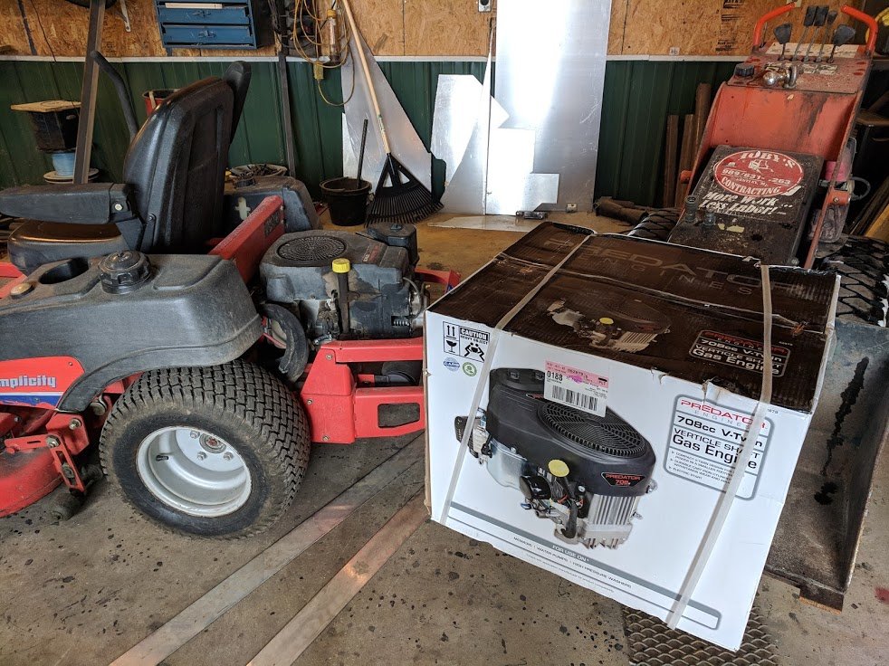

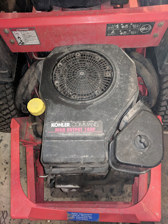

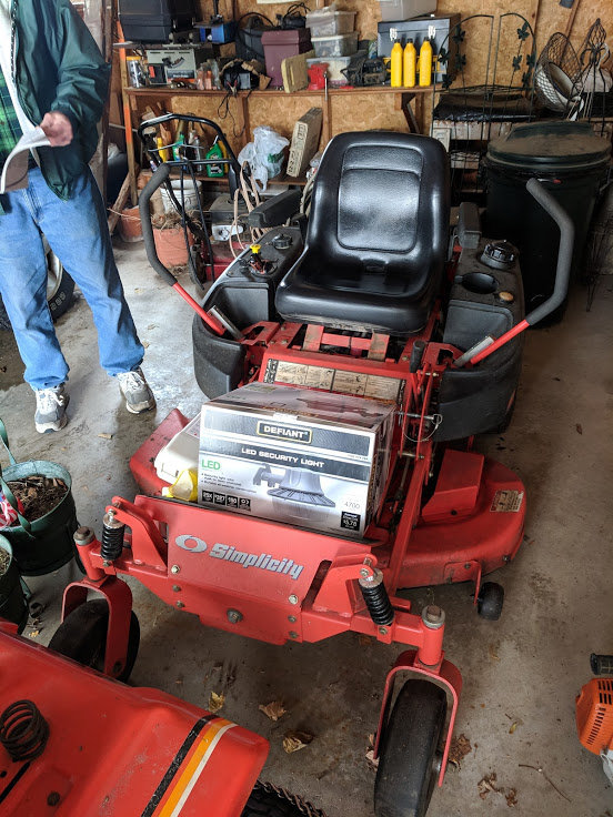

    Got called over to the brother in laws. He wanted to know if I could save his old zero turn mower. He has no mechanical knowledge and was asking my opinion.
    I was told it was burning as much oil as it was burning gas. He said he pulled the spark plug and something brass colored fell out.
    I told him its going to need a entire rebuild or engine replacement. As soon as I heard it run, I knew it was on borrowed time. The valve train was making some hella racket.
    He ask me if I want the thing as he already has a rider mower to take care of his mowing needs and is not willing to put money into this unit.
    The unit is in remarkably good shape for a 10 year old unit. He was good about having it professionally serviced every year.
    Of course I said sure.LB0Yk9IfTyYG5NmnKqTgi3ozP6Y7xDep5ljeFfHw_57fa375eec1f96b31ca5e925cf7dc149d97a96f2.jpg _R1wdo3MNPzl-gHmdO_tWU_E_-xO-nhUA-CS7mZj_915c851e012419beb0ef455a8a21f329bef48d14.jpg

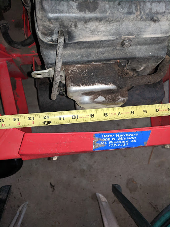

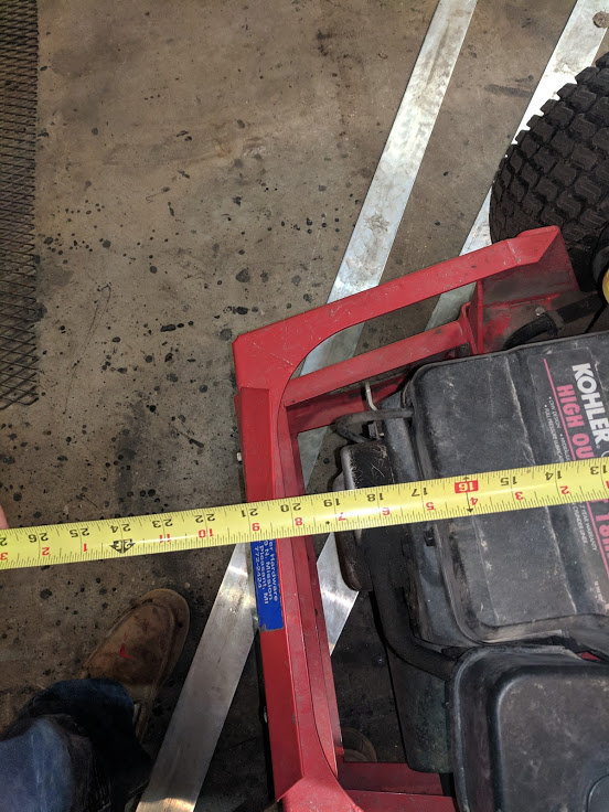

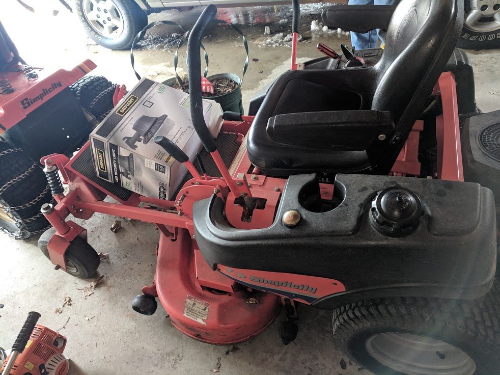

    I get it home and start researchingUOPChQWQW14N_diB0fxdDQ38akpfnrYdbzljlCO3_8d9fb0490bf04eda6f9d6796a9890b31183528df.jpg the engine. I'm finding that the engine is not really the highest quality. 600 hours is considered a good lifespan. This one went 900 hours.
    Because of this fact, I didn't like the idea of putting the same engine back in. I've never been a fan of single cylinder motors. I find the twins are much smoother.
    1st step: find out how big of a unit I can fit in the motor cage.
    The Kholer was about 15 inches wide. My motor cage was around 17 and some change.GwesTXXRLjAIxmK2SsXLeTBBRVPUxFntJy8uccod_403ed205d3e3c07293b4828f3389fe902bada09f.jpg

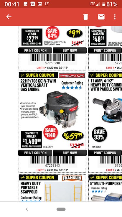

    Anyways, I've been watching the Harbor Freight Predator motor reviews for some time.
    I was hearing nothing but great feedback and the price is untouchable. There is a warranty if you want as well.
    Very convenient how this coupon add got sent to my email exactly during my motor research.
    It was even $50 cheaper than the sale price in mailer I receivedpjKXNp4OKDD3vb3orUaF0FLEjJSvdCkRSvZxs-6j_c27e85a5caac95fb7045b5f54569d8070723f191.jpg .

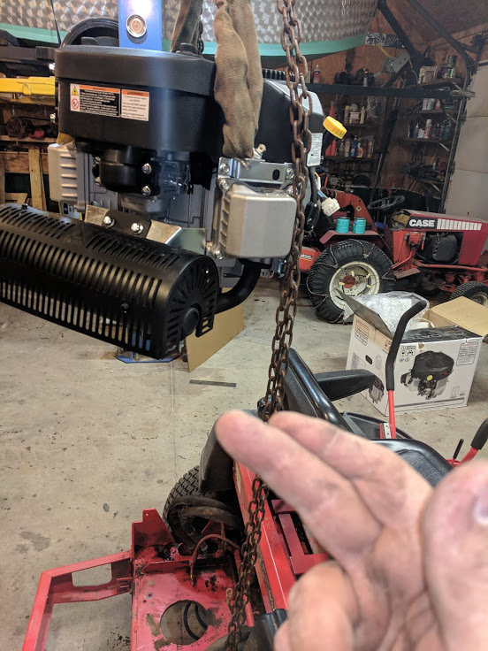

    Forgot to add the length measurement. Someone may find it useful._eEqXv-vzaRn9nR_deEwspNiJxK_ad3ntn09PduO_61c5b1c53660eaa90ffc03b5850b392fc6fc5cae.jpg

    I started checking into dimensions of the 22 HP Predator motor. Everything I found said the things were 19" at their widest. I'm bumming.
    I decide to head over to HF and check out the engines in person. After a million tape measurements and notes, I THINK the motor will fit. I take the plunge and lay down $700 bucks. Worse thing is have to return it.uDdOqdPJEzul3uE0AmEZwx4vnnu6GA17ISJd0Elq_e3d74004dcd92f2b222b93ddae2d2b4fb6ef3deb.jpg

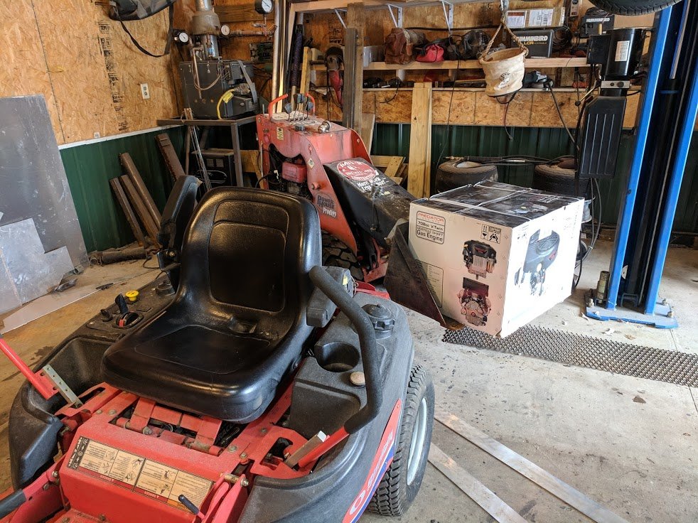

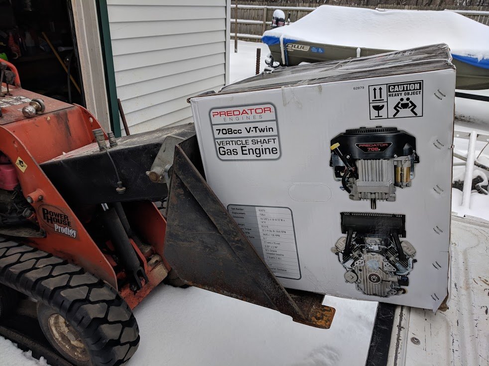

    Bringing motor over to unbox.Li-gB4mgbNDU-_czNBHH4--Kg9d7zHR3rpSrjlCg_307f5d506783d52a778456b2e594f84486443a7c.jpg _OnmUykVnHu1LjclfJ-AiEx16zDLZ3_PxA-loDHl_197323b45ad7eb33f3da5e9cf8c05de6677ddcd4.jpg

    I'm curious what the hell the micro bucket loader is used for now

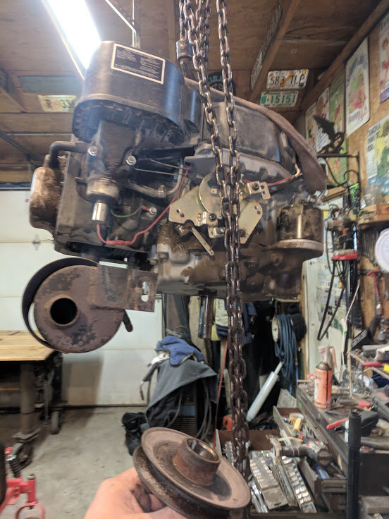

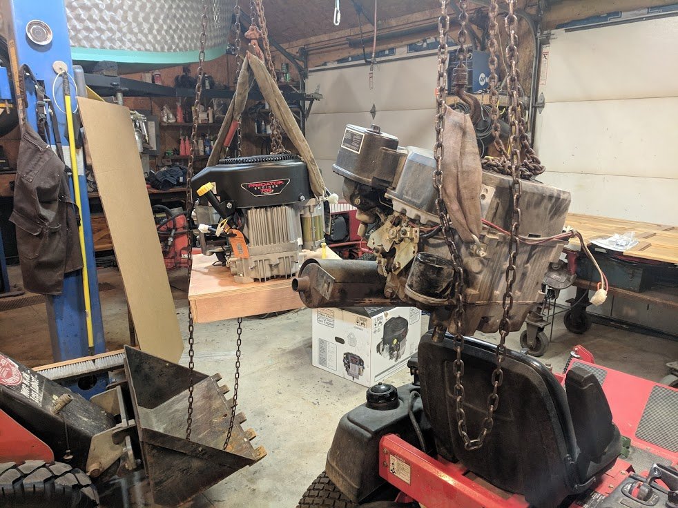

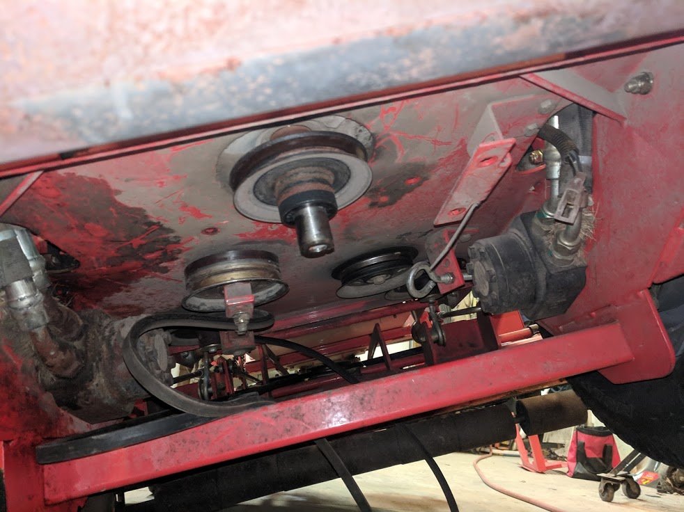

    Getting ready to lift the old motor out. I took this pic just so I could have a rough record of the belts orientations. I just got the electric clutch pulley0buVmTIo5MNYFLH2SQrIzJTSqIqm-KACGZmTR8Wu_306fd4e096d635ebbc78ee16a43de5a73c47a1c9.jpg removed and set aside. I was worried if I dropped it, it might screw up the magnets.

    Old engine lifted out. I didn't know that the hydraulic pump pulley was not kept in place with a set screw. The thing slid right off the crank!j4b1wpZxkUKqsjiw3qDOoNqX8yomgQBeFzdUj5vG_3566eca3dfeae63dd0020f7a41810ca603681d25.jpg

    Anything I want. It has forks, root ball augers, fence post augers, trencher and rototiller attachments.
    It was a rental from Home Depot. Someone vandalized the wiring. It went up for auction and I got it for cheap.

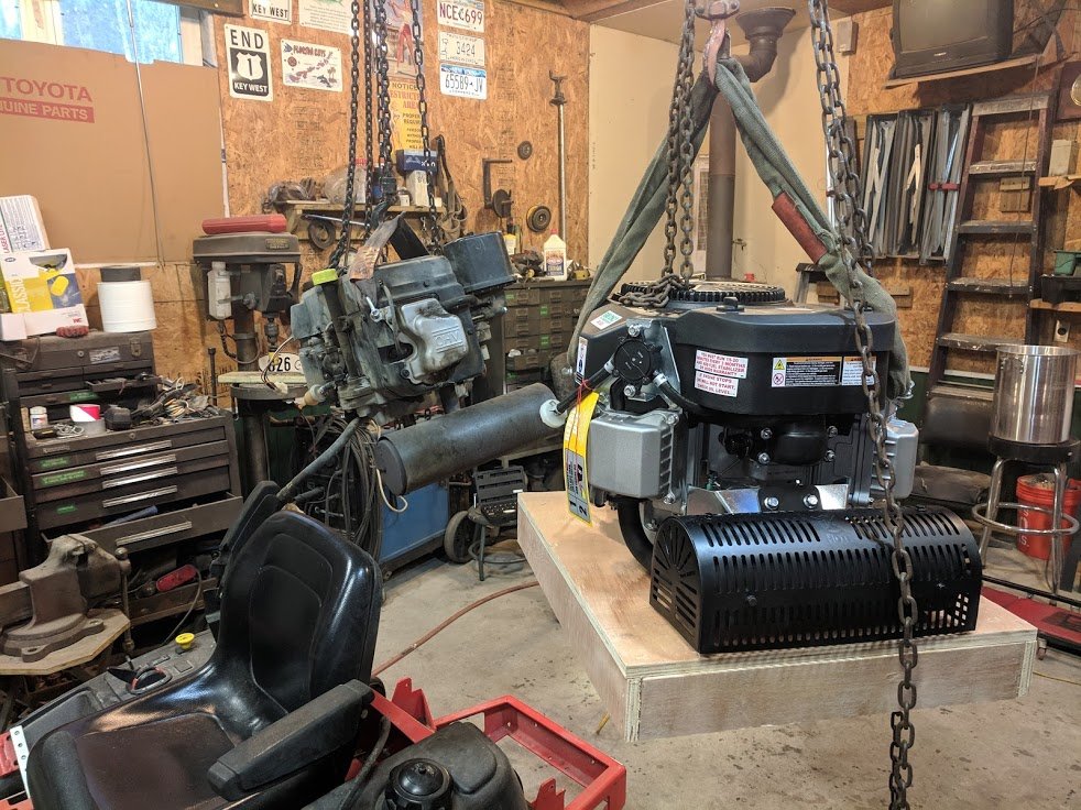

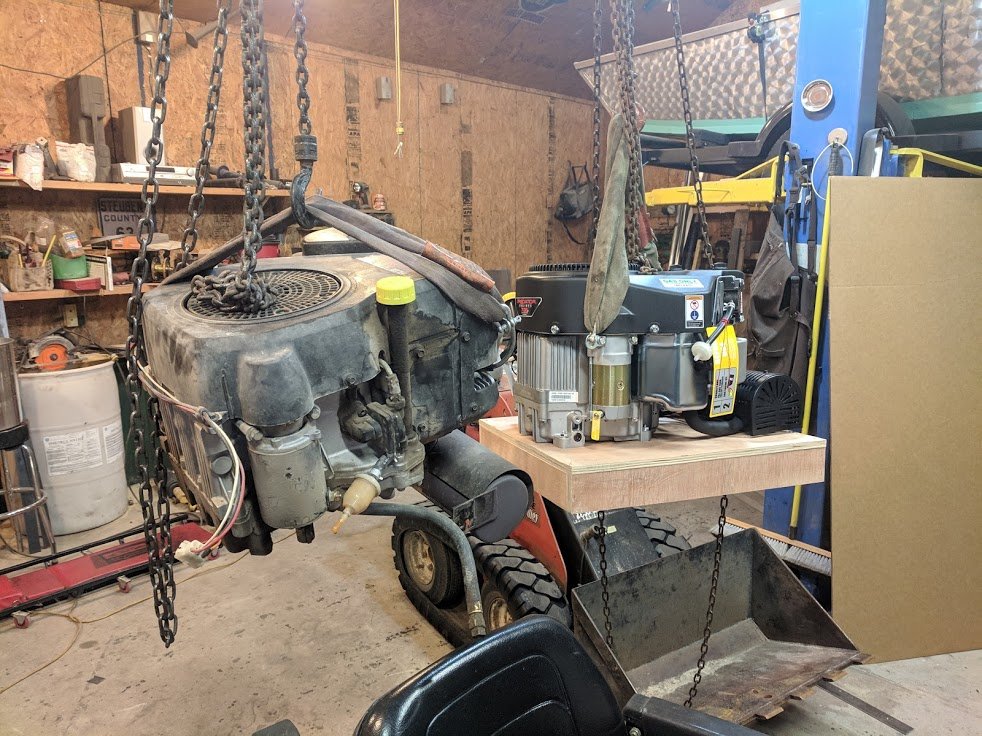

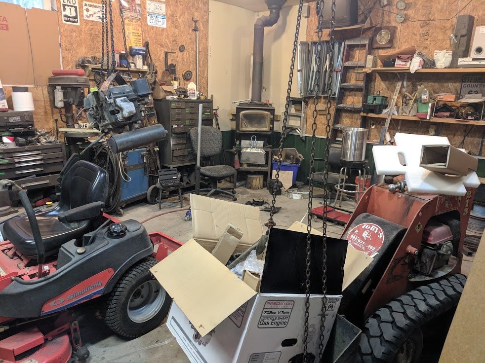

    New motor getting un boxed, old motor still hanging on the far chain falls.539idxK8sjkyR-no-G0PP4L9fh1IaV85mCT8LgcP_07dbad16534a7532f7d883bccaaf52a9a06132c1.jpg
