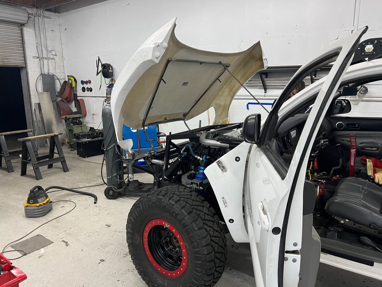

    Played hooky from work...
    Got the cases final torque
    Installed drivelines
    Swapped out the 16 in coils for some 18 inch coils
    Fixed the alignment
    Adjusted the front brakes
    Got the shifter linkages adjusted and tightened.
    Finished the patch in the floor board.
    All I need to do to finish the dual case install is put the center console back in and the front seats.

    Drove it to work today (around 35 miles)
    No issues, no leaks, no wierd sounds or smells. I'd say we're good to go. Now I just need to get the skids back on and repack the tools the way they should be, and she should be ready for a trip to Hammers.
    :mudding:
    ssd_dan, boshak, Blue Canary and 2 others like this.
  20. Feb 3, 2023 at 9:11 AM
    #100
    El Taco Diablo
    El Taco Diablo Professional Pinstriper
    Nov 6, 2017
    #235223
    13,979
    Matt - KN6DZP
    Hughson, CA
    Impulse Red DC, 5vz-fe, 4wd swap, LT, dual case, F/R locked
    Just 3 tons of fun!!!
    Initial thoughts.
    I can definitely see what people were saying about more vibrations with the Poly Tcase mount. It's not that much of a deal for me. Just something to get used to. With another mechanical part attached to the frame, I was pretty much expecting it.
    I LIKE the way I did the floor board patch. I did 2 layers of 16 gauge sheet metal with foam sound deadener/heat shield between them. Screwed (not welded) so I can get back in to the shifter linkages if needed. Actually makes things quieter than they were before the second case.
    I don't love the way the triple sticks ended up, or the way the boot ended up either. It's not enough to make me give a shit too much, but will probably be re-addressed in the future. The sticks do have full range of movement, and they don't hit each other, so they function... I just don't like the way it looks, more than anything.
