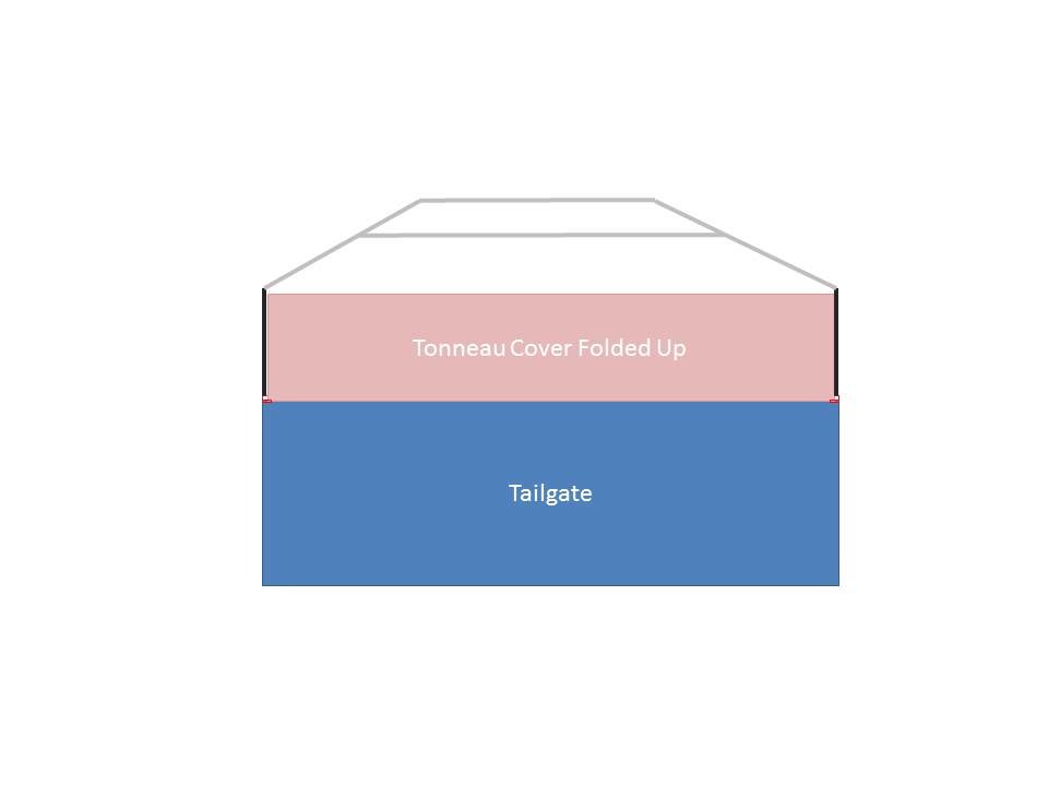

    Interested in a design allowing a tri-fold to open up as well, but the mounting brackets shouldn't extend over the sides of the bed rail as in my crude drawing.

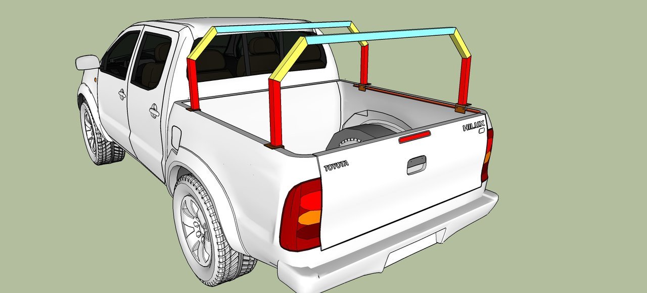

    Mark,
    You're thinking something like this?

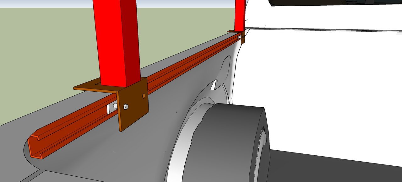

    I'm not sure that I completely understand what you mean by "the mounting brackets shouldn't extend over the sides of the bed rail"
    Are you referring to these?
    If so how do you propose to fasten the bars to your bed? I can provide just flat plates but that would require drilling of the top of the bedsides.

    Looks good, just meant that they wouldn't extend out past the width of the bedsides, so as not t snag on anything.

    I understand what you mean now! That was one of my fears with my original idea to extend the top plates. I'll have some pictures of the mock ups posted after this weekend if everything goes as planned.

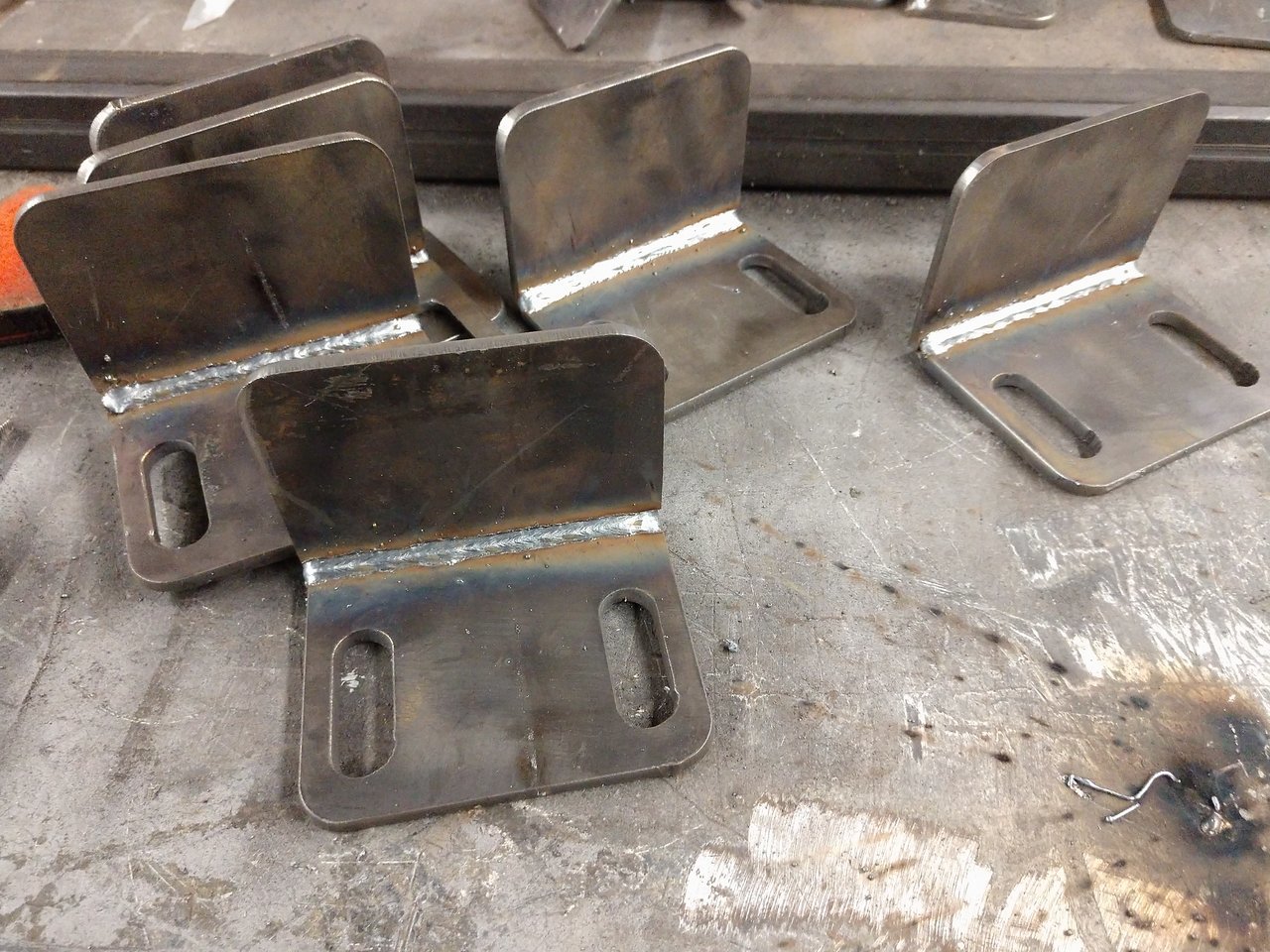

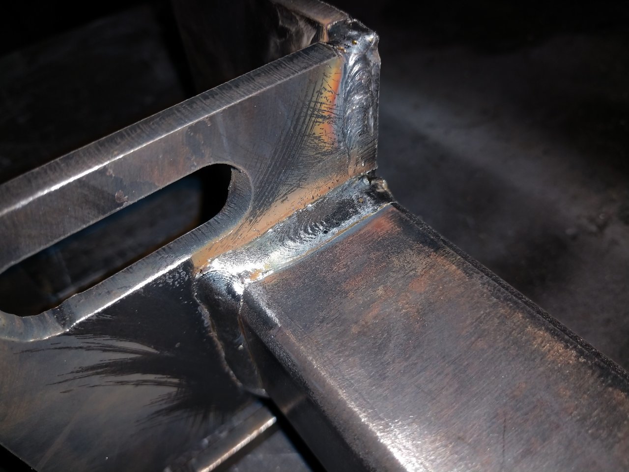

    Here are the pictures of the mock up for the tonneau cover brackets. I'm going to round the vertical piece a lot more so there is no chance of getting snagged on it. This will allow a 3" tall cover to install. The piece of 3" tubing is for scale, as well as the straight edge. IMG_20180128_201328752.jpg IMG_20180128_201236197.jpg IMG_20180128_201132749_LL.jpg

    Good looking work!
