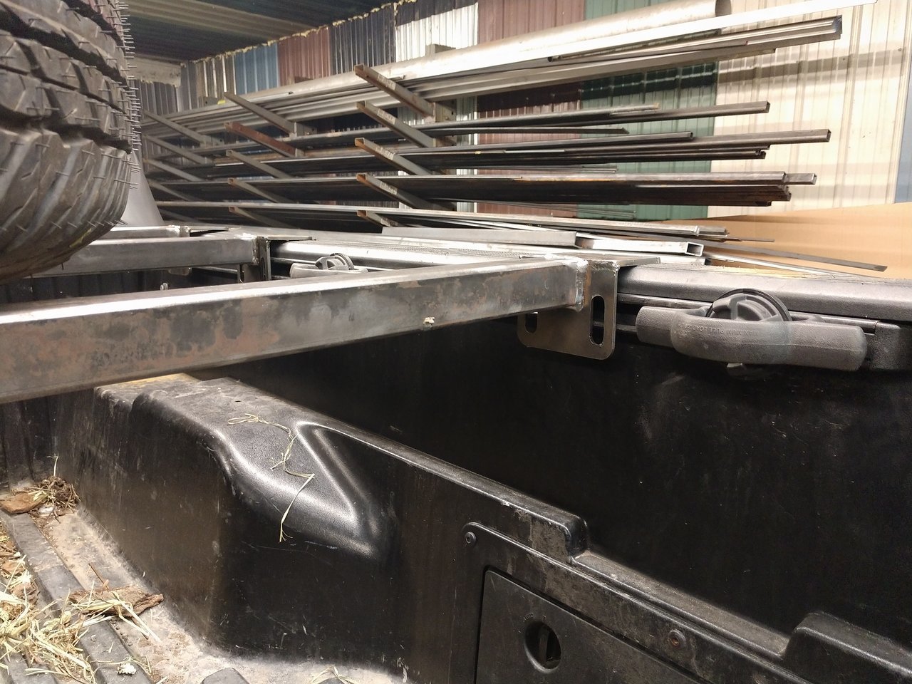

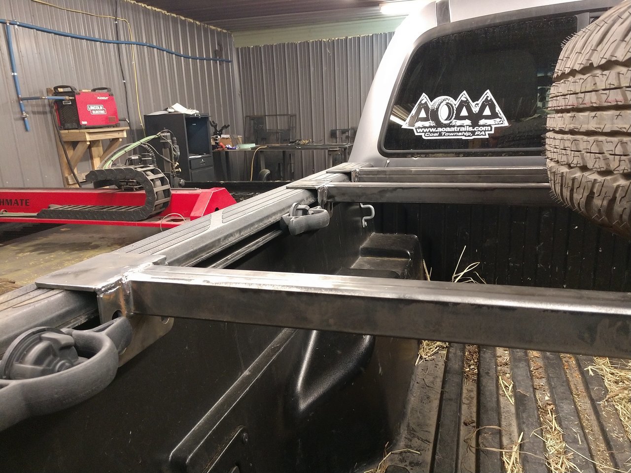

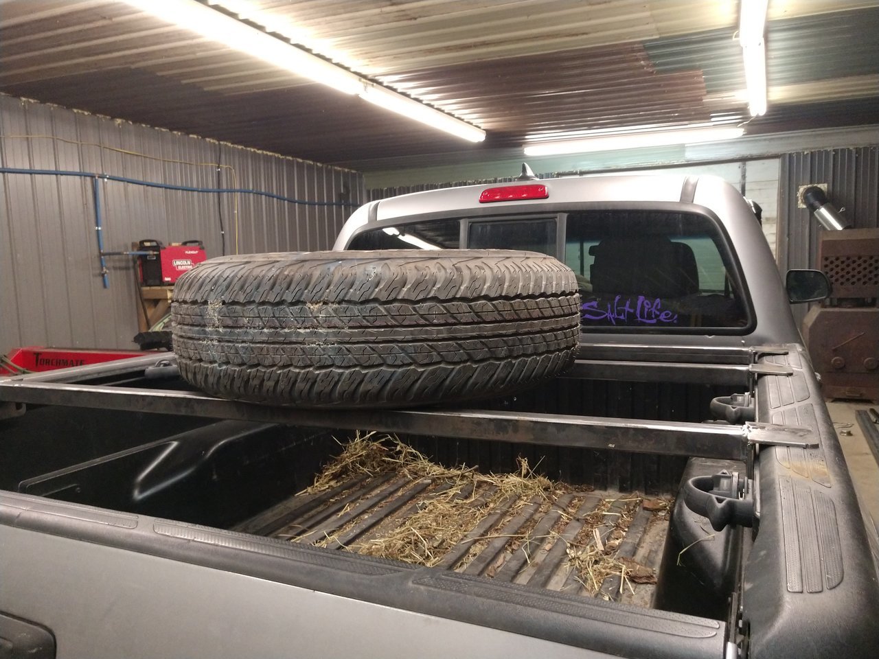

    They are supplied with all of the required hardware, I am waiting impatiently for my shipment of bolts to come in!
    IMG_20180129_204825818_LL.jpg IMG_20180129_204803489.jpg IMG_20180129_204752216_LL.jpg

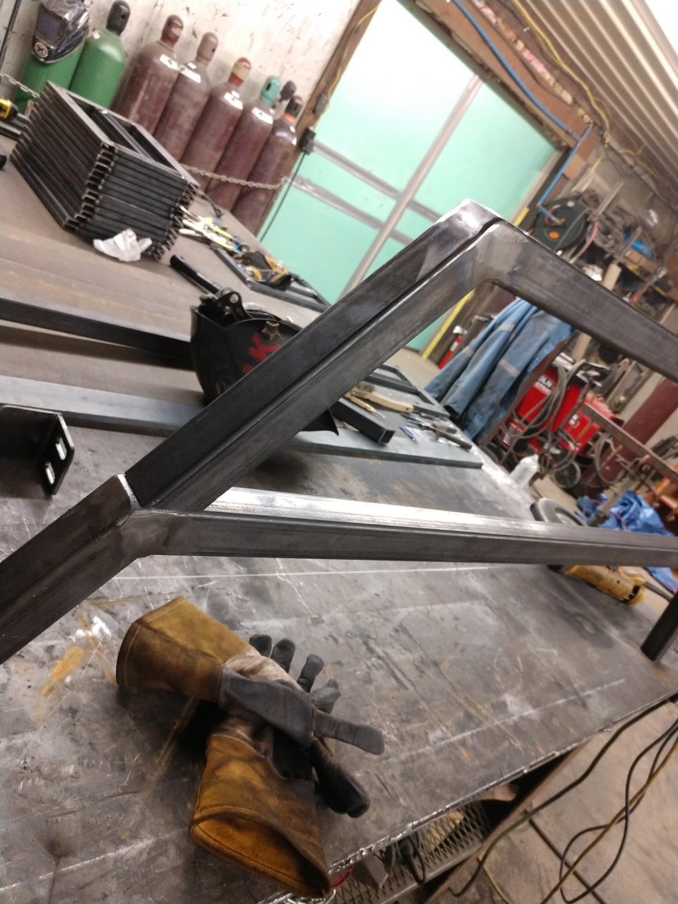

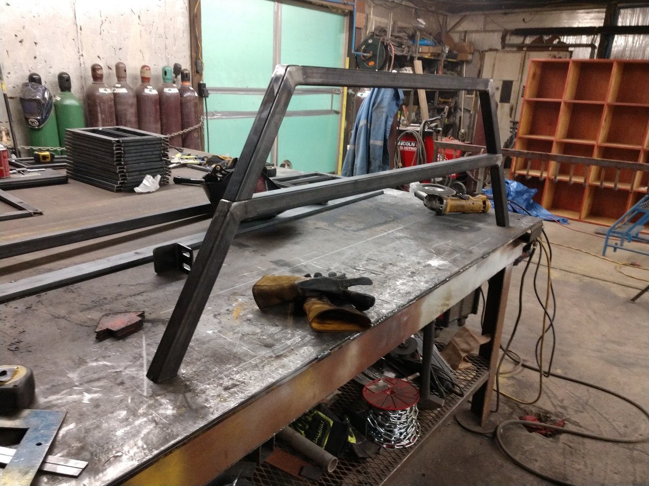

    Thats neat looking. Custom thing? Almost looks like the start of a backrack/headache rack type deal.

    Bed rack with bolt on kayak carrier extensions.

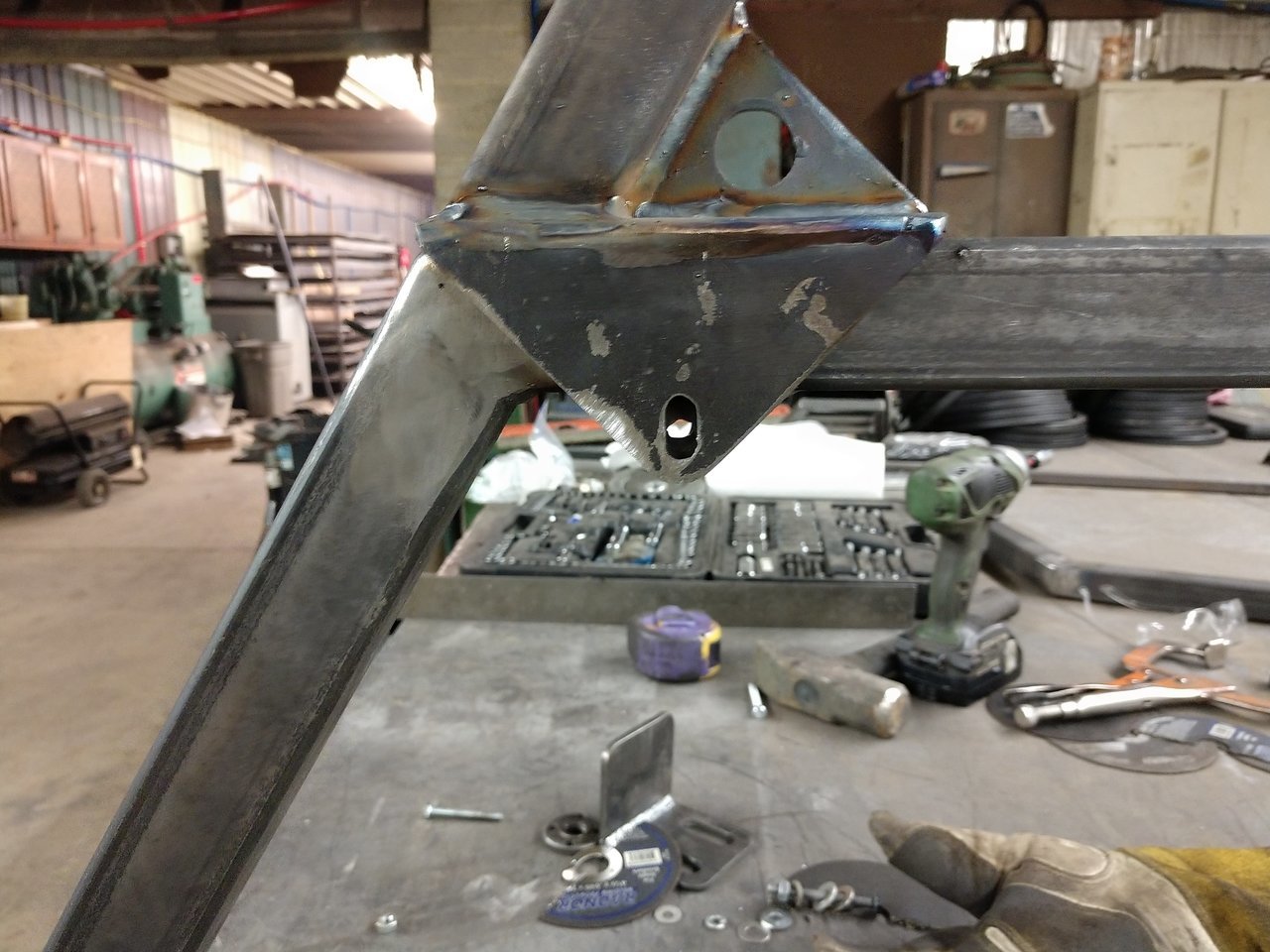

    That's essentially the plan but with dedicated welded on tabs instead of drilling the bars.

    I didn't want to compromise the structural integrity of the bars and it's not that much more work to do it this way. Granted drilling the top of the bar won't have a huge structural impact, but then I'm letting weather in too. The additional tabs aren't as simple but I think it's the better solution.
