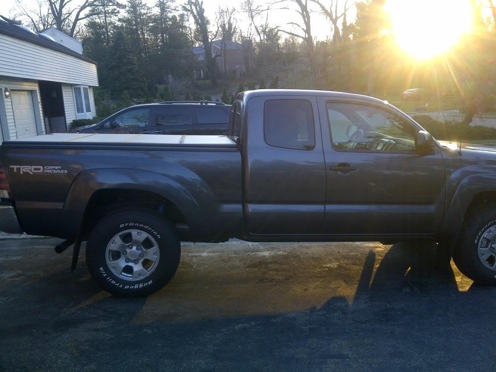

    2013 Taco MGM TRD Off Road...and so it Begins
    Going on a month of ownership, doing first oil change today for fresh oil til 5k.

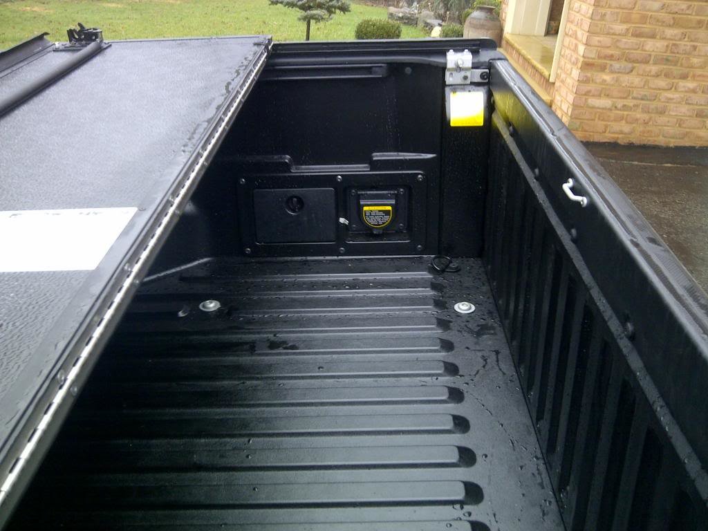

    So I've had some interest in the Fold-a-Cover... here are some more detailed pics...sorry about the weather.

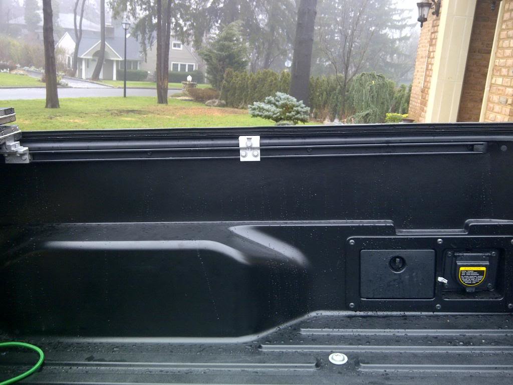

    Fully folded: Notice you still have the whole rear section of the rails free to insert and remove tie down hardware. if you need the middle and front sections for mounts I suggest installing them at the same time as the mounting hardware for the cover. Secondly you will notice water in the bed but most was from opening and closing the cover. It's not waterproof but it has the potential for it. As long as it is protected from theft, wind, direct rain, and road spray its good for me.
    **Also almost forgot to mention, I did the install by myself, took a good while but I did a lot of adjusting and fitment especially with the locking tab. Those of you avg. joe's wondering if you should have someone install it for you, I'm no mechanic and have a hell of a time trying to put together IKEA furniture(girlfriend usually corrects me on those projects) lol but I do alright when I comes to technical stuff, do all my own service and mods, especially when it comes to firearms. I would say I'm handy... no expert. This was no rocket science tho requires patients and a rivet gun... never used one before this.

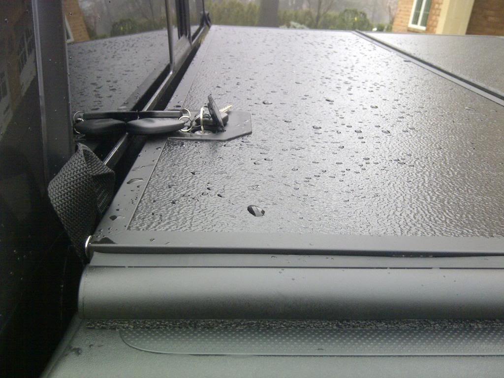

    These are the straps that keep the cover from flopping around if you drive with it open. they are sturdy and don't see them opening, there is one on the other side in the front too so 3 straps. The difference between this and other brands is you don't have that foot extra of space above your bed when folded up but I don't like having my rear view blocked so this was another plus for me but might not be for others... At the same time it's a few bolts and the cover comes off lean it on side of the bed for atv or whatever you may haul. I plan on putting a tool case under the front portion anyway so won't need that extra bed space.

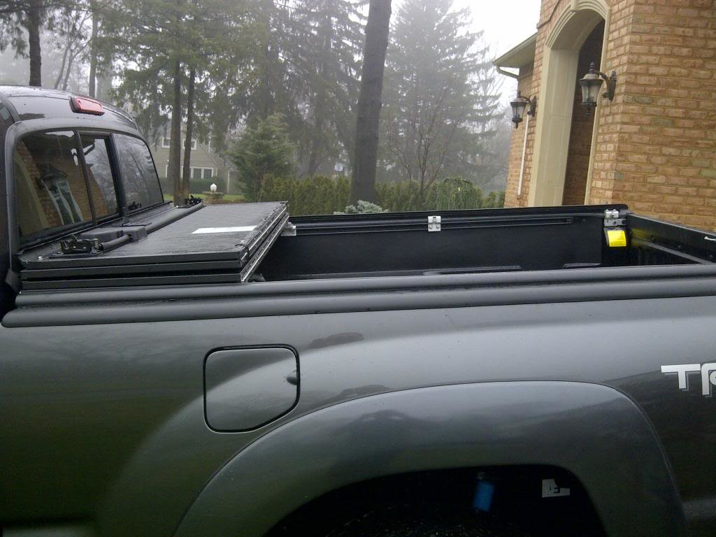

    Folding:

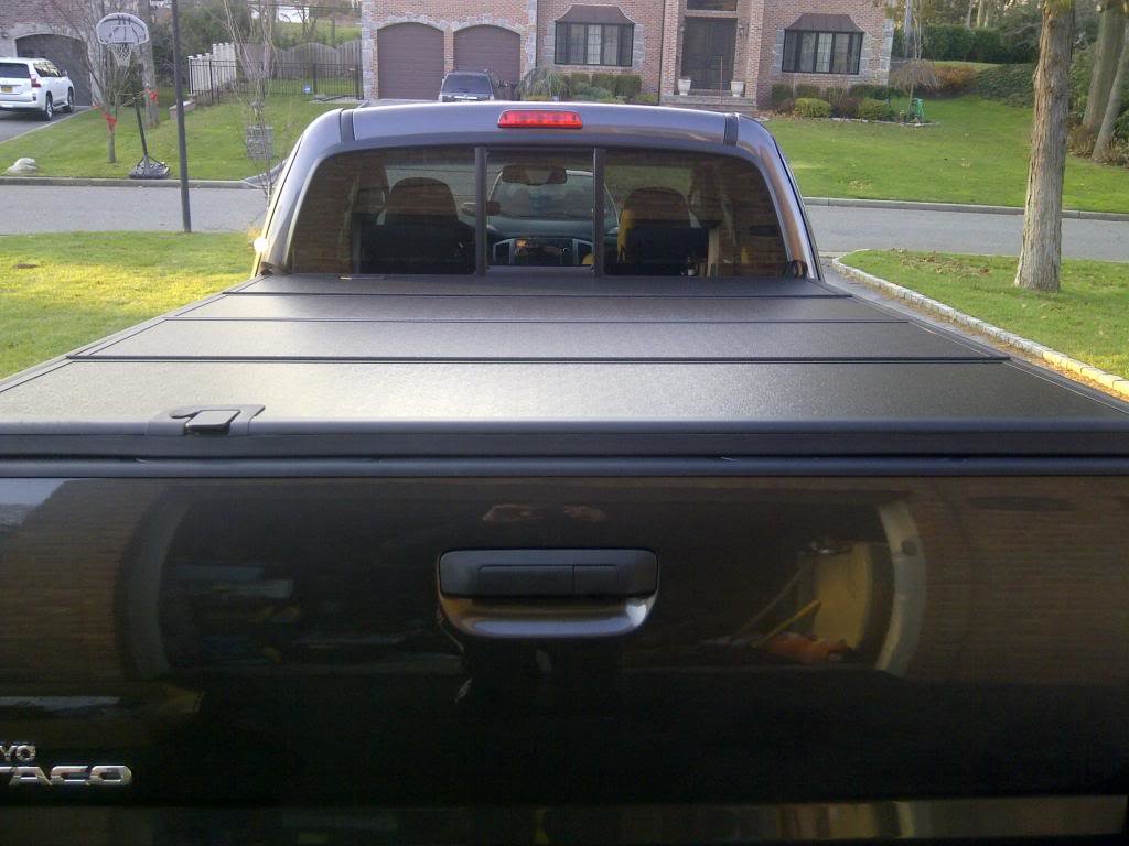

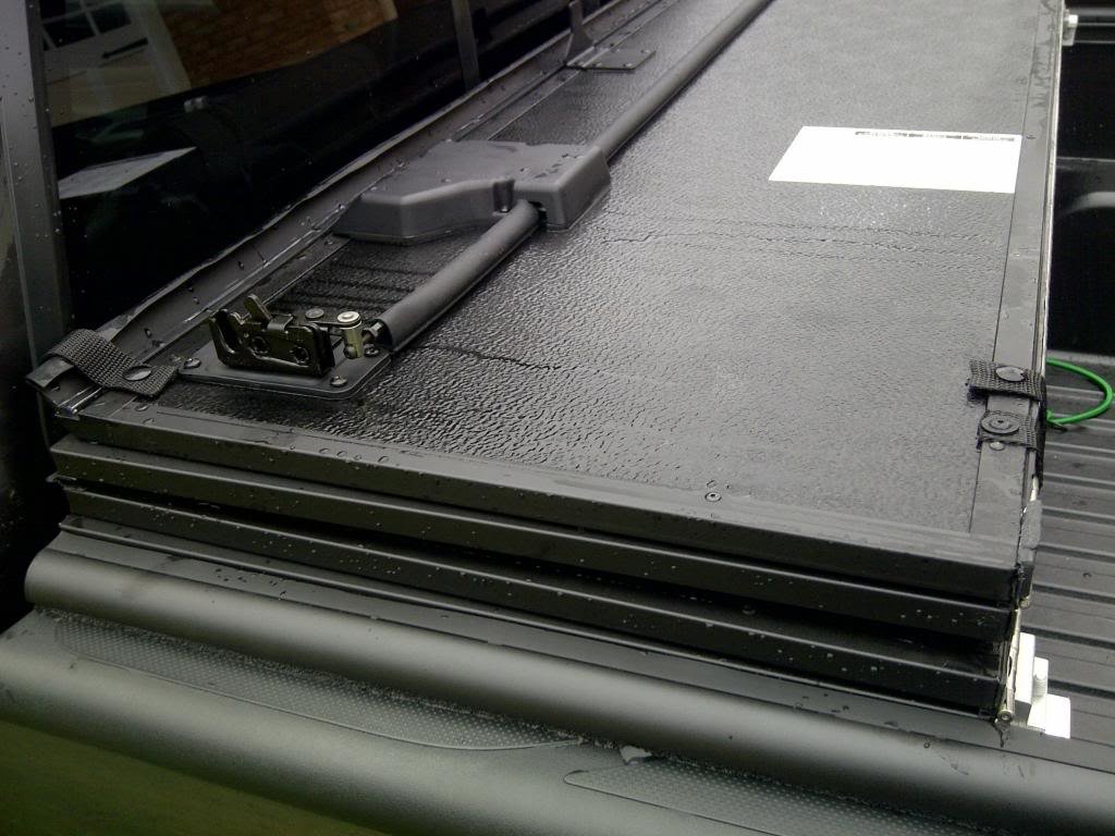

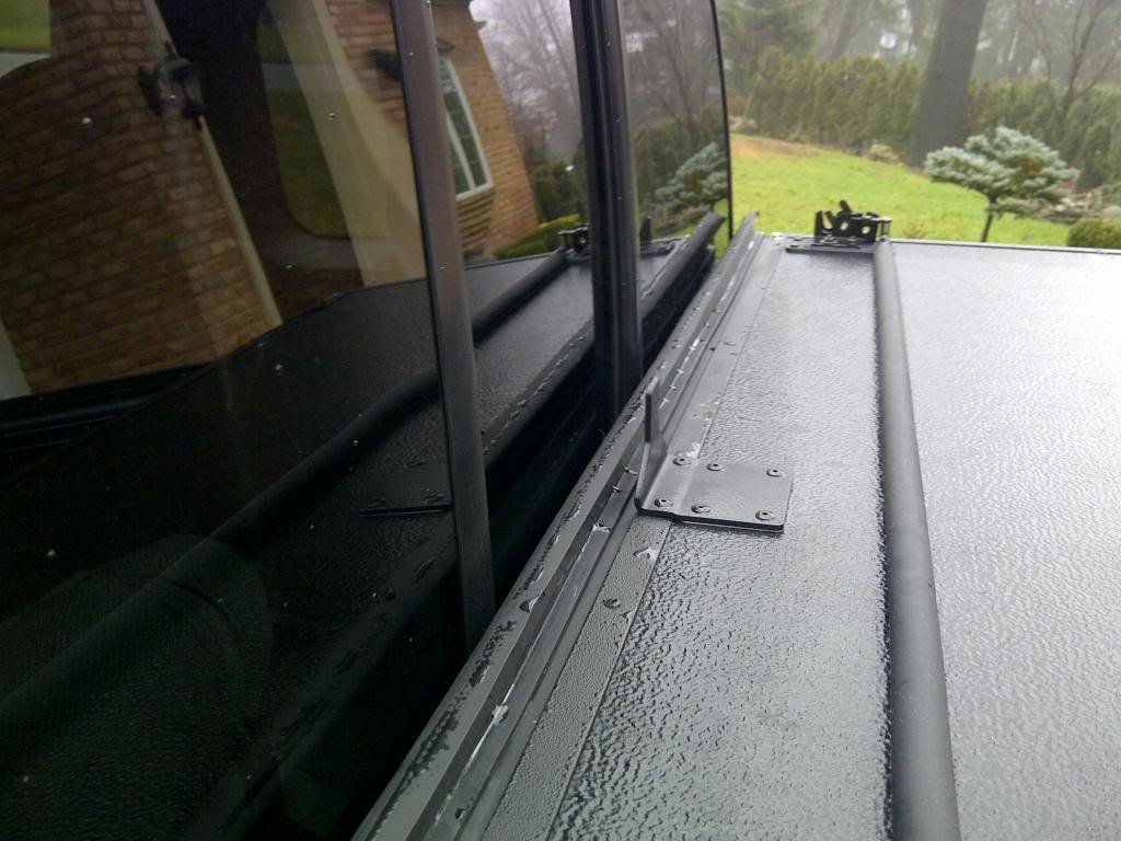

    Locking tab. The reason I bought this cover! Need to drill into tailgate to rivet the bracket, a little nerve racking drilling a brand new truck, my neighbor came running over asking what the hell I was doing but if you set everything in place you'll love how this thing locks... I pull the tailgate handle, hear the latch disengage but no movement at all, even tugging at it, it doesn't move. I had to adjust the bed cover a bit to get it to close and lock perfectly, too close and it'll hit or rub the tailgate, too far and you get play.

    Lock it up! there are two locks one front one rear. I found at a few instances I wanted to open the front cover from pass side and got pissed but not really a big deal, this or put it in the middle where no one can reach lol Also I carry two sets of keys, one for truck other for house and misc. Its nice it comes with two keys.

    Front Lock. I couldn't seem to get the cover to sit flush here but still sits on the weather stripping inside so no biggy. Also when installing they give two spacers to install between the front mounts and the rails at this location, I found it gave a gap between the bedliner and the rail so I removed them and the rails sit snug on the bed now.

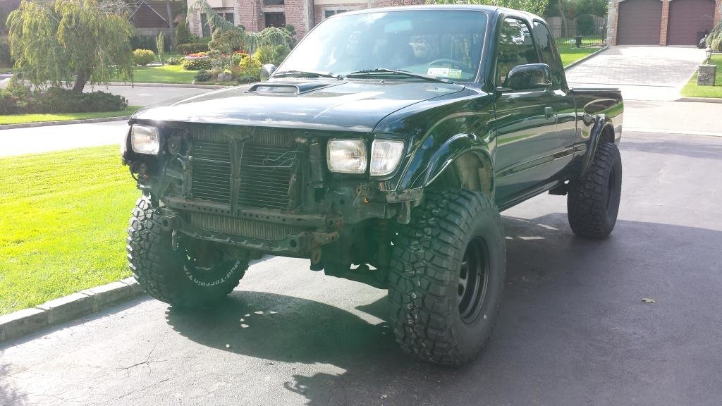

    Super Used 95.5 Taco

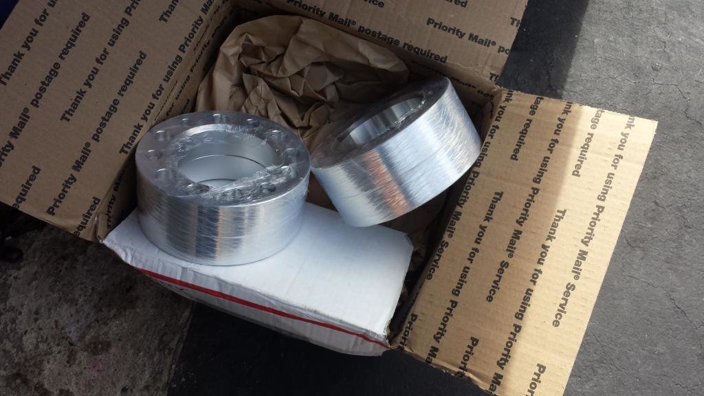

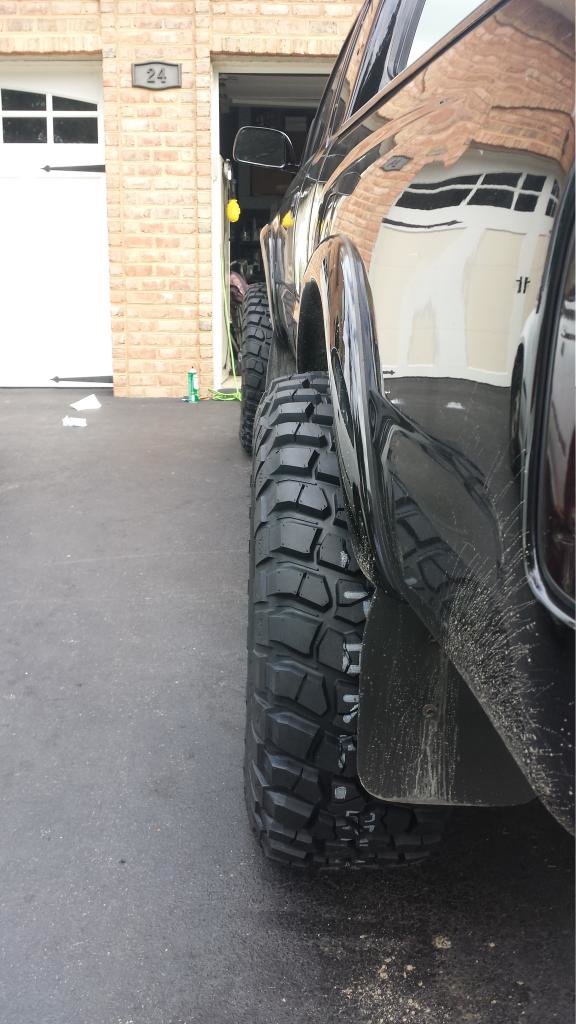

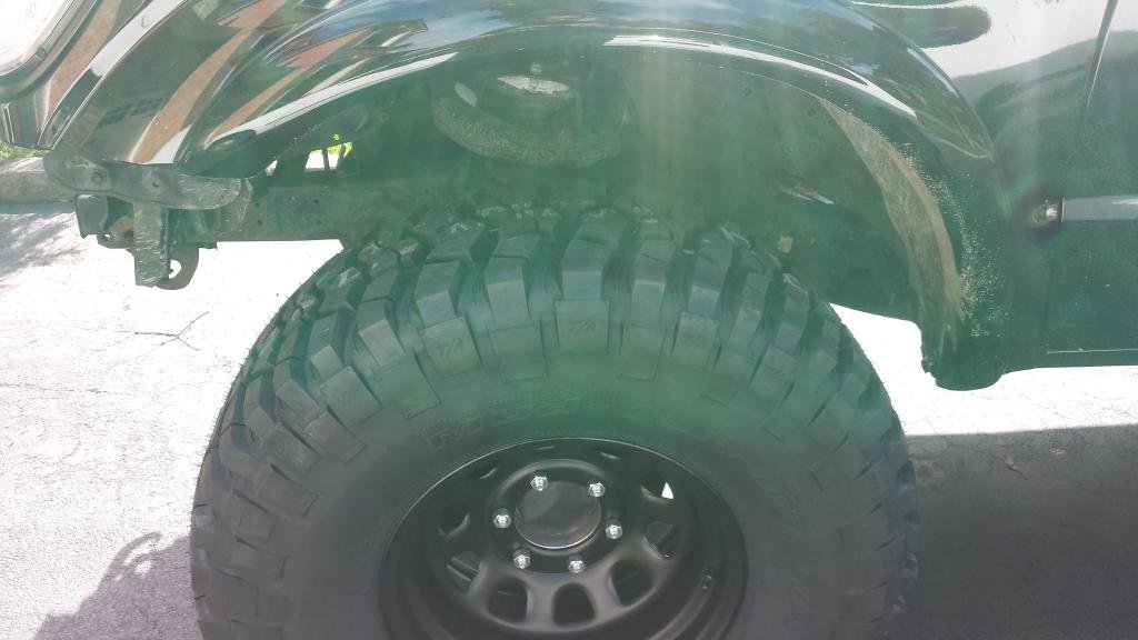

    selling rims and just installed these:

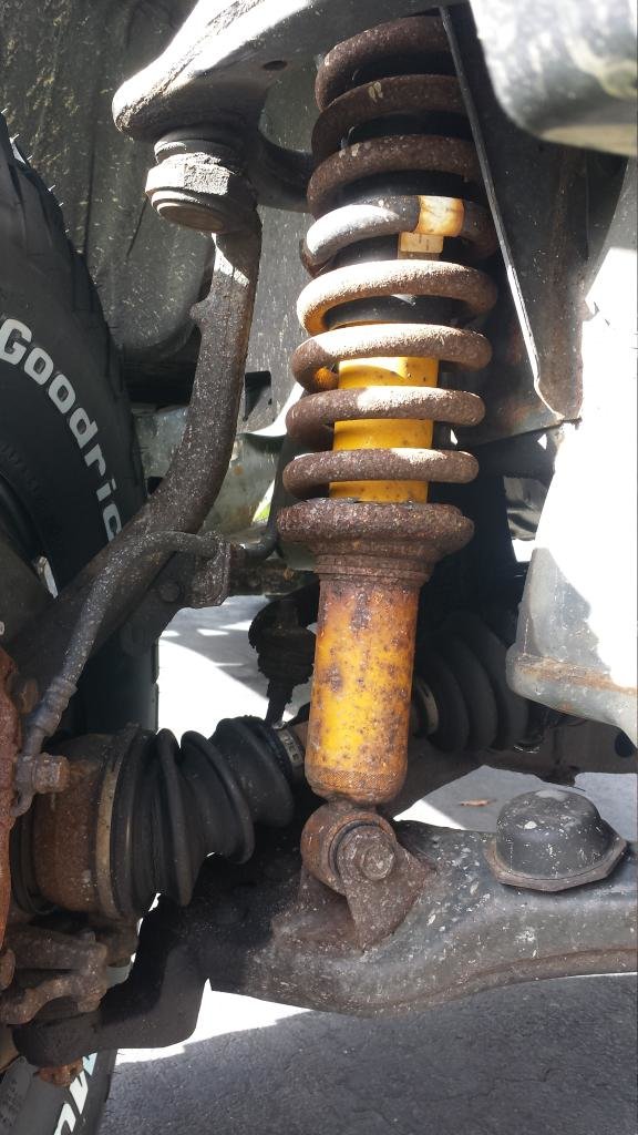

    currently sitting on nasty OME rusted suspension which will be gone soon also
    earlier today i realized i cant keep the stock bumper so this happened...
