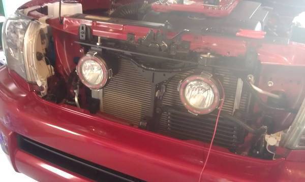

    I got my Kragen 7" HID fog lights in this week. I went to install them on my BDF behind the grille light bar and the passenger side was great. I am having touble on the driver side due to this extra radiator looking thing. The light will not fit at all. Anyone have a suggestion as to what I can do with this radiator thing or how I can get the light mounted?

    That thing is a transmision cooler I think. you could probably relocat it if the lines are long enough. Just be sure it still gets lots of airflow.

    I saw this as an issue before I bought so I went with the 4inch Kragens. :D Still had to relocate the horn though.

    the only thing you can do is relocate the transmission cooler there is alot of ppl on here that do it. me i just mounted my kragens on my sheet metal bumper

    dude just relocate that transmission cooler

    I installed 6" PIAA driving lights and I barely cleared the cooler. You can barely see the clearance on the bottom of the driver side light. I'm sure you can just relocate it cause I've seen other guys with bigger then 7" lights behind their grills.

    My 7" fit with the tranny cooler :)

    I got my pair of Kragen 7" HID Lights installed behind the grille it was a tight fit with that transmission cooler.
