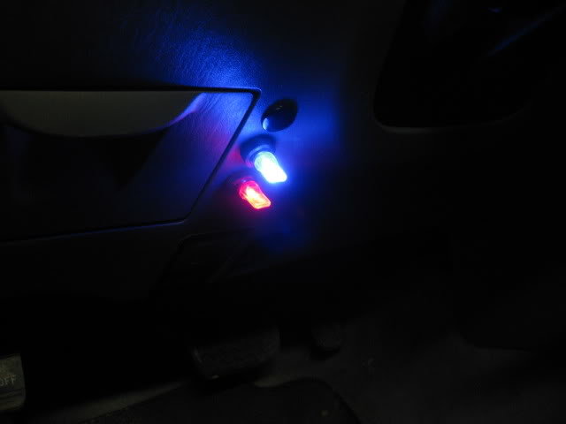

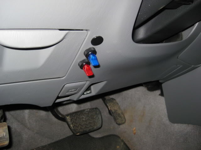

    A relay is so all the power to the lights doesn't need to run through the switch inside your cab. My Hella 4000 100 watt lights (2 = 200 watts) used a wire harness that included a relay. My Kragen HID 35 watt lights (2 = 70 watts) wire harness did not need a relay. I now have all 4 lights, and using the two seperate switches and one relay to the Hellas. Works perfect... Now that I had the Hellas converted to 35 watt HIDs, I am still using the relay wire harness.. still works the same.
    Blue= Kragen HID Euros (driving)
    Red= Hella HID Pencils (spots)
