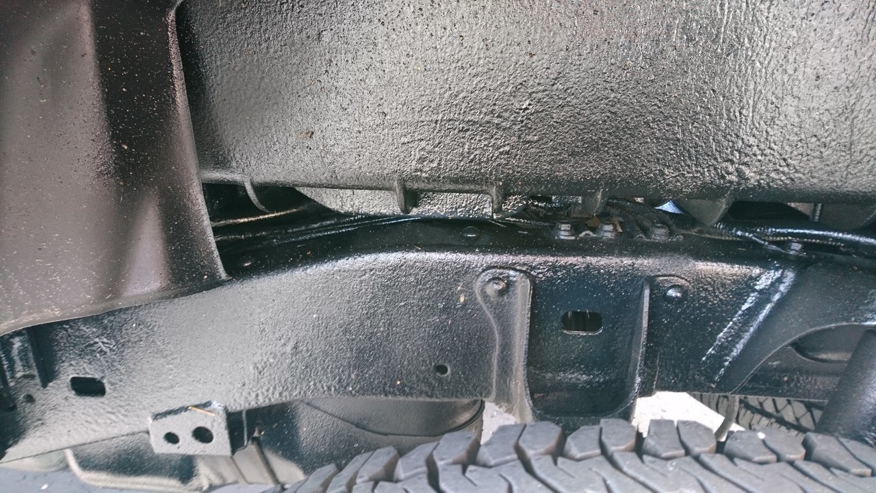

    My father and I both did this monday. This is my third year. I still had some covered/oily spots from last years treatment the day i got it retreated.

    This is my 3rd year also.....will post pictures in a few years to show how it is working.....so far so good....frame is still black. Usually in N.E. Pennsylvania after 7 or 8 years the Toyota frames look like shit so Toyota Frame + Pennsylvania's salty/briny roads will be a good test of Krown.

    I've had mine done at Line X of Cumberland County in Mechanicsburg the past 3 years and will be going again soon. They've done a good job each time. The truck will drip for a few days...I usually park on the street for 2 days afterwards but I've had it drip on my concrete drive and it disappears after awhile. The holes they drill look "factory" and are covered with black plastic grommets , I've pulled the grommets out and no rust. I've had no problems with any of the rubber door seals. You will have dirt/dust sticking to the fresh Krown on the frame...as far as I'm concerned its' another layer of protection against the salt. My price is $148/year I believe and stays at that price as long as you have the vehicle. Your truck will "smoke" for a short while when you are driving the truck home.....I have a 2 hour drive each way and when I'm leaving Mechanicsburg and come to a stop sign I get people looking at my truck because of the smoking....doesn't last long though.

    Took the Tacoma in for it's 4th Krown treatment today. The frame still looks good....black and no rust after 4 Pennsylvania winters. $148 per year to have it sprayed.
