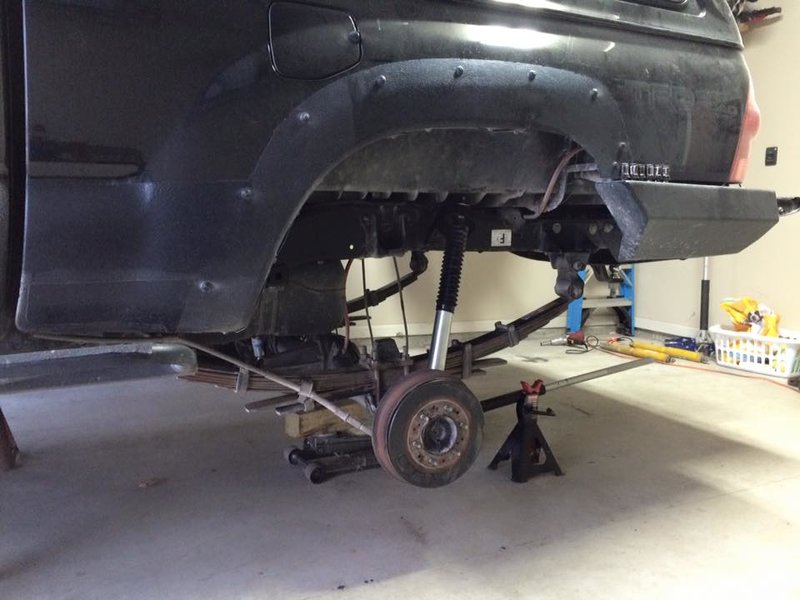

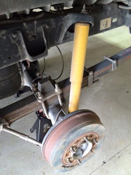

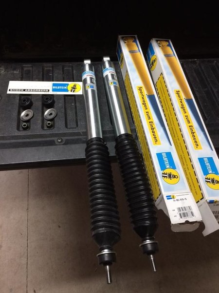

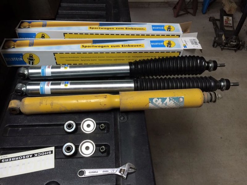

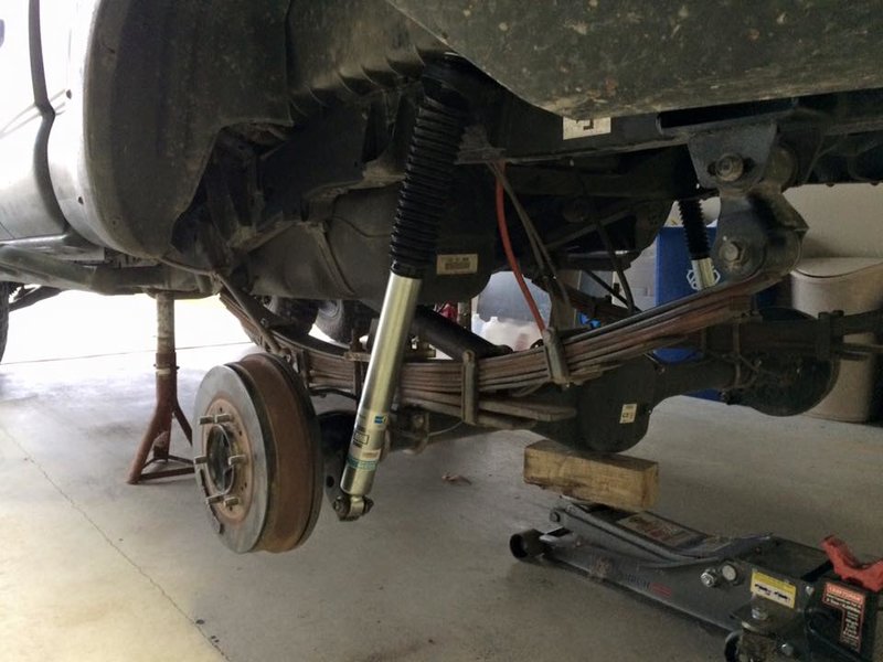

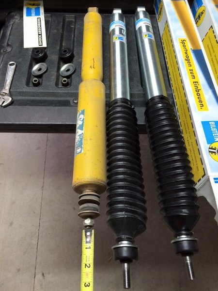

    Alrighty.... new suspension came in
    Front:
    Bilstein 5100
    OME 887
    All Pro UCA
    Rear:
    Bilstein 5100 Long Travel 16.34"-27.28" (BE5-B110-T5 X2)
    Dakar Leaf Pack with D29XL
    ATO shackle flip
    ATO stock length HD shackles
    Extended brake lines
    All Pro Ubolt flip
    Installed the rear today.....
    New rear shocks
    Old shocks
    With the weight of the truck on the leafs i disconnected the bottom of the rear shocks to see how much room i had for droop....... not much. Also took a while for it to extend. They are pretty blown up.
    New vs old....
    Installed the new shocks...
    I supported the truck from the frame to see how much droop i gained and also to check and make sure all of my lines were OK....
    The parking brake line is pretty taught at full droop. The center of the axle to the fender measures at 31" and it measures at 26.5" with the weight of the truck on the suspension. I need to figure out how to ensure that i won't bottom out. I need to flex it and take some measurements. I will be installing the rest tomorrow. Over all i am happy with the swap. I didn't realize how blown my shocks were. It is kind of bazar that they were in that bad of shape with only 35-40k miles on them. Do you guys think i should contact them for potential warranty or would that be a waste of my time?
