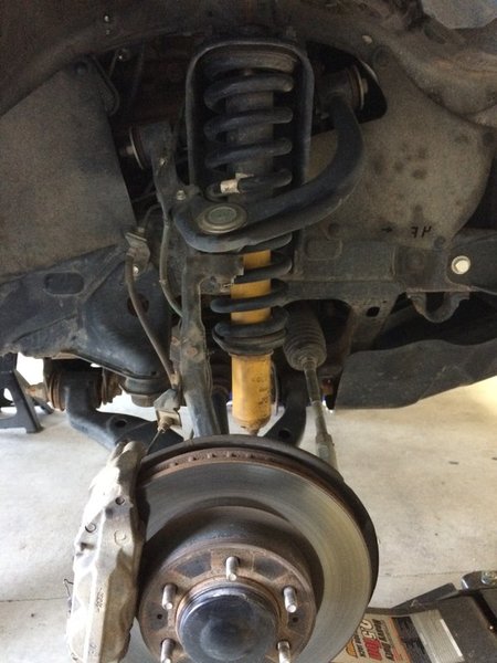

    None! The truck rides great dude. Bumps that used to jolt my front end i barely even feel any more. The caster is finally correct because of the UCAs. The 887s also ride much better than the 886s.
    I have the 79" awning. I wouldn't go any shorter for sure.

    Alignment looks good!
    ragincajun35[OP] likes this.

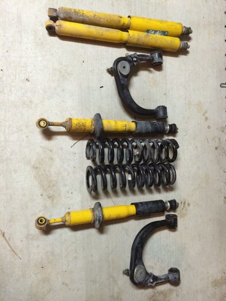

    so you switched to the 887 coils and they are softer?
    i thought the higher the number the stiffer they get
    what made you want to switch to billies? (nvm been reading more into your post and i see why)
    i think when i upgrade my suspension i will go with 885 coils and billies and ill probably set them at the second seat

    -I switched to the 887s which are the same length as the 886's but with a softer spring rate. They do ride better than the 886's with my setup. If i had a winch i may have stayed with the 886's
    -I went to the billies because they offer a long travel rear shock. I like all my stuff to match.
    I am very happy with the result. I am going to go a find something to flex up on today to test it all out.
    Base Camp likes this.

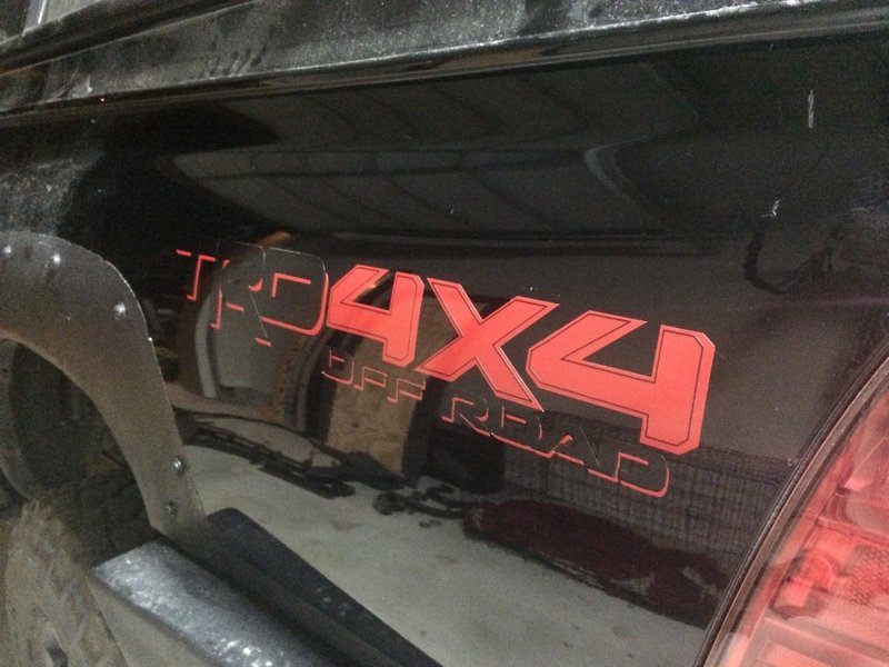

    Anyone know how to remove the TRD OFF-ROAD decals?
  15. Oct 19, 2015 at 4:58 PM
    #575
    99TacoDriver
    99TacoDriver Well-Known Member
    Jul 8, 2011
    #59531
    6,882
    South Louisiana
    OME 885x/5100s/LR UCA/3 leaf AAL/275/70/17 Terra Trac X-Venture
    the bedside decals?
    i just used a hair dryer and some adhesive remover then buffed and waxed the area
    be careful what adhesive remover you use though...goo gone is a good one
    NOT GOOF-OFF
    they have similar looks but that goof off will burn through the clear coat

    Removed the matte black decals with 3m stripe remover wheel. That thing worked like a charm. Put on the new decals. Not sure if I like them or not.... What do you guys think? I'll rock them for a while.
    NorthwestCruiser likes this.
  17. Oct 19, 2015 at 7:31 PM
    #577
    Dr. Cornwallis
    Dr. Cornwallis Well-Known Member
    Dec 27, 2011
    #69474
    388
    Flarrrrrrrida
    2016 Super White TRD Offroad 4x4 AC
    Idk part of me says they look pretty cool but the other part of me doesn't like aftermarket decals and stuff.

    I'm on 885s and a 3/8th spacer... Im already sagging with a hybrid bumper and skids.. with a Winch coming soon..
    Do you still need to get rid of the 886x coils??
  19. Oct 19, 2015 at 7:59 PM
    #579
    ragincajun35
    ragincajun35 [OP] Well-Known Member
    Jul 4, 2013
    #107595
    3,001
    Spencer
    Louisiana
    2015 DCSB MG TRD Offroad
    See Builds....
    They are sold sorry

    I think it's kinda cool, never seen these before
