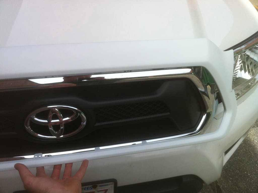

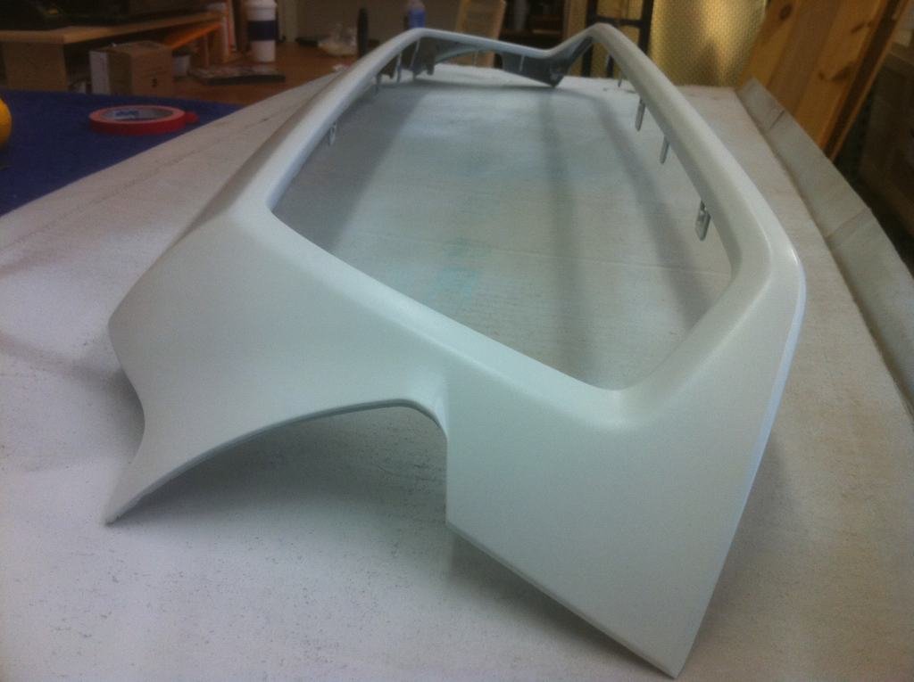

    Just rattlecanned a chrome grill surround with krylon fusion superwhite gloss... was going to go a different route but I figured I'd try it for $5 and repaint with colormatched paint and 2k clear if my results are bad
    First impression is that while the color is not exact, it's pretty damn acceptable and is not yellowy like people say about duplicilor white. Well see after some sun exposure
    My experience with paint is that rattlecan enamel shouldn't be cleared, it will be much easier to just scuff and touch up with another coat of paint as needed. The rattlecan clears can cause wrinkling in enamel paint, and are only marginally more protective than the hardener...Lacquer based would be a different story but I think I'll skip the clear for now.... Have any of you folks sprayed clear over white enamel paint with good results? I'm worried about yellowing on super white too
    I sanded with 120 then 220 on a random orbital, wiped with denatured alcohol, and sprayed 6 or 8 thin coats a few minutes apart in the shade, I used about 75% of a can but a lot of that was sprayed off the edges

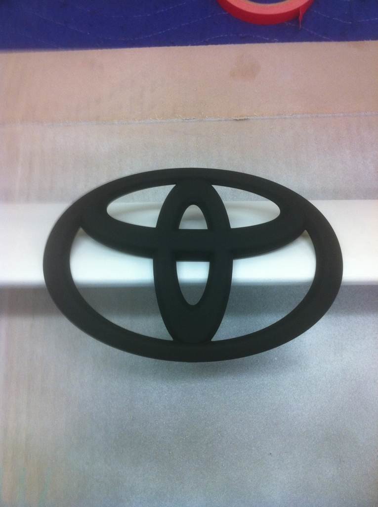

    I did the T logo with flat black high heat paint and baked it in the oven at 250 for a half hour, I will probably clear coat it later. I will use the high heat paint to black out behind the grill when I switch them out after a couple weeks when the white paint is fully cured

    Looks like it has a blue-ish tint to it compared to the rest of the truck. I'm thinking of painting mine black (black truck) but I'm using duplicolor color match.
    What did you use to prep the surface for the white paint?

    I simply sanded the chrome because I was using fusion which bites into the plastic pretty good on it's own.
    If you're using duplicolor or similar an adhesion promoter is a good idea as the paint can flake off of plastic pretty easy.
    The white is not a dead ringer, but it looks pretty good in real life, I'll post a pic in a couple weeks when I mount it
