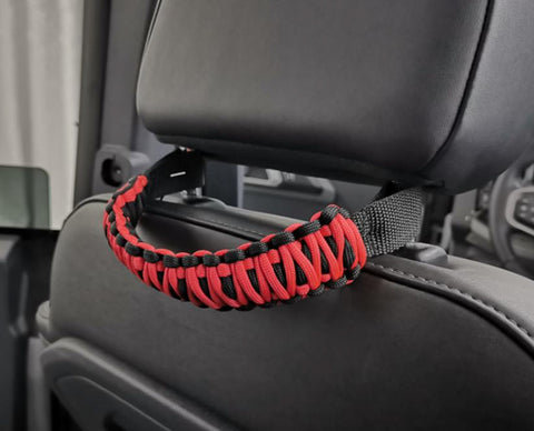

    I've never understood the obsession here with this questionable aftermarket driver's side grab handle (use the steering wheel - hello!). But I do concur a little assistance for the back seat riders might be nice. My solution was these parachord grab handles that slip on the headrest posts. Inexpensive, easy-peezy (and reversible) install, and they work and look great.

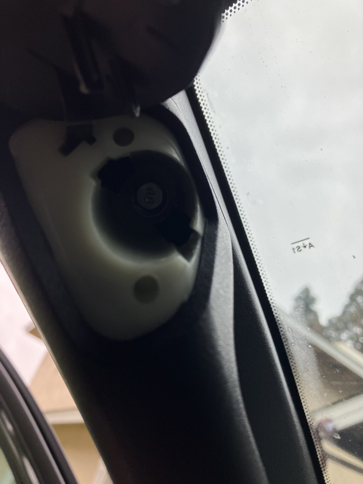

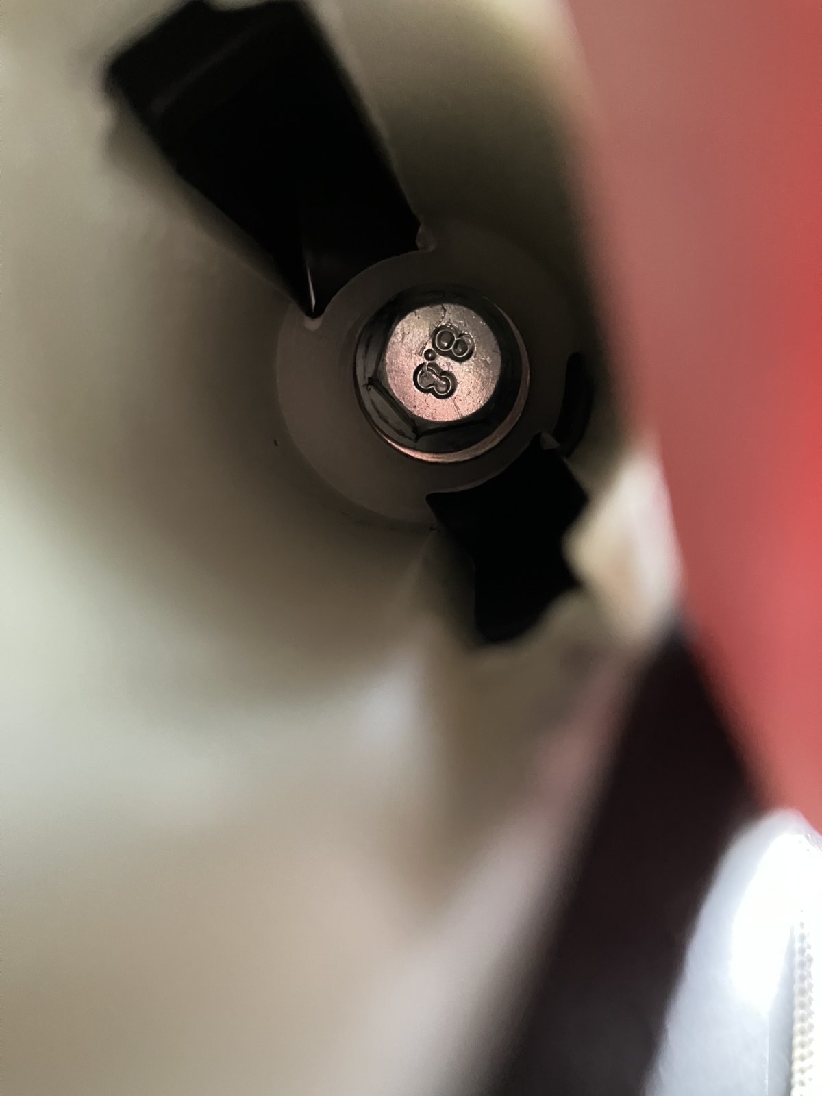

    I ended up trashing it and using a much more solid bolt I had in my parts bin combined with a couple washers and a nut instead. Assuming the rivnut works as intended (the kit only comes with one so if you mess up there's no spare), it still only utilizes a small screw head bolt that for me would never mount solidly in the rivnut to secure the handle, and because it used a screw head I couldn't torque it solidly enough to feel mounted.
    Unless there's any difference in the rest of the kit, I kind of wish i had gotten the discounted surplus V1 handles instead and saved a few bucks to end up at the same end point.
    I had the same issue with the rear handle mounting as the above one I described for the front handle, as no matter how I messed with the mounting setup the top mount bolt in the kit and rivnut is just too flimsy and doesn't mount securely enough. Unlike the front handle though, the top mount point for the rear handle is set in an open hole you can't access the backside of to replace the rivnut with a conventional bolt and washer, so the solution I came up with for the front A-pillar doesn't work on the B-pillars for the backseat handles. Since I can't return the handles because I took so long to try the install from when they were delivered, I may at some point eventually try to come up with something else to mount them but I'm not very optimistic.

    I’ll have to open the box up and see what hardware is for the top mount, if the handle will accept anything larger. I’ll just have to open the b pillar and dive in, take measurements of the hole and go from there I suppose.
